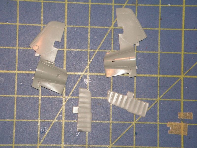

Some work was done on the tail, removing the nozzle as the S had no engine.
Problem is, the joint will be visible on the inside. I think I'll just plug up the whole thing with a FOD cover. Simple and plausible.

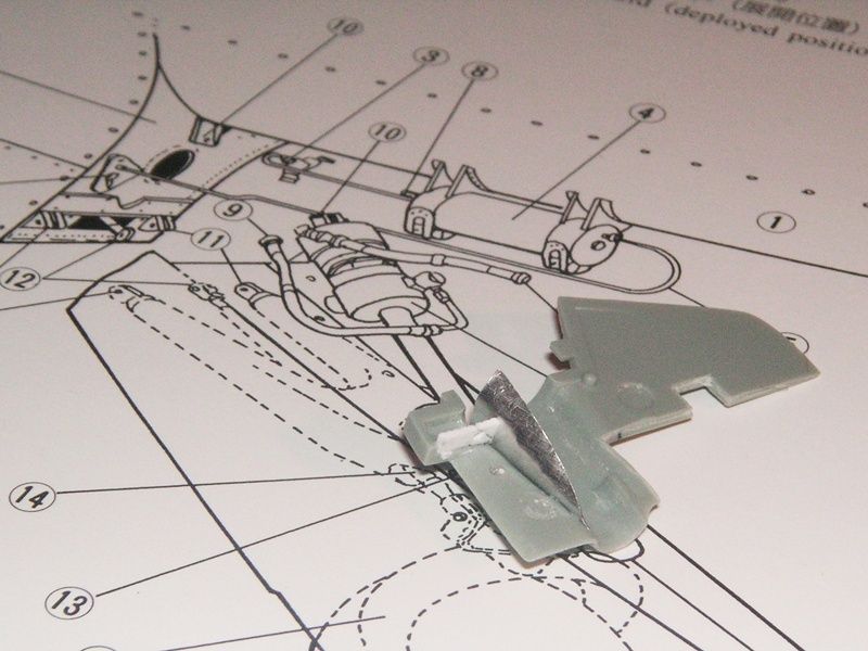

Next I cut out the rudder. Just couldn't resist... ;D

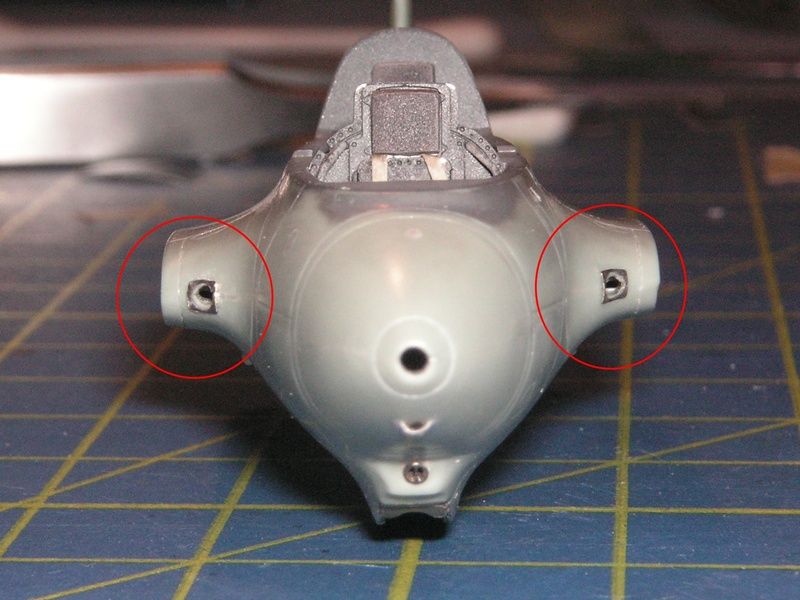

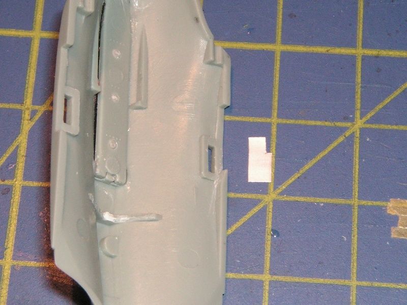

Before assembly of the fuse parts I covered the ejection ports from the inside (no weapons on the S either) with pieces of soda can. The aluminum finish will be left unpainted.

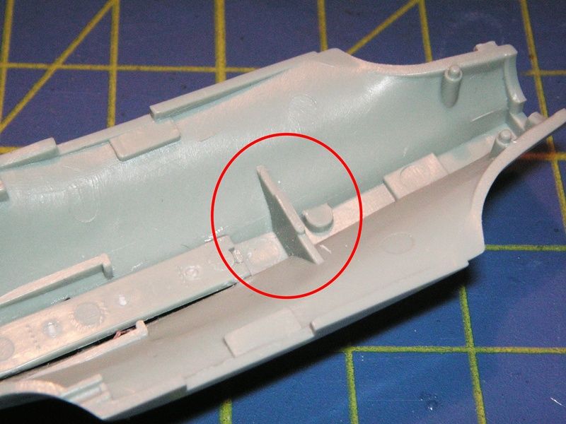

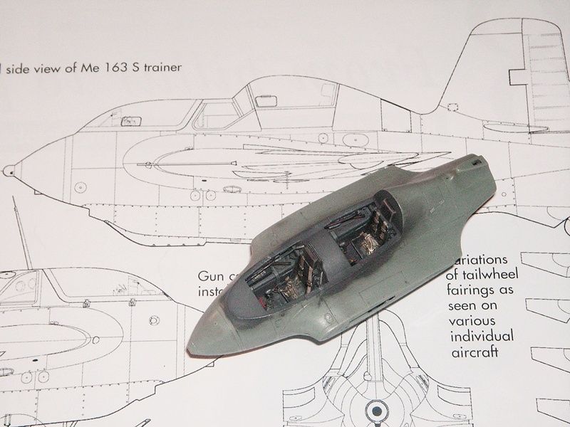

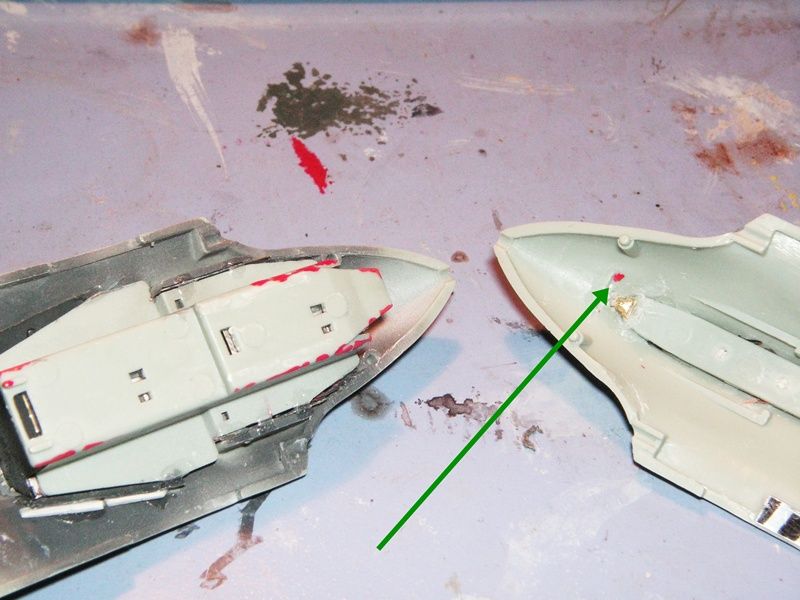

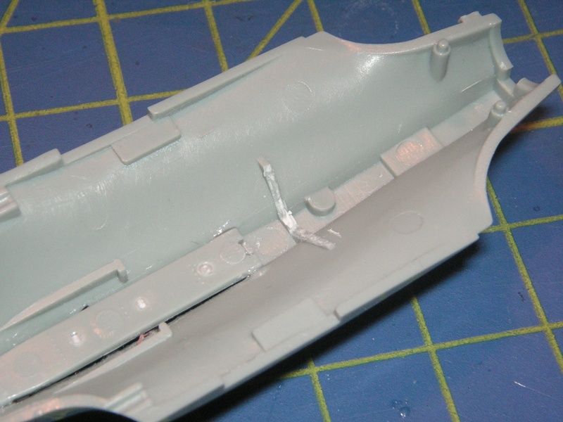

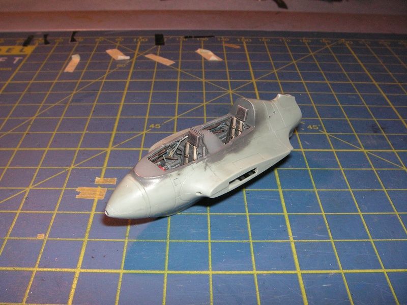

There are props for the tub in the lower fuse part but somehow the tub wouldn't fit, maybe because of the added PE, not sure. I made quick work of them.

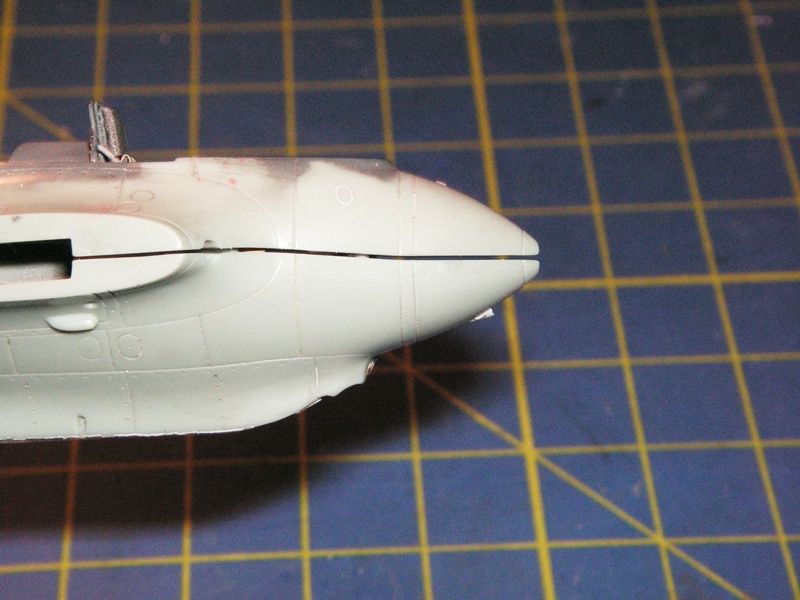

The fuse parts still woudln't join.

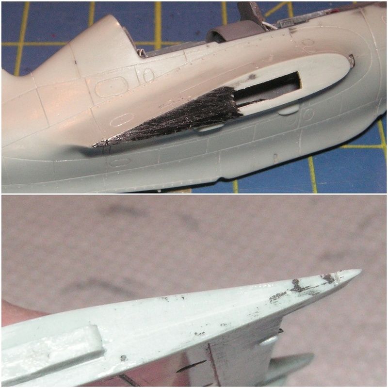

To pinpoint the trouble area I daubed some red paint onto the bottom of the tub and pressed the fuse parts together. Culprit caught in no time.
I got the fuse buttoned up after that with no more problem, just the tedious clean--up/re-scribing work.
That's where things stand.

Magic work as usual MichelC.  :thumbsup:
I like the use of 'Modeller's Red' to pinpoint the fouling areas, makes a change from the Real World's 'Engineer's Blue'.  ;D
Quote from: PR19_Kit on April 06, 2013, 05:14:24 AM
Yes one to remember.
Great work as usual  :thumbsup:

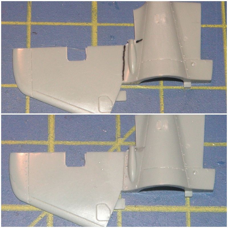

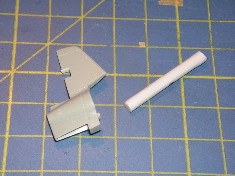

This Komet now has got a tail, although some work was needed to make that happen!

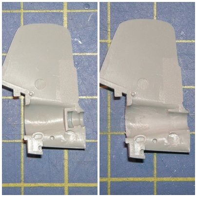

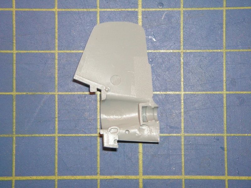

I removed the socket for the engine nozzle at the rear end of the fuse as the S didn't have an engine. However, I later realized that without the nozzle the seam on the inside will be visible. Hmm...we'll solve that later.

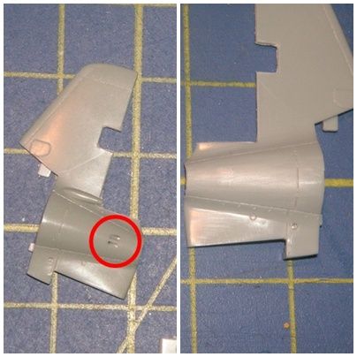

The small vents were not present on the S so I filled them with bits of styrene melted with Tam Extra Fluid, my preferred filler for larger gaps.
I re-scribed the missing panel lines.

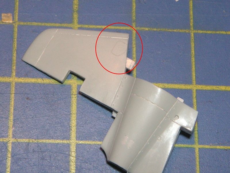

The small access panel was present only on the left side. The one on the right side was filled with CA.

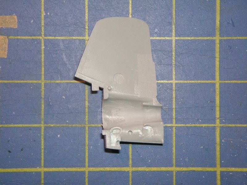

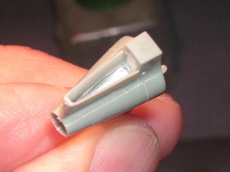

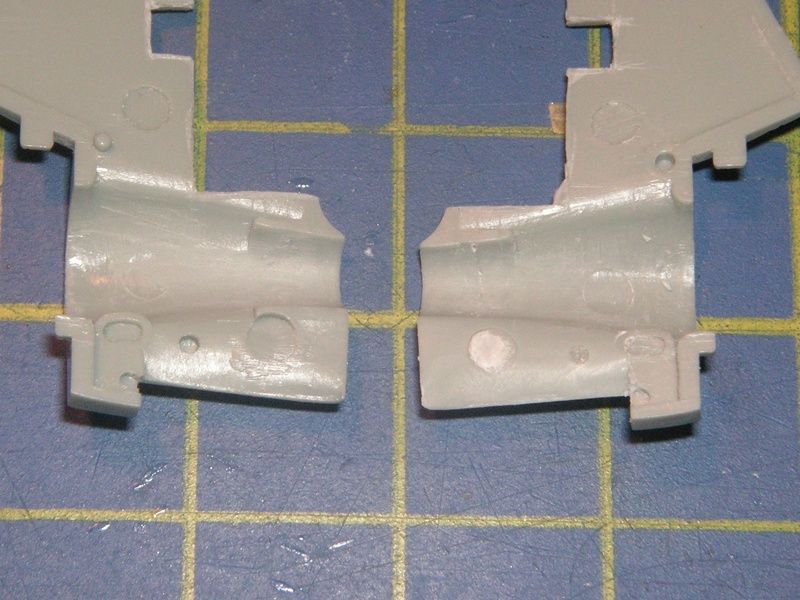

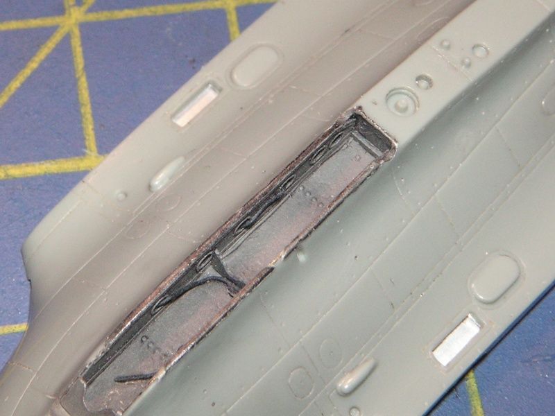

The inside was tackled next. I find tail wheel bays are usually neglected by manufacturers and this kit is no exception.
Ejector pin marks were filled with CA.
Some Evergreen and aluminum foil were used to make the inside of the well.

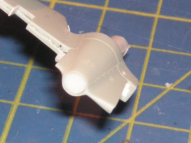

Once the tail parts were glued together I closed off the rear opening with a FOD cover made from a piece of sprue of the right diameter, cut straight and at a 90 degrees angle and fitted so it exactly matches the opening.
Although the fuse/tail joint is a complex one, all went well and only some filler was needed where the joint doesn't follow a panel line.

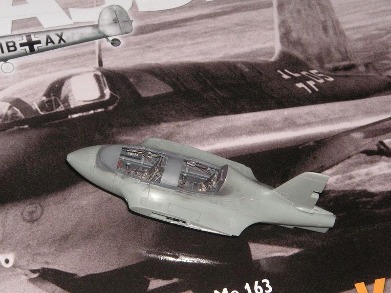

Here's the latest but first a pic of what I found in the mail box yesterday:
One more Komet book!  ;D

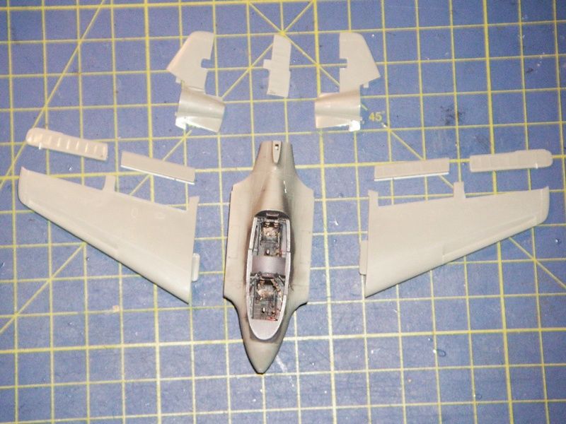

Before gluing the wings I added the small Eduard PE parts around the gun ports. Later I'll plug the holes as the S had no guns anyway.

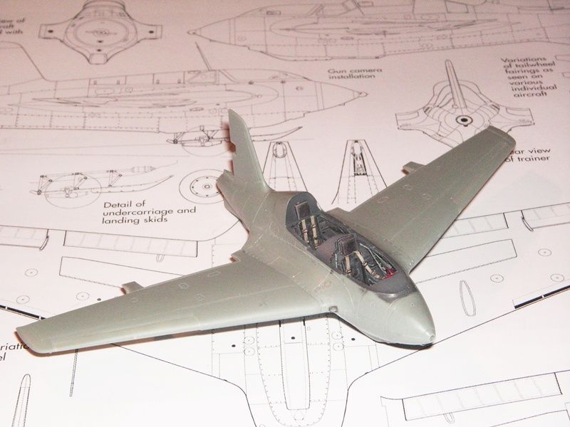

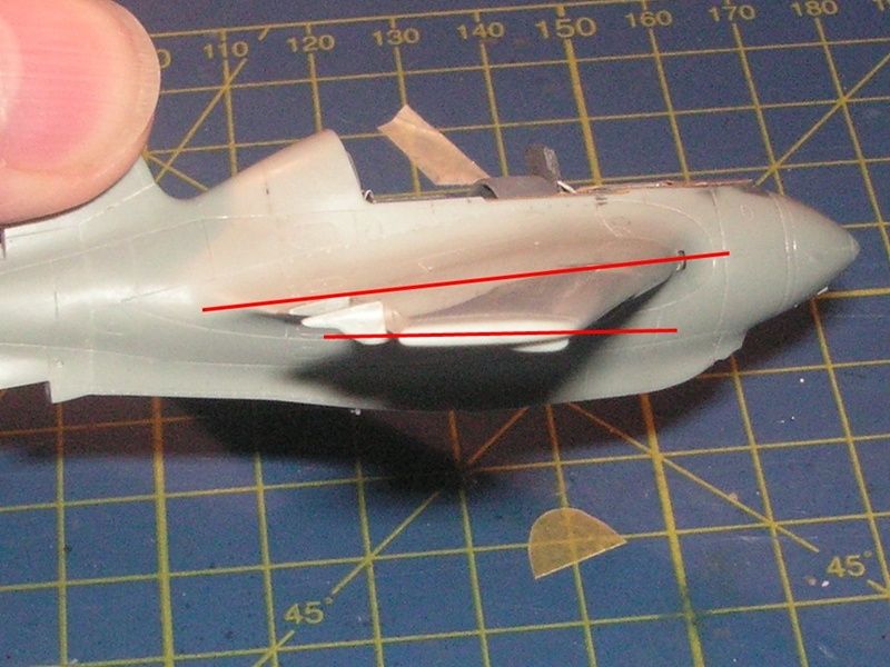

The wing/fuse joint is a pretty good fit, praise to Academy. To get it perfect I used the engineer's blue trick again (no red paint this time but a black felt pen). It worked so well that the seam almost disappeared in some areas and I had to re-scribe it!

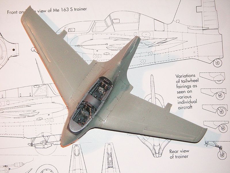

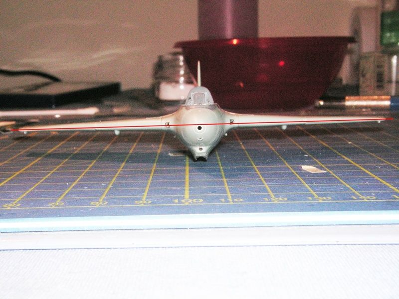

The next shot was taken not for your benefit but to verify the dihedral. Yep, looks pretty much like zero, which is right. (Lest you wonder: I verified before gluing!)
Besides a good fit of the wings Academy also did the wing's warp very well. Without it the tailless bird would have been unstable.

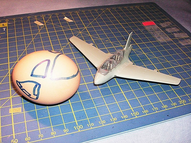

That's were things are at.
Easter's coming up in this part of the world. Time to paint the eggs!
