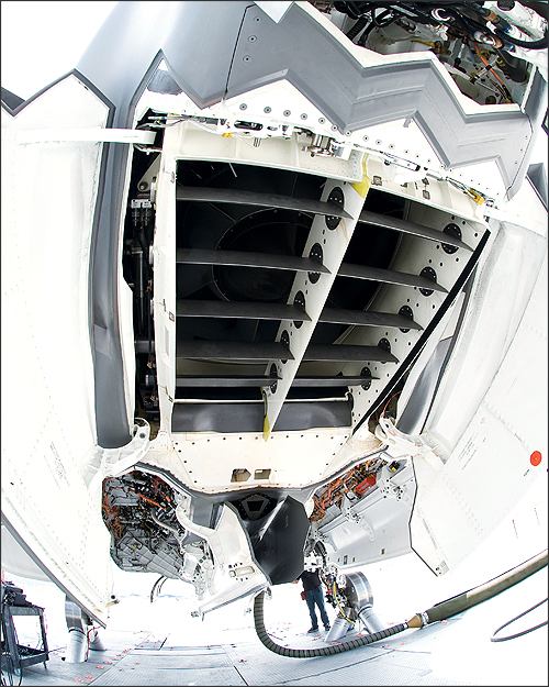

"For the F-35B pilot, converting from conventional to STOVL mode will be no more complicated than pushing a STOVL conversion button. The same button on a conventional takeoff and landing F-35 (an F-35A or F-35C) lowers the tail hook. "The button initiates a magical transformation," says J.D. McFarlan, who leads the F-35 air vehicle development team.
This transformation, as McFarlan describes, includes the opening of all STOVL doors and the propulsion system preparing to engage the clutch. Once all doors are open, the clutch is engaged when sets of carbon plates are pressed together to spin the lift fan up from a complete stop to engine speed. Once the speeds between lift fan and engine are matched, a mechanical lock is engaged to remove the torque load from the clutch and permit operation to full lift fan power. After the lock engages, the propulsion system completes conversion to STOVL mode and responds to aircraft commands. The entire sequence takes approximately fifteen seconds.
When a pilot gets to a slow speed during STOVL mode, the sidestick is used to move the plane up or down. When the pilot's hands are removed from the controls, the airplane simply hovers in place.
"The conversion button sets a lot of things in motion," says Graham Tomlinson, a BAE Systems F-35 test pilot who participated in early test runs on the hover pit. "But the complexity is in the airplane and the propulsion system. Converting to STOVL, which is fully automated, is a smooth transition for the pilot." "
"The lift fan is covered from above by an aft-hinged door, which opens as the aircraft transitions to hover mode. Thrust is controlled by the speed of the lift fan, a set of variable inlet guide vanes that reside above the rotating blades of the lift fan, and by a device called a variable area vane box nozzle on the lower side of the fan. The vane box nozzle (middle photo) contains a set of six vanes (or louvers) that direct and control the amount of downward thrust emanating from the lift fan."
--from http://www.codeonemagazine.com/f35_article.html?item_id=13
VAVBN controllability:
"The thrust produced by the Rolls-Royce LiftFan exits
via a Variable Area Vane Box Nozzle (VAVBN). When the
VAVBN is active, it modulates the LiftFan thrust
between 41.75° and 105° of vector."
(extract from Vertiflite Vol.55, No.2)
