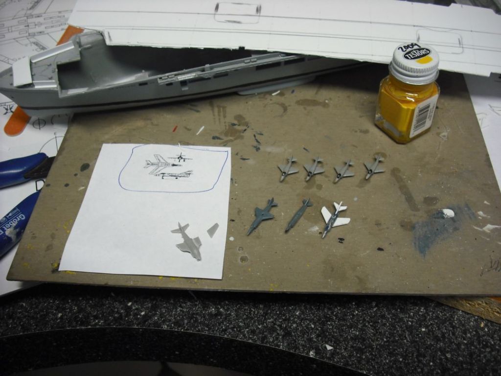

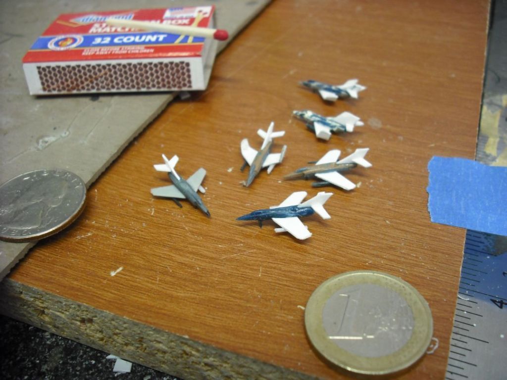

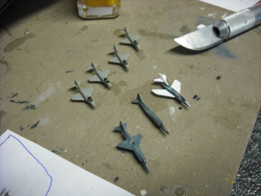

Work on the airwing has bugun- kit bashing in 1/700 scale.
Front row is the start of the Super Entendard assembly line.
A-4 Skyhawks in the next row.
Start with the Yak-38.
Take the wings off.
Chop the tail off.
A-6 Intruder outer wing panels serve as the template for the SuE wings.
Wings cut out off thin styrene.
Scratch tail and horizontal stab from thin styrene.
Will build around 6 Super Entendards.  A few Skyhawks and a straight wing trainer.
Dave "Sandiego89"
Chesapeake, Virginia, USA
sandiego89

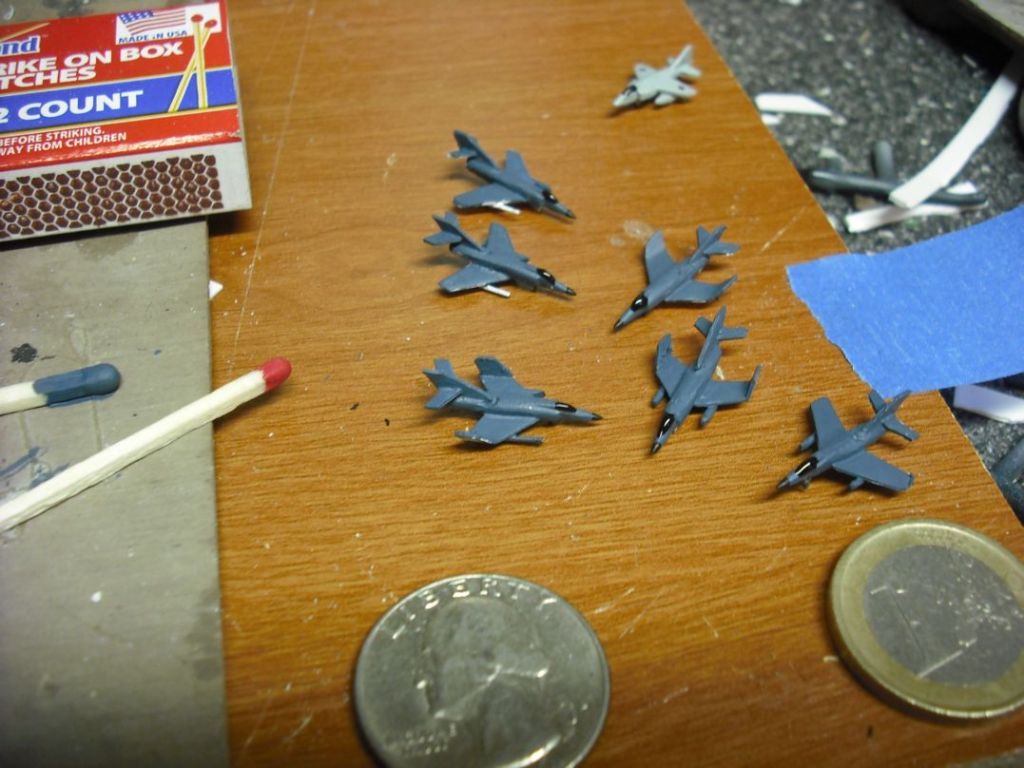

Super Entendards shaping up.  Still need a little cleanup and detail work.  Several armed with Exocet on the starboard wing. Each aircraft had 10 pieces.  Think I better get some magnyfying specs soon  :o

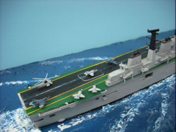

Catapult installed, a Mitchell Brown BS4 long stroke model with a 180 foot track.  Primer on the flight deck.  Unfinished SuE hooking up to the launch briddle.
Dave "Sandiego89"

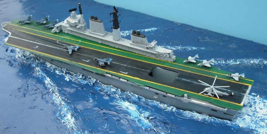

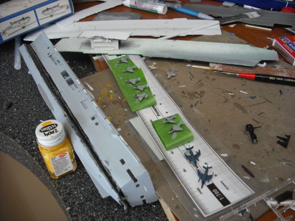

Made seme progres.  Decided to go waterline, so cut the hull with the dremel.  Made a partial aft hanger as seen near the top of the picture on the upside down flight deck, so the aft elevator can be displayed up or down.
Air wing painted.
Dave "Sandiego89"
Waterline is the only way to go. If you're going to go through all the trouble of making an active flight deck, the boat itself has to be active !

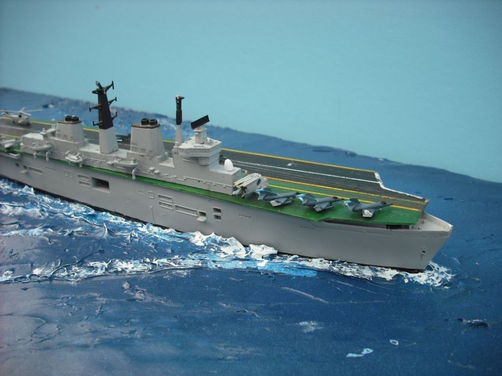

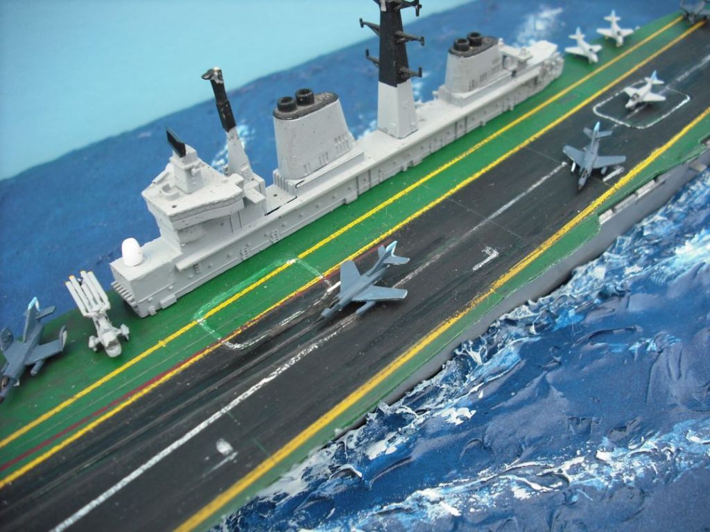

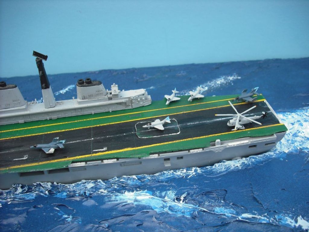

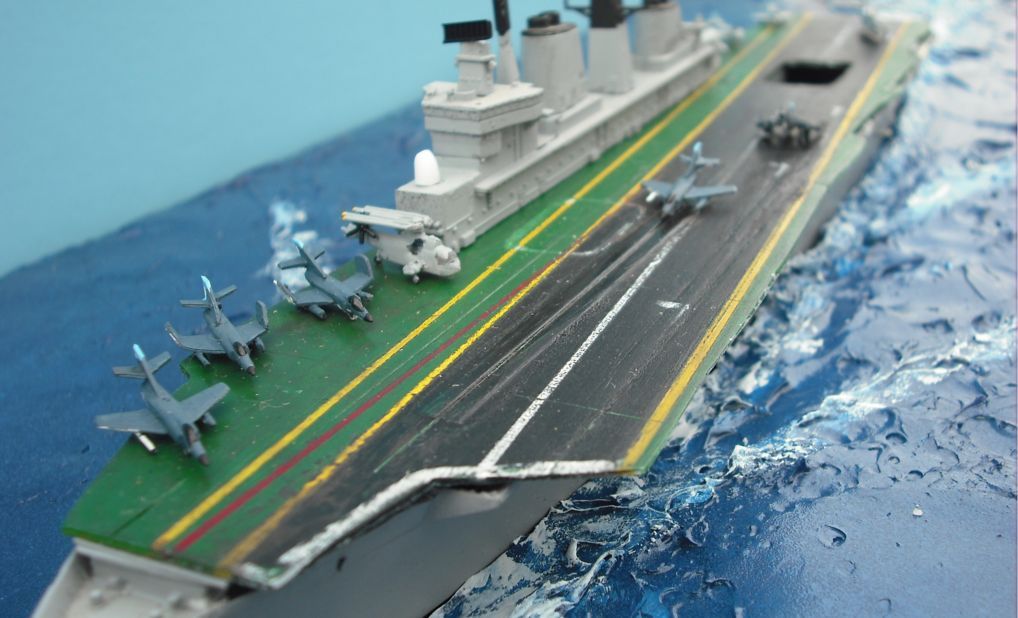

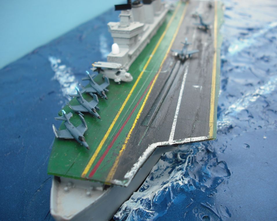

Completed.   The INDEPENDENCIA (V-2) turns into the wind to launch a pair of Exocet armed Super Entendards for a patrol near some disputed territory.
Back Story:
The scrapping plans for the ex-HMS INVINCIBLE at a Turkish scrap yard fell apart at the last minute due to financial problems and environmental pressure.  After bouncing around a few Mediteranean ports for a few months, a new deal was secured with an Asian scrap yard.  While being towed dead-ship in the South Atlantic a fire erupted aboard the tow vessel and the carrier was left adrift.  Disputes over costs and salvage plans came to nothing and some enterprising South American scrap merchants secured the vessel and were eventually given full salvage rights in a convoluted legal process.
The ship was rebuilt and converted as a conventional CATOABAR carrier (Catapult assisted take off but arrested recovery) as the INDEPENDENCIA V-2.  She has a single 180 foot stroke steam catapult powered by newly installed auxiliary boilers, and three cross deck arresting wires.  The normal air wing consists of 4 Super Entendards, 4 Skyhawks and 5 helos, but was highly dependent on the mission and could be augmented in times of high tension.  10-14 helos of various types would be carried in when operating in the commando role.
The kit: Dragon 1/700 Invincible.  New deck of styrene. Heavily weathered the deck.  Went with the green seen on some later Colosus carriers in South American service.
Display base. Sea and waves made of paintable caulk, sculpted and spray painted blue, with dry drushed white for the wakes/waves.
Air Wing:
1/700 S-3 Sea Kings, Trumpeter
1/700 Super Entendards. Aoshima Yak-38 fuselage, scratch wings, landing gear, tail and stores.  10 pieces each!
1/720 A-4 Skyhawks, old Revell kit.
Underway, launching SuE's
Elevator in the raised postion bringing a Skyhawk up from the hanger deck.
