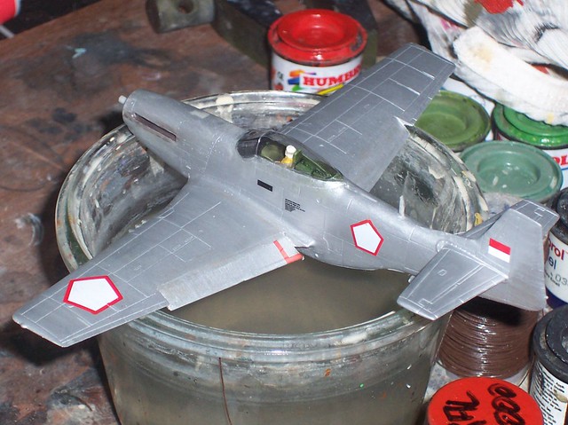

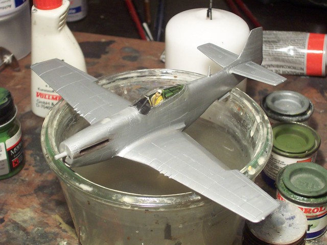

The model's lower sides were painted with 'Polished Aluminum' Metallizer from Testors. The upper surfaces, which would later be concealed by camouflage, were painted with acrylic paint, 'Aluminum' from Revell. The same color was also used for some contrast panels on the lower surfaces. Onto this basic finish, the decals were applied as a next step.
AURI F-319 appears to have had its cammo scheme painted around its original markings and some access hatches, and simulating this would be IMHO achieved the easiest way by simply duplicating the process on the kit!
1:72 North American P-51D Mustang; 'F-319' (ex 44-13045); 3 Skuadron, Angatan Udara Republik Indonesia (AURI); probably Padang Air Field, mid 1958, during CIA operation "Haik" - WiP by dizzyfugu, on Flickr

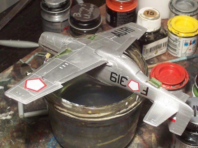

The decals themselves were puzzled together from several aftermarket sheets. The AURI insignia/national markings come from a generic TL Modellbau sheet, the tactical code and the "AURI" letters under the wing were cut and re-arranged from "USAF" letters in 1:72 scale. Improvisation rules, and the frugal modeler.

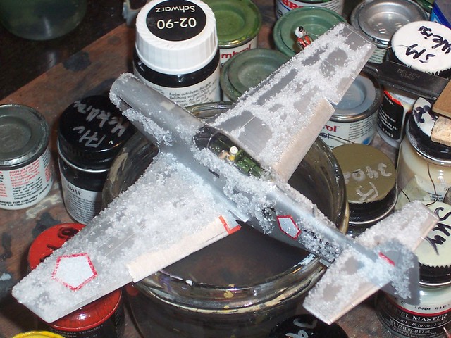

After the decals had been applied and secured under a thin coat of clear, acryllic varnish, I used water and salt to mask panel lines and leading edges with tiny mottles and irregular "spot clusters". It's actually a method that works well when you simulate rust and flaking paint on 1:35 tanks and such with an air brush, but I thought that it might also work here, too, since I wanted to let a lot of bare metal shine through the rather thin cammo paint.

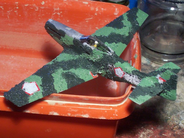

After having thoroughly dried, the camouflage scheme was applied with a broad but flat, soft brush, with slightly thinned enamel paint and only with gentle strokes. An air brush would have been better suited, not to stir the masks on the metal paint below, but on the other side a brush allows a more tattered, uneven look, enhancing the flaked and worn effect and the realism of the finish.
The basic camouflage colors are Humbrol 120 (FS 34227, Light Green) and Humbrol 91 (Black Green). They create a good contrast - but BW pictures are hard to interprete.

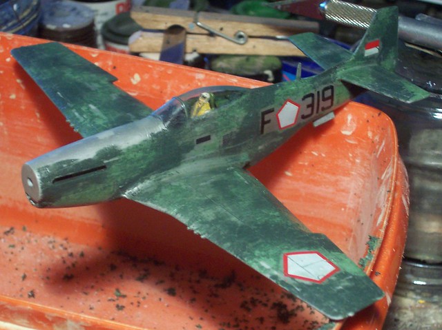

After this basic cammo paint had dried up, the salt masks were rubbed away, supported by hard brushes and even fine sand paper. Surely, some repair and additions had to be made, e .g. around the insignia and the tactical codes. In some areas, the chipping effect was enhanced with some dry brushing, e .g. with Humbrol 78, 75, and 116. A wash with thin black ink was applied in order to emphasize the kit's engraved panel lines and the many surface details.

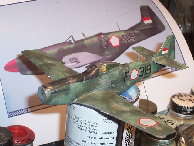

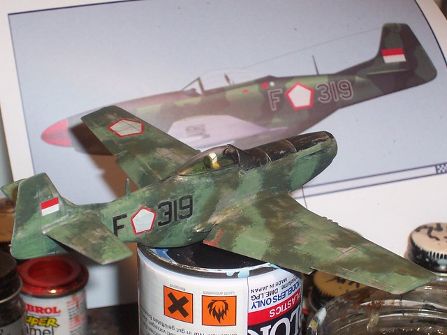

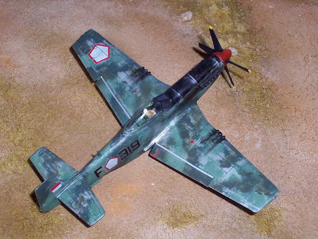

Finally, everything was sealed under clear varnish – the lower sides with an acrylic Tamiya spray varnish, the upper sides with a matt coat. On top of that, some overall dry painting with olive drab and medium grey was done, and exhaust and soot stains around the guns added through dry painting.
1:72 North American P-51D Mustang; 'F-319' (ex 44-13045); 3 Skuadron, Angatan Udara Republik Indonesia (AURI); probably Padang Air Field, mid 1958, during CIA operation "Haik" by dizzyfugu, on Flickr
To sum it up, a small real-life project of a classic aircraft in a rather exotic, non-fancy but pretty challenging livery – it was more work than one might expect at first glance, esp. with brushes. An airbrush might be the better choice to applay paint, on the other side, the enamels created a unique effect this way. Improvised and tattered looks are bigger challenges than "fresh from the factory" finishes.
