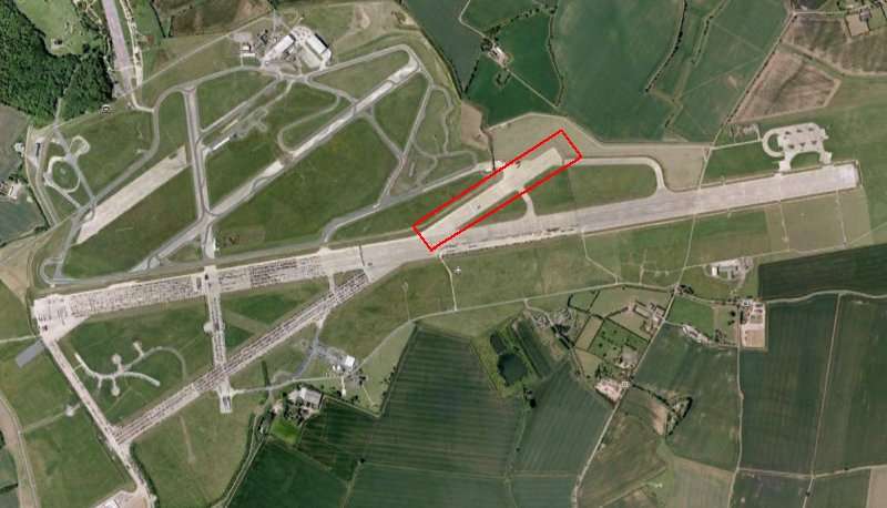

I've just remembered another story from John Farley's 'A View from the Hover' about landing a Vulcan in a short distance.
He was doing some demonstration flights for a very overbearing Government official and decided to do a 'max performance' landing by using the Vulcan's massive aerodynamic braking ability to stop REALLY short. He dutifully did this, using the brake 'chute as well, and brought the aircraft to a halt BEFORE they reached the runway intersection on RAE Bedford's short 23 runway, which was very asymmetric anyway.
This piccie, gleaned from Google Earth, shows the part he landed on outlined in red. From other information about RAE Bedford I reckon that bit is less than 2000 ft long!
