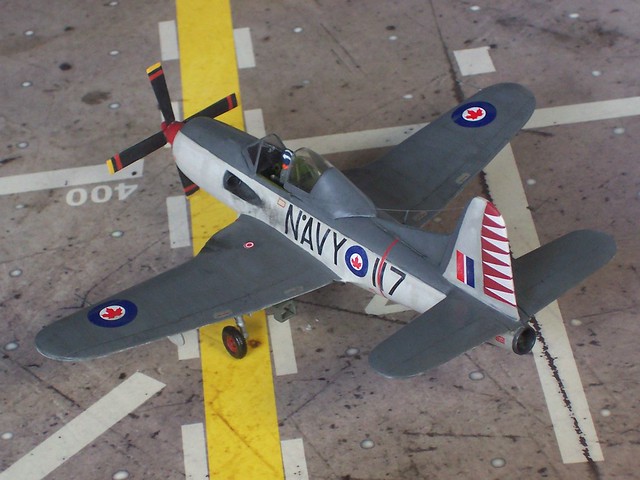

Ryan F2R 'Dark Shark'; aircraft "117" of VF 870 , Royal Canadian Navy, 1951
Started by Dizzyfugu, March 04, 2013, 12:42:10 AM

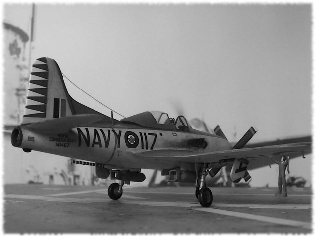

1:72 Ryan F2R 'Dark Shark'; aircraft "117/Bu. No. 141467" of VF 870 Squadron, Royal Canadian Navy/RCN, HMCS Magnificent, early 1951 (Whif/MPM kit) by dizzyfugu, on Flickr

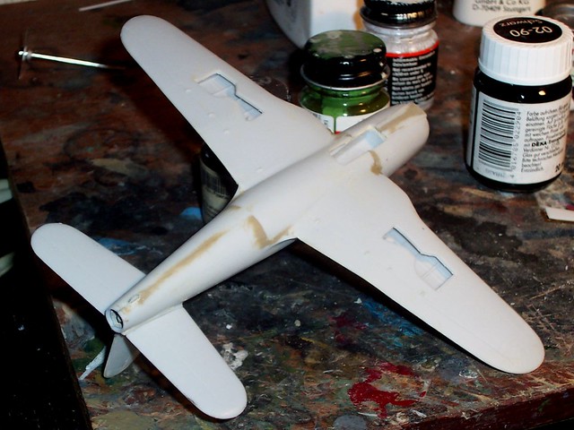

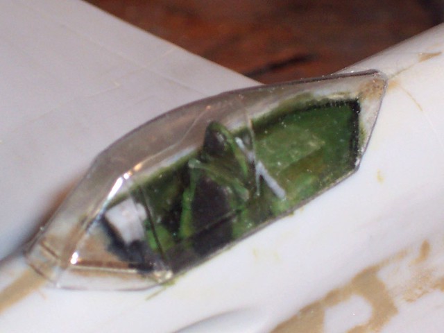

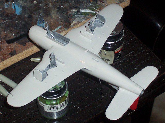

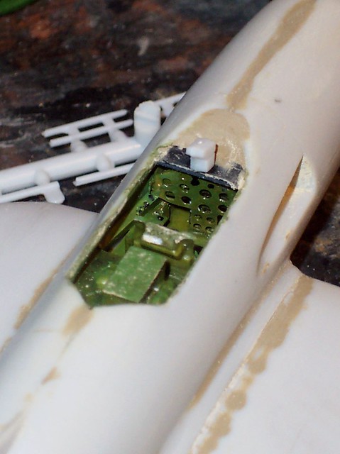

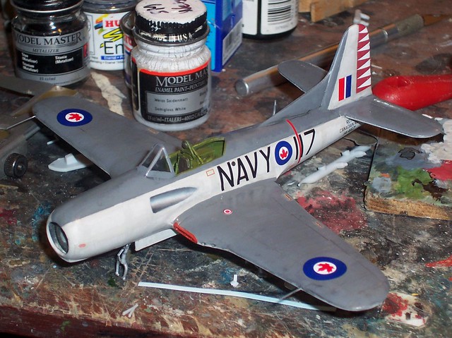

As to be expected from a limited run kit like this, fit is rather so-so. Being honest: it's pretty poor. Surface detail quality is low, just some panel engravings can be made out. Lots of flash, some sinkholes (in the wheels) and in parts even a grainy surface finish.
The kit came with photo-etched parts, but this does IMHO not help, it's like a placebo. My kit also came with a vacu canopy, AFAIK there are also versions with injected canopies and without the photo-etched parts for cockpit and landing gear around.
1:72 Ryan F2R 'Dark Shark'; aircraft "117/Bu. No. 141467" of VF 870 Squadron, Royal Canadian Navy/RCN, HMCS Magnificent, early 1951 (Whif/MPM kit) - WiP by dizzyfugu, on Flickr

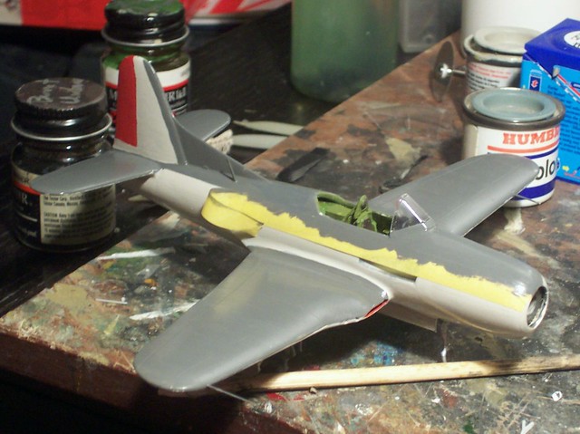

Anyway, beware: this is only something for those who can and want to invest some time and effort into the building process. Nothing really fits: the fuselage halves are uneven, by about 1mm. The wing part with the front wheel bay has been constructed in such a complicated fashion that you only get it right when you (theoretically) fit everything together at the same time, but you will need four hands to accomplish this feat... At least the nose section offers enough room to store a bid pile of lead, so that this tail-sitter kit actually stand on its three wheels.

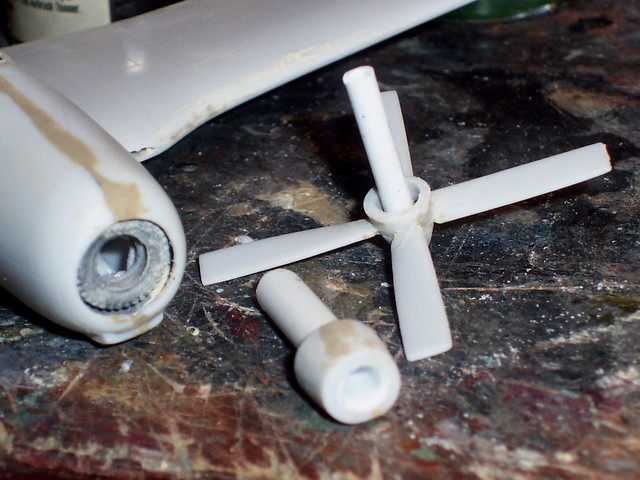

The propeller and the long nose are ridicolous, concerning the sprue attachment, the fit of the parts(?) and the fact that the construction only allows a fixed mounting. It's appaling - I was close to constructing the whole nose from scrathc, but finally built a scratch mount from styrene tubes and a wheel from a 1:76 WWII lorry.

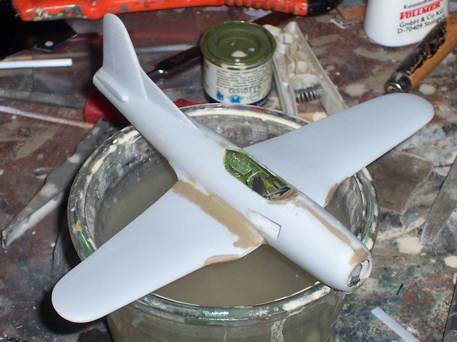

But there's more to worry: the air intakes in the wing roots also have such a weird construction that you have three parts intersecting - with the poor overall fit it is IMHO impossible to achieve a sound shape, at least without lots of putty, sculpting and sanding.
Additionally, the intersection between the upper wings and the fuselage seems not to belong to the same kit - it took serious shaving and putty in order to achieve a decent transition between these large parts. This kit is nothing for beginners and IMHO totally overprized, at least when you buy it under normal circumstances. Huah!

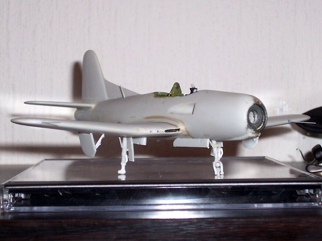

Consequently, I used some scratch and replacement parts in my kit, e. g. totally new wheels and some other landing gear parts. I also added two WWII style GP bombs (probably from vintage Revell P-40's) under the inner wings - the original kit only offers the empty hardpoints. A jet pilot figure was added, too, as well as a better arrester hook.
The only argument that is pro MPM kit is the fact that it is the only 1:72 Dark Shark around. Be warned!

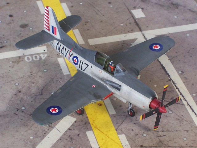

Another whif with a rather simple and - at first glance - familiar livery. But this one is unique: the Canadian Navy had its own colors. The upper grey of early RCN aircraft was called Dark Grey 1-9 (later 501-102, maybe FS 16099), very similar to NATO Extra Dark Sea Grey (e .g. Humbrol 123), and the lower sides were painted in a light grey instead of Sky, with the code 1-13 (later 501-106). The exact tones are under expert debate, though, literature makes controversial recommendations. For instance, the lower side grey is supposed to be FS 16314 (Glossy Flint Grey), and while the tone matches IMHO well, it is much too dark.
Anyway, I rather followed personal taste and impressions, inspired by pictures of real life RCN Banshees. I used simple Humbrol 79 (Dark Blue Grey, similar to German RAL 7012 Basaltgrau) for upper sides and Light Aircraft Grey (Humbrol 166) for the lower sides and fuselage flanks - the latter turned out to be a bit too pale, though, but I kept it since it is different enough from Sky.
This basic livery was combined with decals from Xtradecal's Sea Fury sheet X720074 and pimped with some colourful trim typical for RCN's 870th Squadron/VF 870, e .g. the red propeller boss and the red and white fin decoration.
The latter was improvised: the rudder was painted with Humbrol 153 (Insignia Red) and the white wedges were cut manually from white 3mm stripe decals from a TL Modellbau aftermarket sheet. Tedious task, but IMHO worthwhile because this was much cleaner than trying do this delicate task with paint and brush alone.

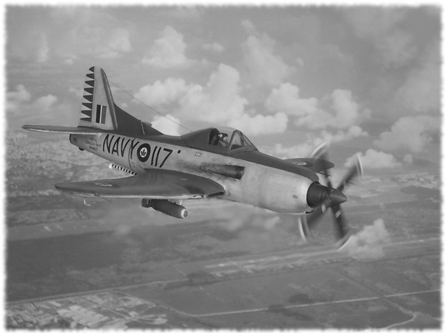

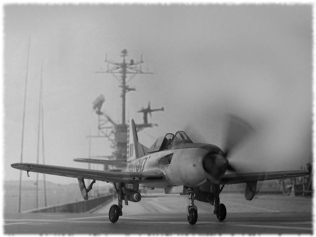

A simple aircraft, but a challenge to build. IMHO the slender Dark Shark looks very good in RCN colors, and the high waterline underlines the aircraft's clean lines. Hope you like it, too, and with best regards to fellow FlickR user Franclab in Canada. ^^
