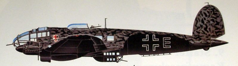

Cheers Guy. Kinda knew a lot about that already and while I said black scheme, I didn`t entirely mean all overall black.
More kinda like this....  ;D
Tiger, Tiger!
Gotcha! :thumbsup:
That'd go great! ;D
Guy
I suppose that if the aircraft took of from Europe in the late afternoon, just before dusk it would have the cover of night for the whole trip to America.
Look at either the He 177s from KG100 during Steinbock in '44 or the schemes worn by the Ju290s of KG200 in '45.
"Visit Scarfolk today!"
The Plan:
That He111 scheme is what I had in mind for my bomber n fighter escort....or possibly one of the late war Ju88/Me110 night fighter schemes.....really can't wait to see it finished...!!

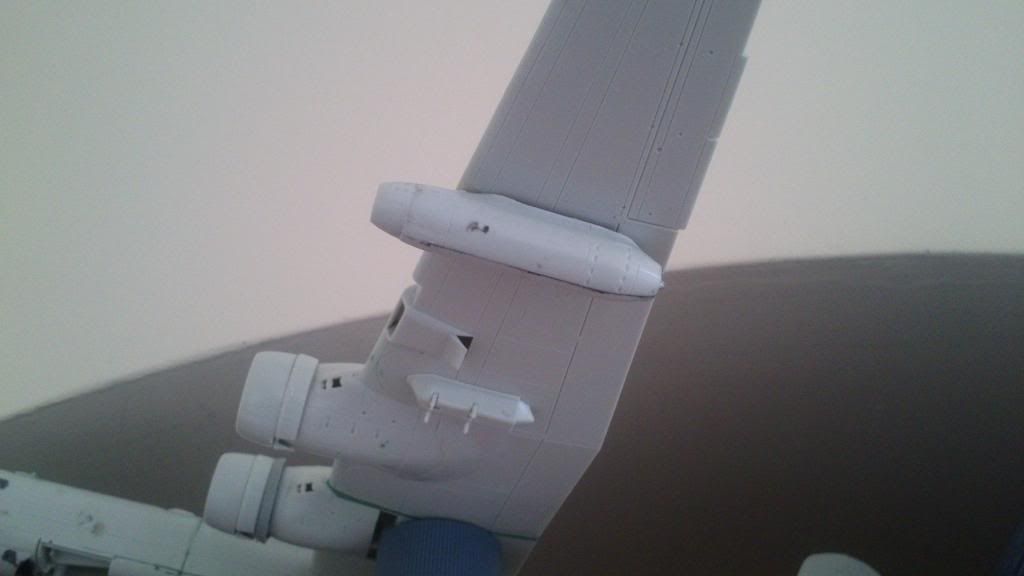

Anyway, today`s small update.
Jumo engines and bomb pylon/rack now attached. Will mask off shortly and then break out the filler.
Tiger, Tiger!

Possible slight problem depending on how "accurate" you want to be. The rear of your Jet Engine mounting overlaps the hinge line for the flaps. Perhaps you should move the outer end of the flaps inwards so that the hot exhaust from the jet engines doesn't burn a hole in the flaps when they are deployed. You have more flap area anyway from the increased wing span so losing a few feet Meters from their ends wont matter.
What about filling in the engraved panel lies behind the jet exhaust and scribe slightly shorter ones that end either side of it......?
dumaniac
i fear Gondor is correct - I think the idea of hanging the jet under the normal nacelle was to create clearance from the flaps - so there are a couple of options - you might move the jumo rearwards and scribe the flaps accordingly (like on the 262) - you might hang the jumo via a small pylon from its current position  - or you might glue it under the outboard nacelle - or as has been suggested, re-scribe the flags to create the illusion of a non moving bit immediately above the exhaust

Ok..., thats weird. Are you stalking me or something...  :lol:  Just spent last night and this morning looking into and dealing with that very issue.
