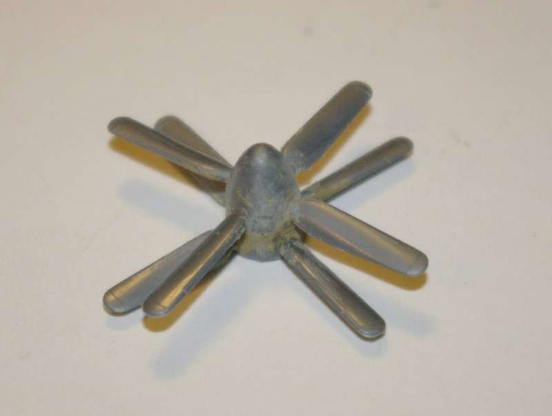

I got fed up with PSR-ing the long wing, I've been sanding for DAYS it seems, so I did something else for the Tri-Stang.
Because the two outer engines rotate opposite to each other to minimise the torque reaction it makes no sense for the centre engine to go one way or the other, and the obvious answer is a contra-prop. Unfortunately it seems that no-one made a contra-prop for a P-51, let alone a P-82 so no-one has made a model of one either. (Yeah, yeah, I know, some wise-guy will now come up with a pic of a racing Mustang with a contra-prop, but models of same are damned hard to come by!)
So having LOTS of spare props on this project I made one, or tried to anyway. I cut the nose off the spinner of one spare prop and filed it as flat as I could, then glued another prop, but the opposite hand, on top of it. Of course the joint was anything BUT smooth as the rear spinner tapered quite a bit so it needed a fair amount of putty, but getting it into the tiny space round the blades was NO fun. Sanding or filing it down afterward was even worse, and it'll need lots more PSR sessions I'm sure, but here it is as far as it goes.

2nd phase of the prop has been done today. It had me searching out my narrowest needle files to get down between the blades, and then I gave it all a coat of Mr. Surfacer 500 (doesn't that stuff smell weird?) which just revealed that I'll need at least ANOTHER PSR stage.  :banghead:
I've also been sanding down the main assembly, and sanding and sanding and sanding...........  :-\
With hindsight (the world's only exact science....) I should have PSR'd each of the three fuselages separately before I assembled them. As it is, trying to do anything on the centre fuse is a nightmare, my sanding block is too large to fit through the gap! I'm going to borrow some of Mrs_PR19's nail sanding sticks when she gets back, she has about a zillion of them so hopefully won't miss one or two.  ;)

I've FINALLY finished the contra-prop, and a right pain it was too. It very nearly got slung out the window a couple of times, but then I thought that it HAD to be done as no other prop made any sense for the centre engine.
I had maybe 4-5 PSR sessions on the spinner joint during which two of the rear prop blades broke off but I managed to get them superglued back on OK. Then I primed it and did two MORE PSR sessions, and then I decided I might as well paint it as I'd got that far. And after that I thought I'd apply the SIXTEEN prop blade decals and finish the thing off. Applying the decals to the rear prop blades was a right fiddle, but I managed it.

You should have heard the barrage of swear words while I was trying to apply those decals. The inner ones on the rear blades were underneath the front blades of course as I'd not set the props up at 45 deg to each other in the interests of 'realism'.  :banghead:
Dumb or what?
