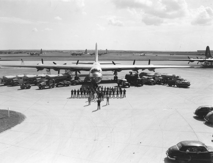

I remember reading that the B-36 (which did not do A2A refueling) had a capacity for something like a 1,200 gallons of OIL.  Basically, you needed a tanker truck full of lubricating oil for the engines for every flight.  We're not even talking fuel, which was an altogether different scale (nearly 20 times that amount).
