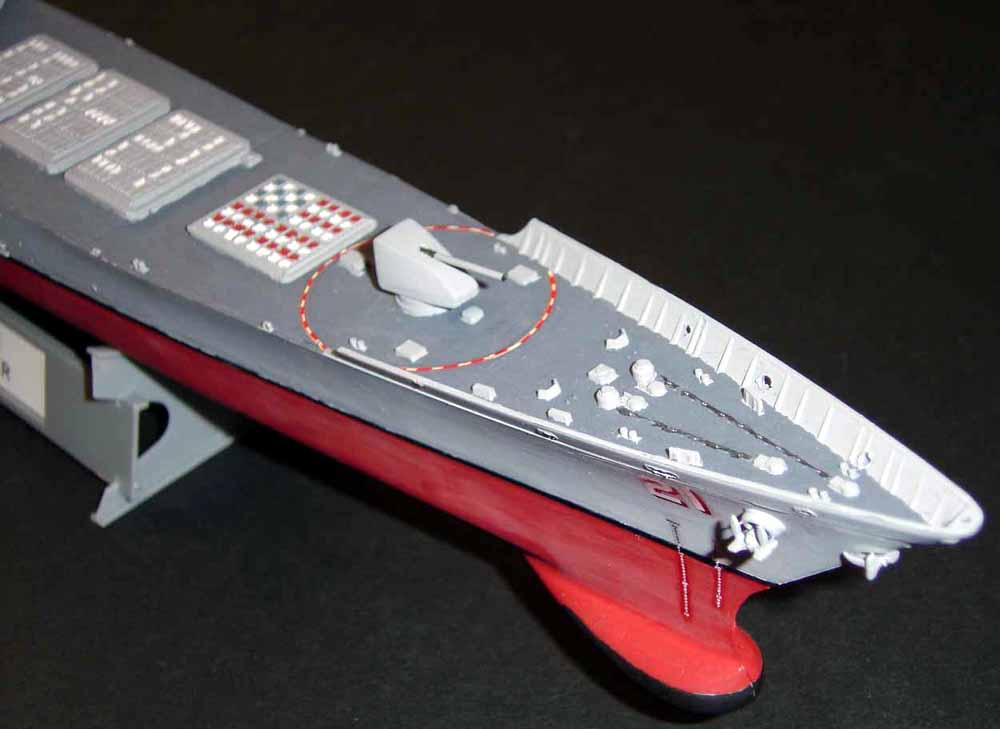

QuoteI'm not sure how I'm going to fully design and build my 21st Century BB. I'm just in the very early planning stages right now.
Preliminary pic here:
http://img.photobucket.com/albums/v216/icyhusky/DSC03869.jpg
As I said, I want to make it "slightly" more futureistic. Not to the point where I want it stealthy or looking like an Arleigh Burke wannabe, but I do want parts of the superstructure, weapons, etc. to be more up-to-date, modern, or whatever you want to call it.
I'll be robbing parts from 2x Arleigh Burke kits, 1x La Fayette frigate kit, and a couple of Gundam robot kits in order to make my future BB. I'll be remaking new scratchbuilt 5" guns from Gundam robot kit parts that will look similar to the guns I did here:
http://www.modelshipgallery.com/gallery/cg/cgx/350-em/strike8.jpg
I am also undecided if I want to replace the 3  16" gun turrets with future looking railgun turrets. If I do make railgun turrets, I may make them similar to the attached pic further below in this post. If I do use railgun turrets, then that means I'll have to go nuclear power for power generation, etc. I'm undecided on this as well since it means ditching the smokestacks and refueling rig.
As far as armament goes, I'm going to load up like crazy! I want this BB ready for BATTLE!  ;D

So........anybody got any ideas and suggestions?
To go really up to date I would make the superstructure with sloped sides like the USS New York class ships.
Firstly, what's it for? Why is it to be built and what purpose will it serve? That will dictate your armament, layout, propulsion etc. Also need to consider if it is to fit through the Panama canal - that gives you a very firm restriction on beam and therefore hullform and overall tonnage, limiting size and fit.
Any warship built in the past 20 years has stealth features, so this will need them too. Enclosed masts, sloped superstructure, etc. How far you go is up to you (do you include ugly stealthy superstructure and gunhouses a la Zumwalt?) but it needs to be a feature. Unless you want to go for a complete rebuild of an Iowa (or maybe Montana?)-class hull.
Armament-wise, I think you have some overlapping systems - do you really want 6 Phalanx and 4 RAM launchers and Sea Sparrows? All those systems perform essentially the same function, so are somewhat redundant IMO. ESSMs can be quad-packed in your VLS tubes, so you don't need to clutter up the decks with old-fashioned launchers. Four Phalanx on the superstructure corners, and two SeaRAM (one each side) will give total layered coverage against anything that gets past the escorts and ESSMs. Maybe add on a couple of laser systems too (THEL or similar).
What is in your VLS cells? If you want Standards (of whatever flavour) you need Aegis. That in itself has a major impact on layout and superstructure design (and obviously cost). If it's all Tomahawks and ESSMs, you can avoid Aegis (the escorts will have it anyway) but the cost of (say) 100 Tomahawks is not insignificant, and your fully loaded ship (already hugely expensive) will have a missile load in the tens of millions.
I'm not convinced you need torpedoes at all - that's what the escorts (and lurking attack submarine) are for. Torpedo decoy systems, yes, and possibly a counter-torpedo weapon system, but your battleship should never need to be attempting a torpedo attack.
