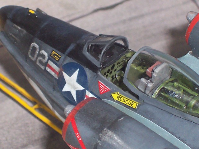

Quote from: sandiego89 on August 26, 2013, 10:06:55 AM
Nice build- like this very much.  How did you tint the canopy?
It's not tinted at all? If you mean the green cockpit - it's just the interior, only the front windshield has been mounted in the pics yet?

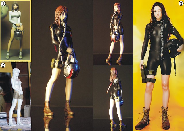

Now for your pilot on the other project- contrary to standard safety standards she does not appear to be wearing a nomex flightsuit.... although bouyancy does not apear to be a problem if she ejects over water  :thumbsup:
Nah, that's just a SF figure, and actually a kind of inner suit to wear inside an armored combat suit.
Inspiration came from a kind of pin-up with a Japanese model from a Ma.K. source book:
1:20 Ma.K. - Brick Works' Mercenary Woman Space Pilot A Inner Suit Ver. (figure conversion) by dizzyfugu, on Flickr
More about the background and making/conversion here  ;) :
http://www.flickr.com/photos/dizzyfugu/4215369087/in/set-72157623045230524
[/quote]
Ahh, soory, was looking at a small photo on my phone.  I can see it now.

Quote from: sandiego89 on August 27, 2013, 05:08:00 AM
[/quote]
Ah, no problem - anyway, if I was to tint the clear part, I found window-painting colors from the hobby store (either water-based or enamel type, which is IMHO more effective and even) to be pretty handy. It's just hard to determine the degree of shade/opacity, as dry paint tends to become lighter and the water-based colors I use are totally opaque.

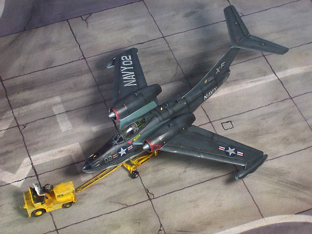

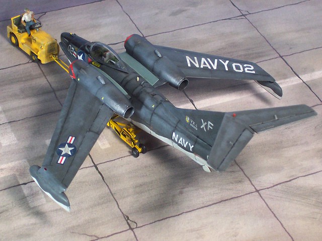

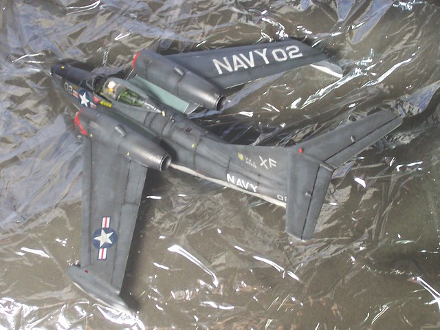

The kit and its assembly:
A lot has already been posted during the WiP phase, but here's a rough and mayve some missing details. This model is a complete fantasy aircraft, inspired by a TV documentation about sea plane projects in the USA and USSR after WWII. Among others, the Martin P6M SeaMaster and the Saro SR.1/A made an appearance, and I wondered how an escort fighter for the P6M would have looked like in USN service? Well, let's build one...
Making a flying boat is pretty tricky, and the whole thing was built from scratch and with lots of putty.
Basically, the following went into it, all 1:72 unless stated otherwise:
● Fuselage and cockpit from a Hobby Boss F-86E
● Floating bottom is the lower half of a Matchbox Heinkel He 115 swimmer
● Wings come from another Hobby Boss F-86E, but this time a Batch 30 aircraft with extended wing tips
● Vertical stabilizer comes from an Academy MiG-21F
● Horizontal stabilizers come from a 1:100 Tamiya Il-28 bomber
● Stabilzer swimmers come from a vintage box scale Revell Convair Tradewind kit
● Engine intakes and exhausts are resin parts from Pavla, replacements for a Hasegawa B-47 kit

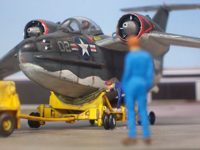

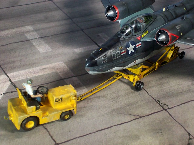

● A massive beaching trolley, which actually belongs to the A-Model Kh-20M missile kit
Assembly went from fuselage over the wing roots, the improvised engine nacelles, outer wings and stabilizer swimmers, step by step. I had a vague idea of what the aircraft should look like, but the design more or less evolved, depending from what I had at hand.
For instance, the Il-28 stabilizers were late additions, as the original F-86 parts turned out to be much too small for the massive aircraft.
The cockpit was taken OOB, just a pilot figure was added and the canopy cut into two pieces, so that it could be displayed in an open position.
Around the hull, small mooring hooks made from wire were added, gun nozzles made from hollow needles, as well as some antennae, since the whole kit was rather bleak and simple.

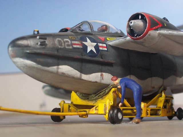

The trolley was puzzled together from the parts supllied with A-Model's Kh-20M (AS-3 'Kangaroo') kit, but was modified (e. g. with different wheels) and adapted to the flying boat's hull. It fits perfectly in shape and design, though!

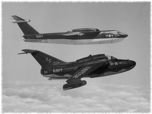

Brilliant stuff Thomas!  :thumbsup: :bow:
The piccies are truly magnificent and the beaching trolley works on your model a treat, really looks the part.

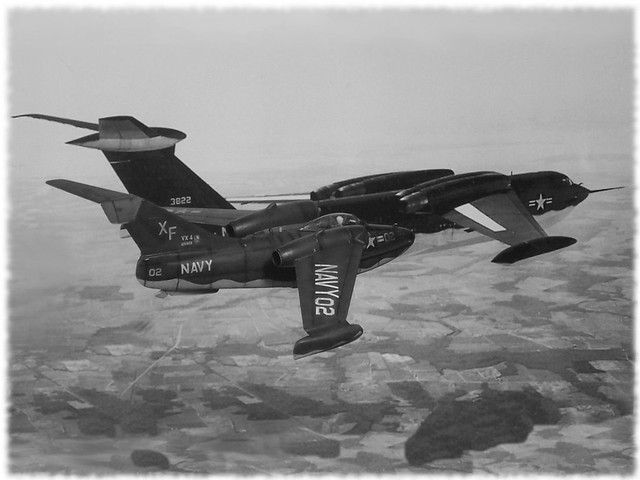

Did any versions of the Oceanhawk have flight refuelling capability? I ask because the second piccie of one in formation with a Seamaster looks just as if it's in the 'hold' position before moving aft to refuel.  ;)
Thank you, Kit. No, no refuelling planned - too early for that. I admit that the FC-1 is pretty close in echelon formation to the P6M - it was hard to find an arrangement that I could actually get both aircraft onto one pic...  :rolleyes: It's no composing picture, just the model in front of a P6M photograph.

Great model.  I kept looking for the refueling hose in the picture with the P6M. It looks like a natural combination.
