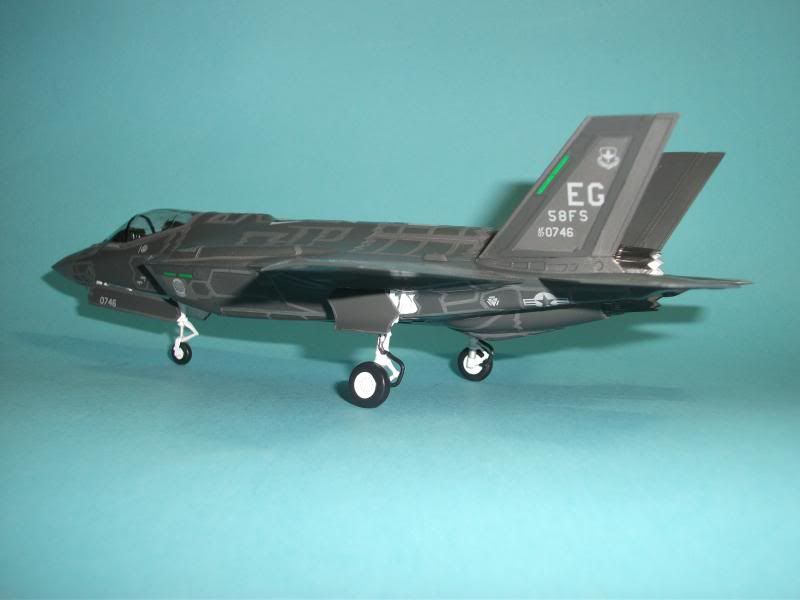

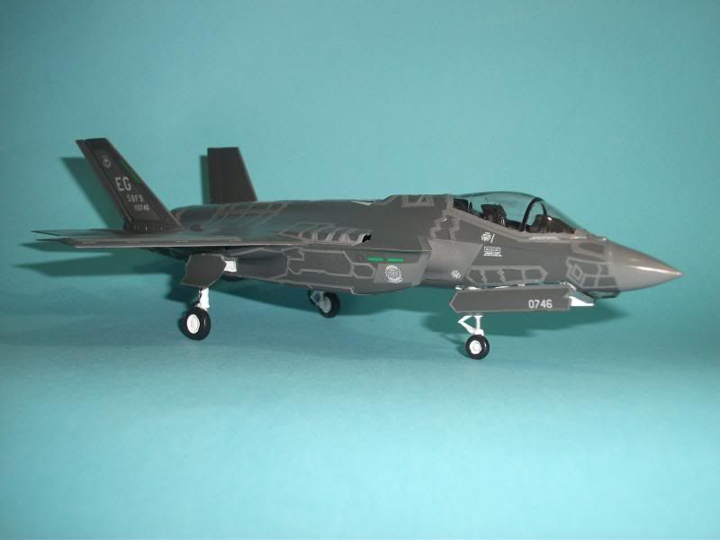

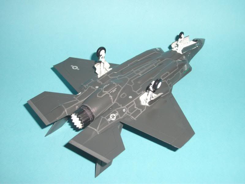

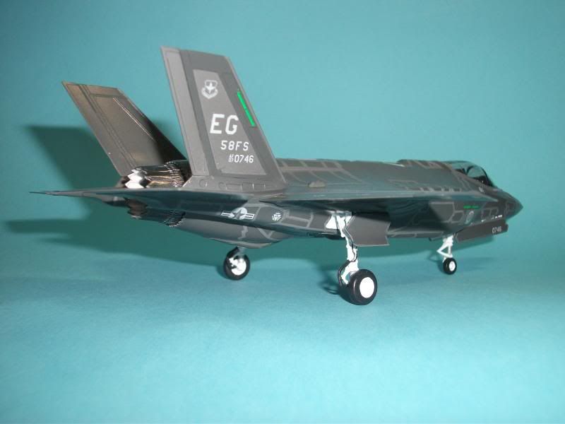

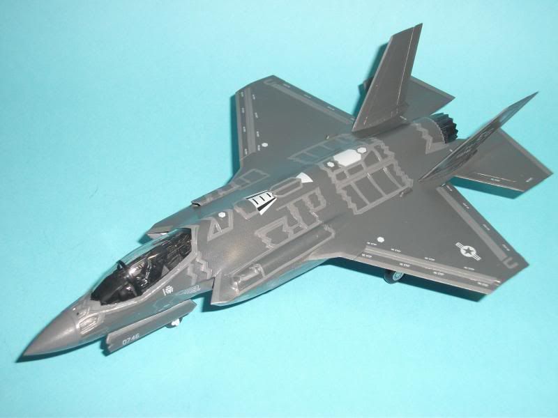

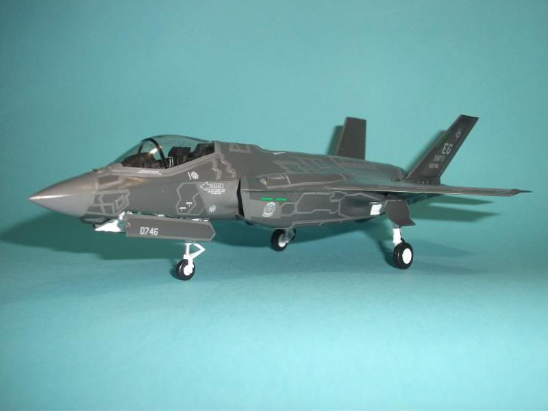

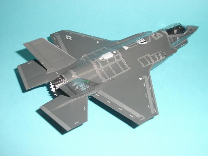

Here are some pics of the finished model I completed a few nights ago.

Chris, what kit is that one?  Italeri 1/72?  Any comments on it?  Go together well?

The kit is the Italeri 1/72 kit.
It was a bit tricky round the intakes and forward fuselage but went together pretty well.
As for the exterior colour callouts, forget them. They are way wrong.
I sprayed with Gunze Sangyo H301(engine grey)(dark grey) and H305(gunship grey)(lighter grey). I toned down the RAM panels with a heavily thinned overspray of Gunze H301. I then sprayed with some Johnsons Klear and a very tiny amount of aluminium paint.

It'll be nice when it's painted.....
Not a criticism of your model Chris, it looks great as a model, but the RW 'colour scheme' with all those light grey 'panel lines' looks TERRIBLE! I hope the RAF camouflage theirs in grey/green, or maybe that lovely all-over green they painted the Harrier GR5s in.

After seeing a couple of builds just laetly I decided to buy the kit --- yesterday in fact  ;D
I like what you've done Chris    :thumbsup:

Evan and Greg (BTS) have told me that the 'in-service' colour will be a camo of some sort -- not like how they are at the moment.
Nice work Chris ! Almost looks like it's flying !

Which means the RN & RAF birds will be Grey over Grey of some sort........................................
