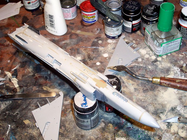

As already mentioned, this is an almost OOB build of the Trumpeter J-8II (NATO code 'Finback B'), with only minor modifications. The kit is very nice: Fit is good, you get recessed panel lines, as many details as you can ask for – just some fit issues with the fuselage halves and slight sink holes at the air intakes. While you need some putty, anyway, the thing goes together very easily.
1:72 Hawker Harpy F.1A; aircraft 'XL196/J' of 43rd Squadron, Royal Air Force; RAF Leuchars, 1969 (Whif/Kit conversion) - WiP by dizzyfugu, on Flickr

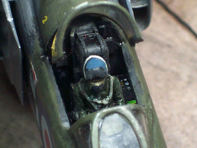

Personal mods to create the Hawker Harpy include a Matchbox pilot figure for the cockpit, two fins ('Finback A' style) instead of the J-8II's single MiG-23 style folding fin, new drop tanks (from a Matchbox Hawker Hunter, with fins added) and four Red Top missiles (from an Eastern Express Sea Vixen) – all for a convincing RAF look.
Other small mods include e. g. getting rid of some typical Soviet-style antennae (even though I kept the almost iconic anti-flutter weights on the tailplane) and the GSh-23-2 cannon fairing under the fuselage, which was replaced by two single gun fairings for 30mm Aden cannons under the air intakes.

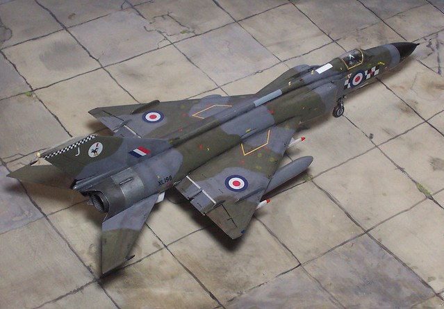

Painting and markings:
Classic RAF colors from the Sixties, with Dark Slate Gray/Dark Sea Gray from above and Light Aircraft Gray below (Humbrol 163, 164 and 166, respectively). The aircraft received a light black ink wash in order to emphasize the kit's fine engraved panel lines, as well as some dry-painting with lighter shades (including Dark Slate Gray/Dark Sea Gray from Modelmaster – these tones are a tad lighter than the Humbrol counterparts, and Humbrol 196, RAL 7035).
The cockpit interior was painted in dark gray, while the landing gear wells and the other interiors were left in Aluminum. The landing gear was painted in Steel, the wheel discs white and the air brakes in red from the inside.
Decals/markings come from an Xtradecal sheet for RAF Phantom FG.1/FGR.2s, "XL196" is, AFAIK, a 'free' (never used) RAF serial number that fits around 1962. Some additional stencils and markings were painted onto the fuselage by brush.
After decal application the kit received an overall coat of semi-gloss Tamiya acrylic varnish.
1:72 Hawker Harpy F.1A; aircraft 'XL196/J' of 43rd Squadron, Royal Air Force; RAF Leuchars, 1969 (Whif/Kit conversion) by dizzyfugu, on Flickr
The Hawker Harpy is/was simple kit travesty, but IMHO the resulting 'British product' looks very convincing and late-1950ies style?
It has an epic aura...  :ph34r: I am actually inclined to build another one - if it was not such a big bid(!) - and give it an all-grey low-viz paint scheme for the early 80ies?

Ooh ! , I do look like that , it just looks so right . Excellent build and idea , well done indeed.

This post is what makes this site so fascinating.  Believeable backstory,  superb modelling  and remarkable photography.   Definitely a potential Whiffie 2014
Sticky Fingers
Weren't you tempted to mount some over-wing fueltanks or rockets for that British Jet look?  ;)
What a great build! And as usual I love the photos :wub:
Ah, no. Overburgers would not make sense - as sick as they are, on a Lightning they are even plausible! The Red Tops are enough RAF make-up here - sublety rules... ;)

This in-progress pic got me thinking: a tailless delta aircraft? Maybe chop a little section out of the fuselage to shorten it. I suppose that would make it look sorta Fairey Delta III-ish. Maybe even some canards for a Shenyang version of the Chengdu J-9?
