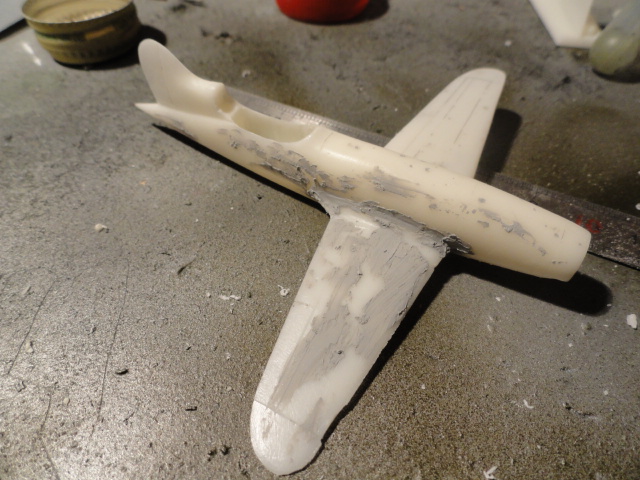

Well for a very short run product, nothing very special : easy separation of the pieces from the sprue, a few sanding and it's glued !
Because of the moulding technic, some holes appear. Sprotch ! Mastic :
Let's use some paper and the airframe remind me my skin 25 years ago :

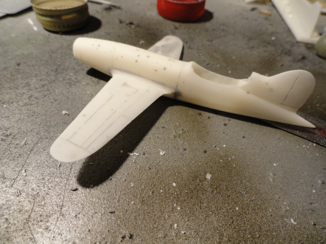

The little bird is sanded. I am re-engraving her, very smoothly, because, you know, it's only 1/72 !
Yes, the canopy is vacuumformed. It's an horrible difficulty for me too, as well as the masking of it. How lucky are 1/32 modellists !!

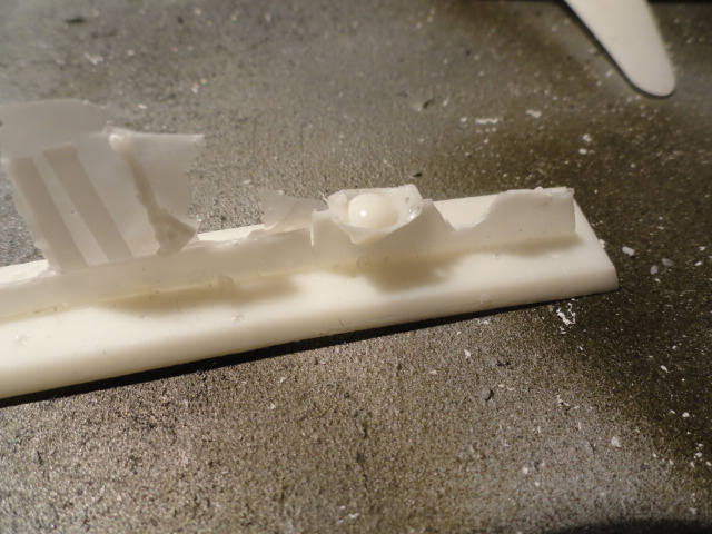

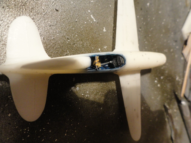

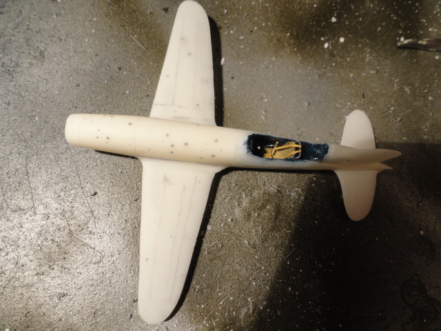

Well, some details for the cockpit. For sure, the original seat has some troubles :
Hopefully, my secret spare stock provides a new one, fitting well. I added a lead structure, and glued on it the belts (painted aluminium sheet). A direction column come  and, then the instrument panel. With the night blue interior, there is nothing much to see in this very confined space.
As you can see, the stabilizators are in place as well as the tail skid.

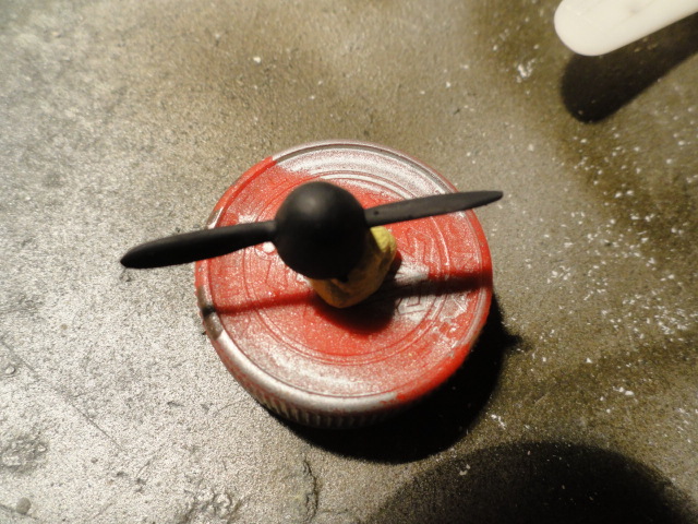

The propeller is almost finished.

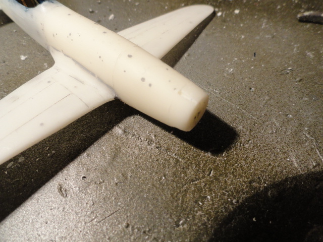

As this plane was planed to be a fighter trainer, I suppose she would get a machine gun. Because of the thickness of the wing, I grabed a gun mouth on the starboard side of the cowling (cylinders on port).
Great ! You see nothing !  :lol:

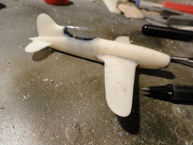

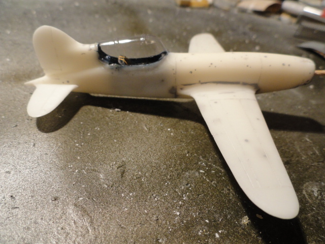

Hi guys !
This is a very little update.
Installing a vacuum-formed canopy is always a great moment of torture for me.
This is how I proceed:
- I cut off the piece from its sprue not too far away from the definitive border ;
- I put it on place with a strap of adhesive ;
- with a pencil I write the border ;
- then final cut.
Of course, it does not match at the first time. Some dry tests and sanding are required.
And, finally, after a loooooong time, it matches (more or less) :

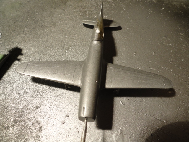

You surely noticed that the plane is on its own legs.
The transparent thing is masked and the plane is overall painted (Tamiya TS 17) :
Arf! Some holes left...   :-\

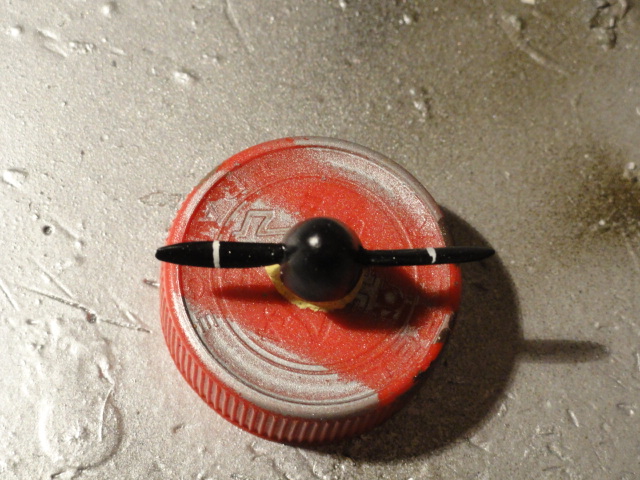

At least the propeller is finished :
