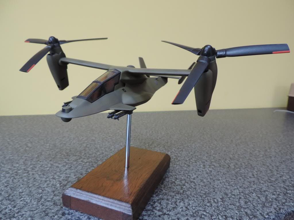

I've just managed to get around to completing a kitbash I started 6 or 7 years ago.

Yes it's a 1/72nd Osprey mashed with a 1/48th Stingbat LHX. I  bought both kits with the intention of joining them together.
As for the build the first thing I had to get rid of was that weird "greenhouse" Stingbat canopy which I did by by reshaping the lower edge of the rear cockpit cover and then adding some Apache style framework which I emphasised by painting it black. The canopy was tinted by fixing pieces of 35mm film negative to the inside. I also raised the rear crewman's seat by 3mm. I re-profiled the rear fuselage quite a bit and did away with the redundant NOTAR  vents. The V22 tailfins were reshaped on their lower edges and then mounted at a jaunty angle (as Corporal Jones used to say).
The canards were added as somewhere to hang missiles from. I've discovered it's quite tricky finding somewhere to hang missile from on a tiltrotor.  The original Stingbat design had internal weapons bays and I've kept that concept on my model too - although any doors for the bays are firmly closed. The rotating gun is in the same place as the Stingbat's.
When I started building the model I made wheels wells, one at the nose and one in each side sponson, for retractable undercarriage. It then became apparent that the front fuselage was way too small for a wheel to retract into so I blanked the wheel wells off and stuck with the Stingbat's retractable skids. I could have had a wheel at the front of each sponson and one at the rear like an Apache but it just didn't look right for a tiltrotor. The wings and engines are V22 although I did add some exhaust deflector grilles made from the ends of cable ties.
Weathering is light and doesn't show up too well on photos.
