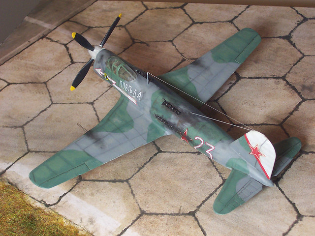

Painting phase! While the I-2M107 looks odd, to say the least, I wanted to keep the paint scheme rather simple and quasi-authentic. I went for a pale grey/green camouflage, used e. g. on late war Yakovlev Yak-3 fighters.
Basic colors are Humbrol 31 (Slate Grey, it has a very greenish, even teal, hue), ModelMaster 1740 (Dark Gull Grey, FS 36231) and Humbrol 167 (Barley Grey) for the lower sides with a wavy waterline. Since only marginal surface details were left over, I decided to fake panels and panel lines with paint.

Panels were simulated with lighter shades of the basic tones (RLM 62 from ModelMaster, Humbrol 140 and 127 below), panel lines were painted with highly thinned grey acrylic paint and a special brush - in German it's called a 'Schlepppinsel', it's got very long hairs and is also used to paint scallops on car models, and similar things are used for real car tuning/custom paintwork, too.
Sure, the painted panel lines are a bit rough, but I did not want to risk any damage through manual engraving on the rather delicate mixed-media surface of the kitbashed model. For an overall look or first impression it's very good, though.
As 'highlights' I added a white spinner and half of the fin was painted white, too.

The decals were puzzled together. The flashes and the tactical code number come from a Hobby Boss La-7, the Red Stars, IIRC, belong to a vintage MiG-21F from Hasegawa. The "Rodinu" slogan actually belongs to a 1:35 Soviet Tank decals set.
Finally, after some additional dry painting with light grey, some oil stains around the engines and coolers and soot stains at the exhaust stubs and guns (painted, plus some grinded graphite, as it yields a nice, metallic shimmer that looks like oil or burnt metal), everything was sealed under a coat of matt acrylic varnish.
One of the final steps were two antennae made from heated sprue.

Awesome stuff ! That thing just looks right. Kinda fat ( like my cat  :wub: ) but that's ok !
Love the pic of her taking off.
And no worries about your panel lines....they look perfect to me ! Especially when combined with your photo wizardry !
