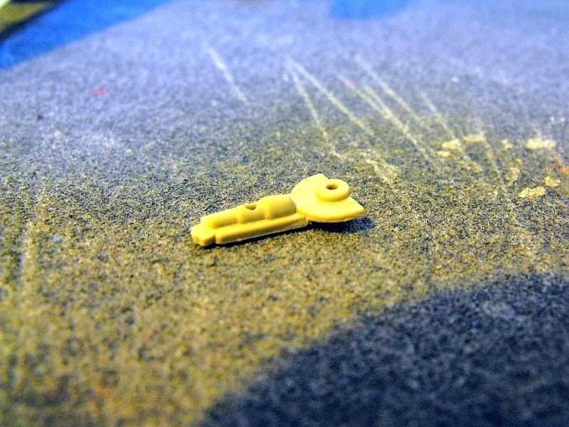

The tailhook will need to be reworked, Frog had it as a single support, whereas it was actually a V shape. So carving out the troughs has begun, to be filled with whatever I can manage to throw together:

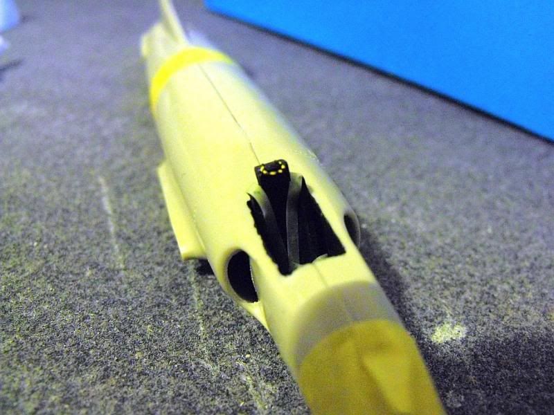

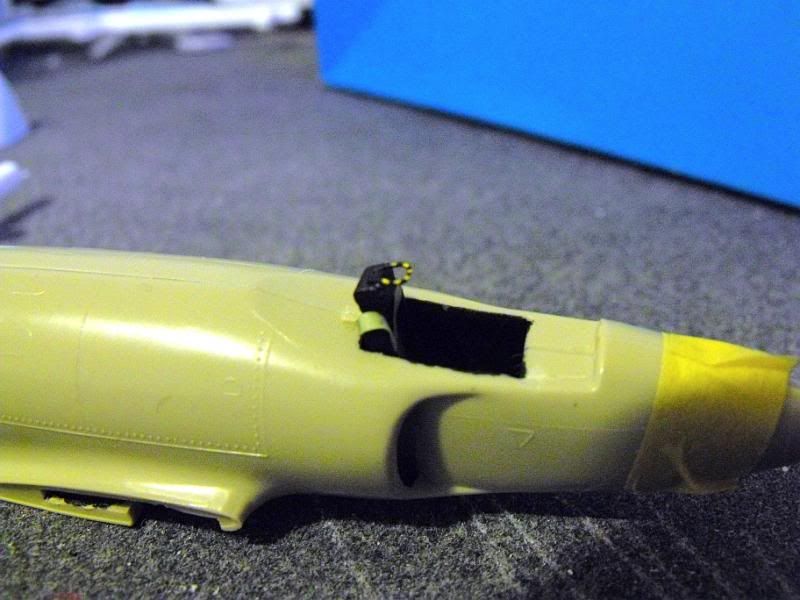

The fuselage and wings are not yet glued, just taped and dry-fitted together for photo purposes. A very rough cockpit has been scratched, seat from a bread-bag tie, belts from masking tape. Belts are obviously a bit too wide, but under the very thick canopy not much will be seen anyway. Headrest from sprue, ejection handle is wire:

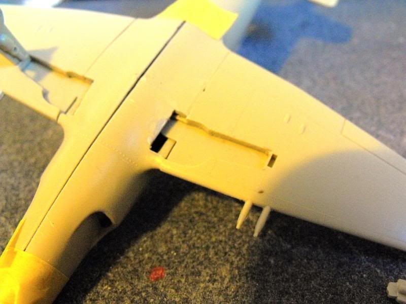

The landing gear was a bit frightening at first, but it may be workable. The very thick gear doors will probably be carved away until there is a fully formed strut, and plastic sheet used to construct a new doors:

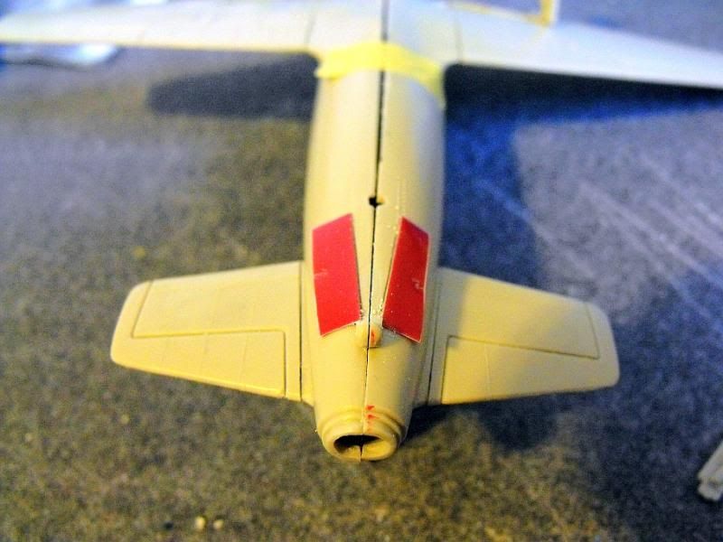

A new tailwheel will need to be scratched, the original is a single unit instead of a double. The wheels themselves have already been cut from a piece of sprue of the correct diameter, need to construct the leg next. Don't know if I'll construct a well for it, but tail gear doors will have to be constructed. The intakes have been lengthened from the inside with plastic sheet, lessens the see-through effect.

And it seems the audience is unanimous, so Belgian it will be. Carving the main gear will not be easy, this is very brittle plastic so it will have to proceed carefully, with a degree of patience that I rarely have.  :banghead:

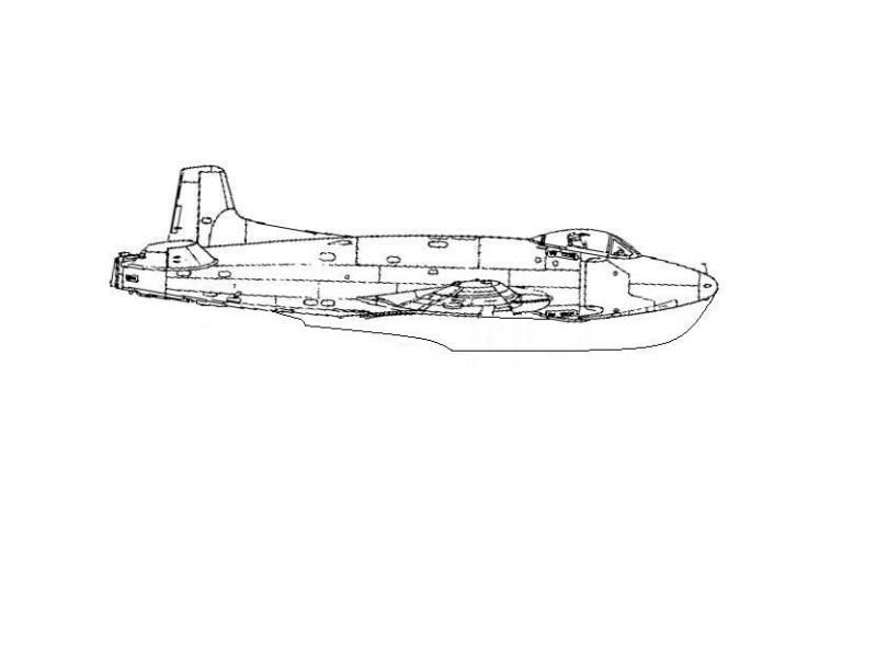

That was my original plan, even had a rough sketch done:
The fly in the ointment was the air intakes. Thought about having them closed with doors during take-off and landing, with a retractable arrangement on top of the fuselage behind the cockpit. The wings also seemed a bit low, might have rotated the fuselage section 180° like I did with the Nodens. Because of those two major issues the project languished for years. Then I saw the leftover Belgian decals and immediately thought YEAH!

I see your point re: the boat version....to remedy the intake/ wing layout would pretty much make a totally different aeroplane !
Test hacking on some sprue has convinced me that this plastic is far too brittle, and attempting to modify the landing gear would simply be courting disaster.  :angry:

Make new legs.  Use some brass wire and tube.  Cut the tube to length to represent the wheel leg, pass the wire through it and bend to form a wheel attachment.   Make the gear door from plasticard.  That is what I often do, works a treat!   :thumbsup:
