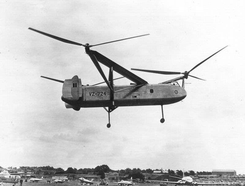

Of course to be REALLY weird you need to look at the engine fitted to the three-rotor Cierva Air Horse.
They used a MERLIN of all things!  :o
