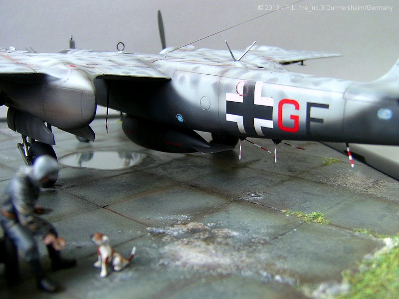

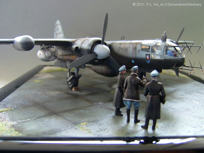

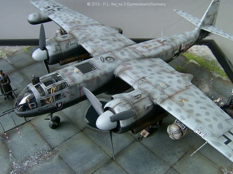

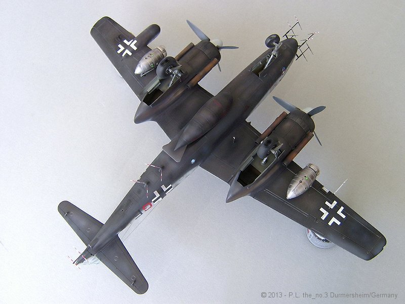

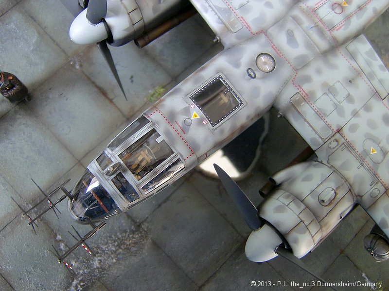

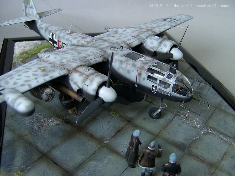

Hello

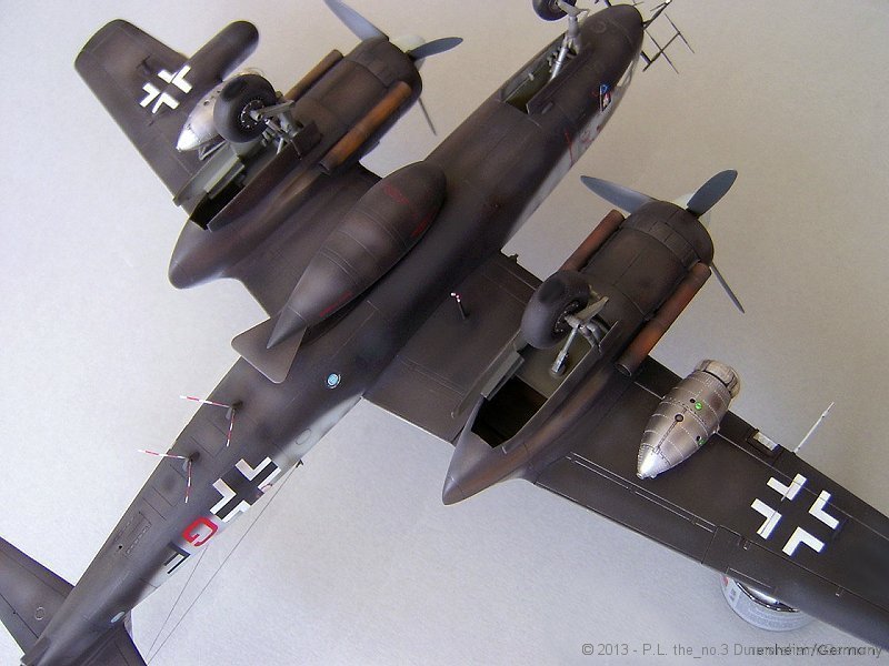

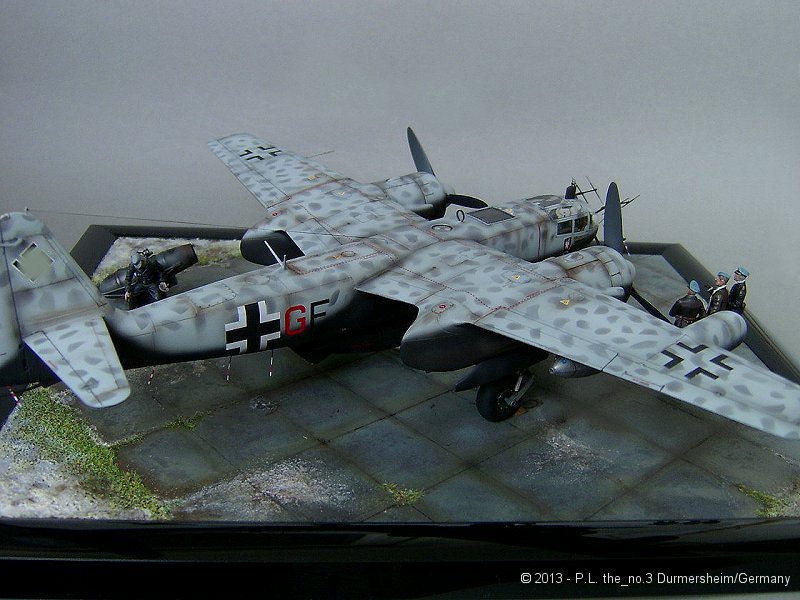

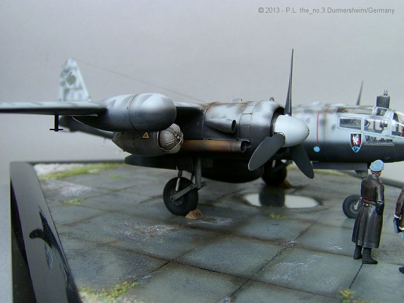

My name is Peter and I'm from Germany. I have been following for a long time with interest this forum. Now I want to show you a what if model of mine.
It is the Arado Ar/Ta 235 N-0 "Stachel".

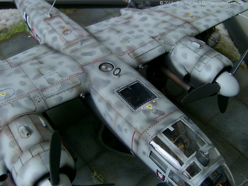

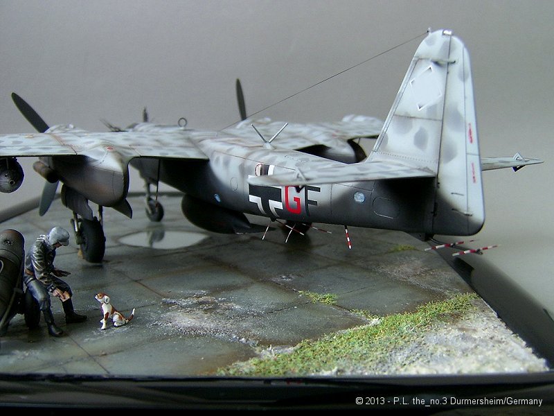

The model is a mix from Revells Arado 234 B-2 / N & Focke Wulf TA 154, scale 1:48, figures are from ICM and Preiser.

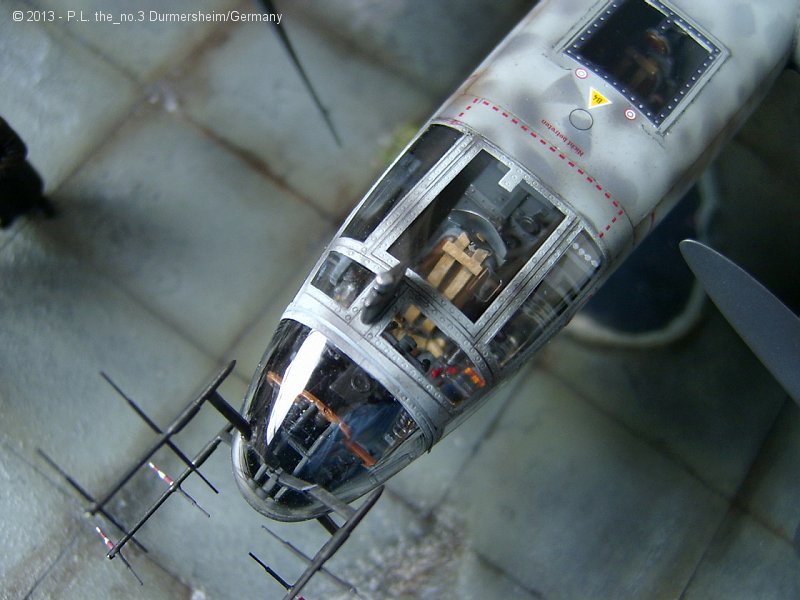

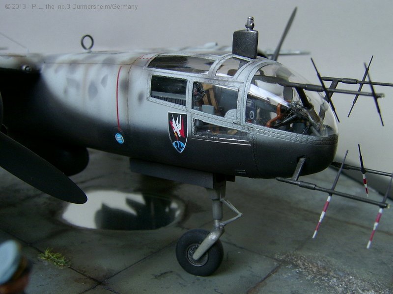

Wings, engines and landing gear are from the Revell TA-154 partially changed. I changed front landing gear, engraved some new lines. The cockpit refined and build new the radio operator space. I added new brake lines, gun barrels from needle cannulae and scratch built the flame killer.
Radar FuG 218 V / R "Neptune" (combined night hunting and reverse warning device) and Fug 400 "Athena" are complete self-made.
900 liter auxiliary tank from Italeri, and a lot of new details. Painted, weathered and washed with colors from Revell, Testors and pastels.

That, Peter, is TREMENDOUS!  :thumbsup: :bow:
The idea is great, the model is OUTSTANDING and the figures look as if they're about to step off the page!
Welcome to the Forum, you'll fit right in here with ideas like that.  ;D
That is excellent.  And believable.
Well done.

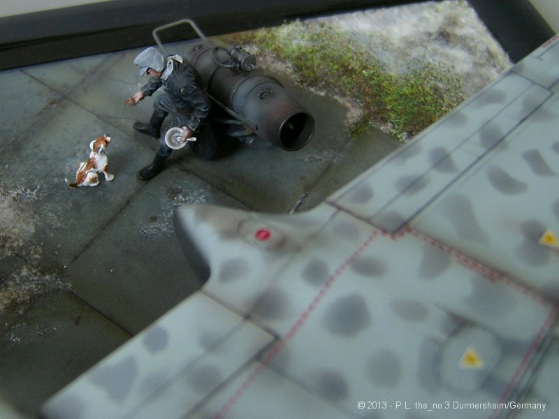

I love the dog.
sandiego89
Quite an entry! Welcome Peter. Really well done, really like the engines and paint. Great work!

If you hadn't told us otherwise, I would have bought a story saying that this was a rare kit of a rare variant of the Arado 234.
Brilliant build & diorama! :thumbsup:

WOW.....!!!!! What an awesome build.....and welcome to the forum........ :thumbsup:

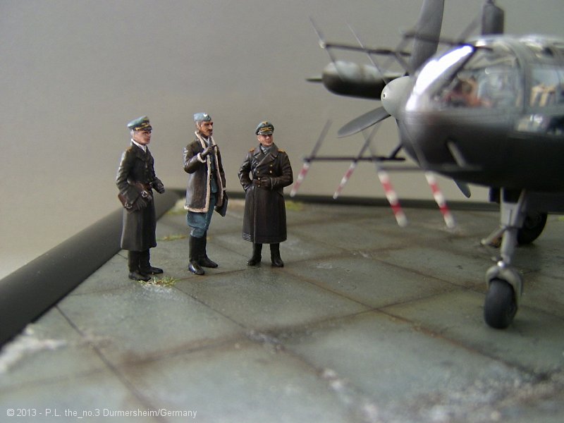

Can't argue with that one, the quality is superb!  I love Adolf Galland inspecting the aircraft.  Who's the dozy ground crew sitting down in the presence of officers?   :thumbsup:

The idea for this conversion was: I like the basic design of the Arado, but I do not like jet engines.....I'm a fan of propeller aircraft.
The jet engines at that time were not designed for long-distance missions, therefore I built the Arado with conventional prop engines.
The original wings of the Arado are too narrow for prop engines, that's why I built the wings of the FW-TA on it. That was most of the work to adapt the Focke Wulf TA wings to the fuselage of the Arado.

This is not Galland, it is the General of the German night fighters Josef Kammhuber at the inspection of the new aircraft and the ground crew man has not noticed that the officers are present (he was responsible for the defrosting of the aircraft)   ;) ;) ;)
