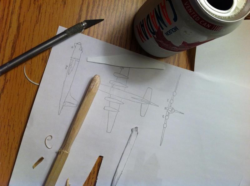

To kill time I've brought a small stick of balsa, plus an old hacked up sheet of styrene, a knife and some sandpaper.
Plan A : A 350th scale Canadair Argus. Plan B ? Whatever scale this is ! I tried to scale it myself but I'm hopeless at math. So I traced what was on the computer screen onto paper and this is where I'm at now.

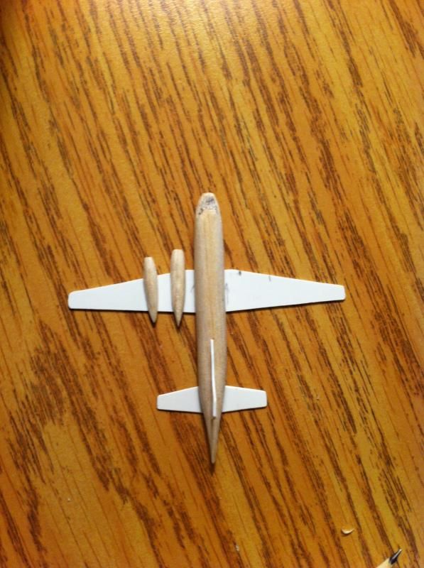

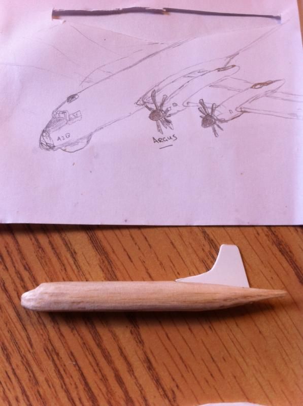

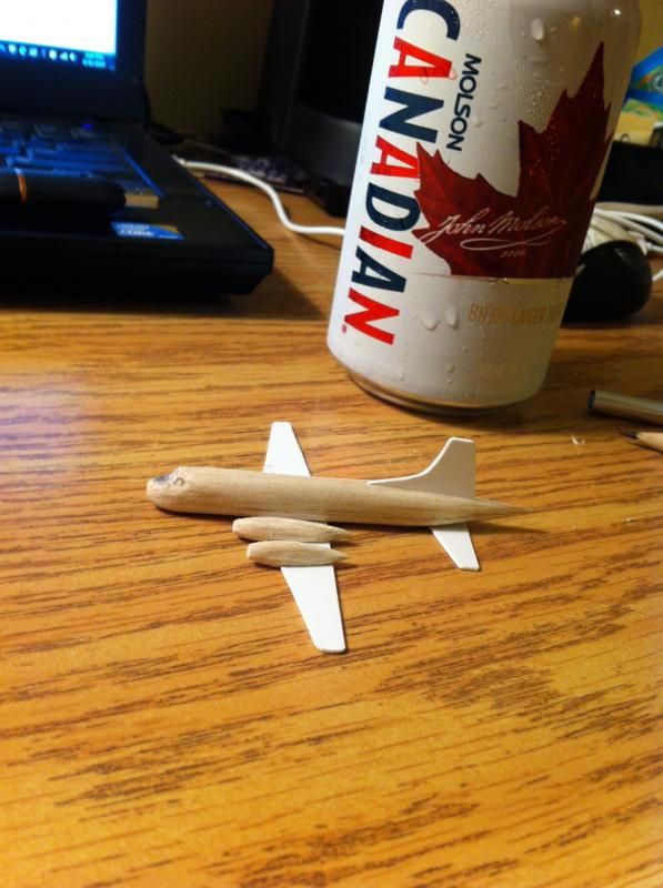

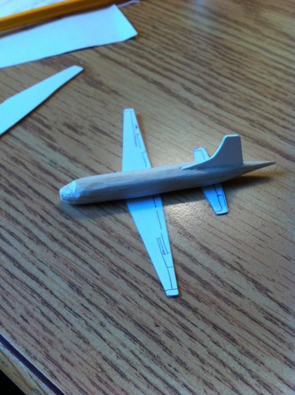

Coming along nicely I must say ! Basic fuselage shape is done.
Overall configuration. I traced the screenshot onto paper, and then cut the paper out, and retrace that onto the styrene. I wasn't happy with my first wing, so bought a cheap ruler to keep things straight. I have also notched out a groove for the vertical tail to sit in.

Looking very good, you should think about droping it into a vat of silicon moulding compound when it is done.

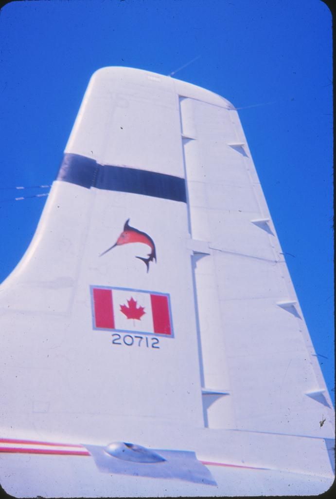

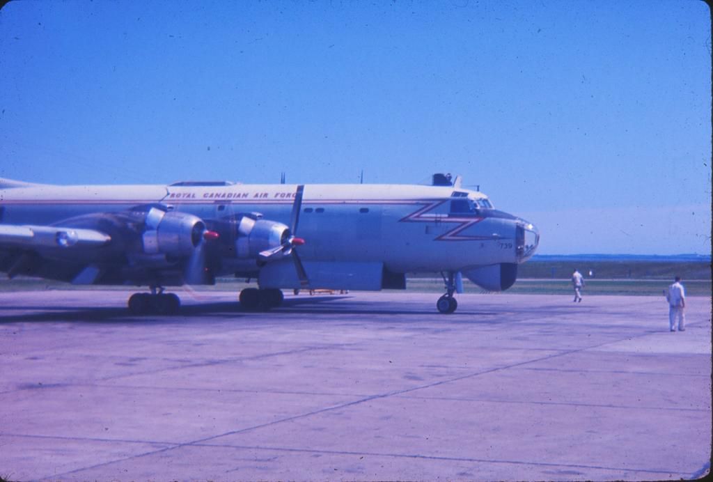

Anyway here are the only two slides that I can find from my visit to Shearwater in 1967.
Jim
Gorgeous shots Jim ! Love this aeroplane...what a beast !
I would like to cast it, but this is just a test shot kinda deal. I have to figure out the specs in 350th scale. My calculations have it 11.2 cm long and 12.28 cm wingspan, but that seems kinds big to me !? Anyone ? Bueller ?

By them nacelles are alot of work !
Why 1/350 scale Cap'n? Or was it dependant on the size of the raw materials to hand?
In any case it already looks pretty much like an Argus.  :thumbsup: And I'd echo JayBee's opinions about the Argus, what a wonderful looking aircraft, I'm sure they'd be able to frighten submarines away without dropping anything 'orrible on them.  ;D

Coming along nicely! Oh, don't forget that there's a windshield wiper on the nose glazing.  :wacko:

According to my trusty "Observers World Aircraft Directory" of 1961, the dimensions are :
Span 142 Ft 3.5 Ins.
Length 128 Ft 3 Ins
Height 36 Ft 8.5 Ins. I assume that is standing on it's u/c.
That gives in 1/350 scale
Span 4.88 Ins or 12.39 cm.
Length 4.4 Ins or 11.18 cm.
Height 1.23 Ins. or 3.12 cm.
So your calculations are pretty damn close.
