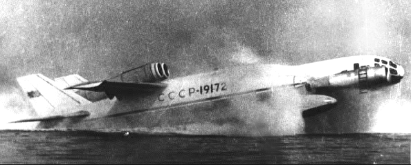

The Bartini Beriev VVA-14 used 12 lift jets in the centre body to help it take off.
It could fly in ground effects or as a conventional aircraft.
