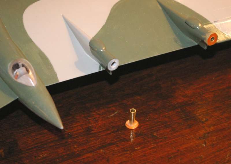

I wanted to make the props on the Northampton plug-in units as there's no fin or anything else to protect them from the trials and tribulations of being carried to shows. In fact the props ARE the highest parts of the model! AMT/Ertl in their wisdom have made the prop shafts quite thin and the bearing area to support them in the shaft housings very short so without the supplied collars to fit on the inside of the bearing area they wobble like crazy.
So I glued some styrene tube over the shafts to lengthen them and I had intended to glue some suitably sized brass tube into the shaft bearing area to take the shafts. It then occured to me that this would be a 'one shot deal', if the tube didn't fit and glue exactly I'd not be able to get it out again as the end of the tube would be flush with the end of the bearing! And if I pushed it in too far it would fall inside the shaft fairing and would never be seen again.  :banghead:
So Plan B was formulated. I cut the brass tube into four lengths, around 3/4", filed the ends flat and reamed them out to take the thickened shafts and superglued them into small square pieces of 20 thou styrene sheet. Then I marked, cut and filed the sheet to the correct circular diameter and test fitted each one into it's appropriate housing. That took about 100 times longer to do than ity did to write, it was a long, arduous and VERY frustrating job, and I had to scrap out two of my attempts as the tubes weren't perpendicular to the styrene sheet.
But at last I managed to make four of the little blighters and three of them are glued into place with some putty around the joint. I'll sand that down and paint up the ends of the shaft fairings later today, but in the meanwhile here's a pic of the last remaining bearing to be fitted together with its companion shown already in place.
