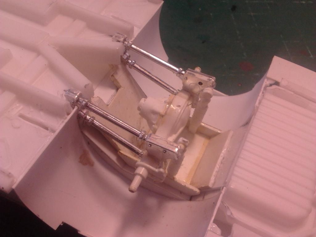

Now this was no easy build,,the front and rear suspension is molded into the chassis as well as most of the interior .
So i had to build a completely new front and rear suspension which meant cutting and cutting and more cutting to remove everything i didnt want or need .
Heres the pics to show you guys what was involved and the results ..
First what she looks like now on her wheels ..
When i built the front suspension i wanted this to sit low and i got that just right with its 19 in front wheels .
Now the front suspension .
Now the rear ..

On a pedantic note, won't you need a Watt's linkage or similar to stop the rear axle going sideways though?

Kit ... Oh you bet there will be a Watts in the rear of this but its not there yet  <_< ,,i am still working the undertray to clean it all up before i build the mount for it .

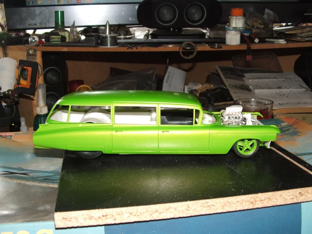

Decided to throw some paint on this thing ...just to see what else i want to do to the paint ... thinking a matt black stripe down the side ...breaks up some of the green .

Oh that is just a bel ringer. I found a good trick is to use gloss black paint on all the side window posts. I did that on my real station wagons and it was like a visual chop on the top. "How much did you take out of the top?" was asked at many a gas pump.
Yep, thats green.
Hot pink flames or 80's style graphics?
Maybe Slimer got hold of it???
