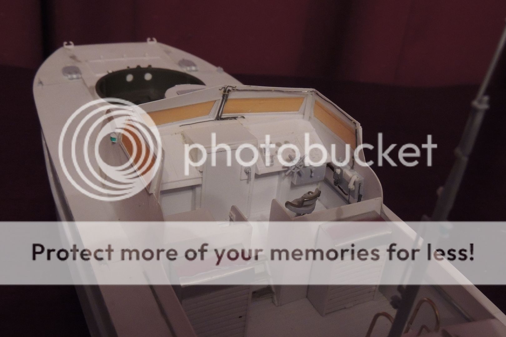

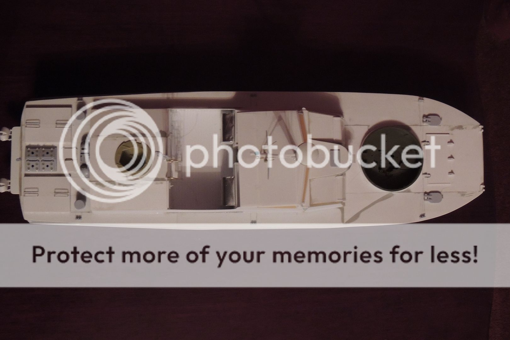

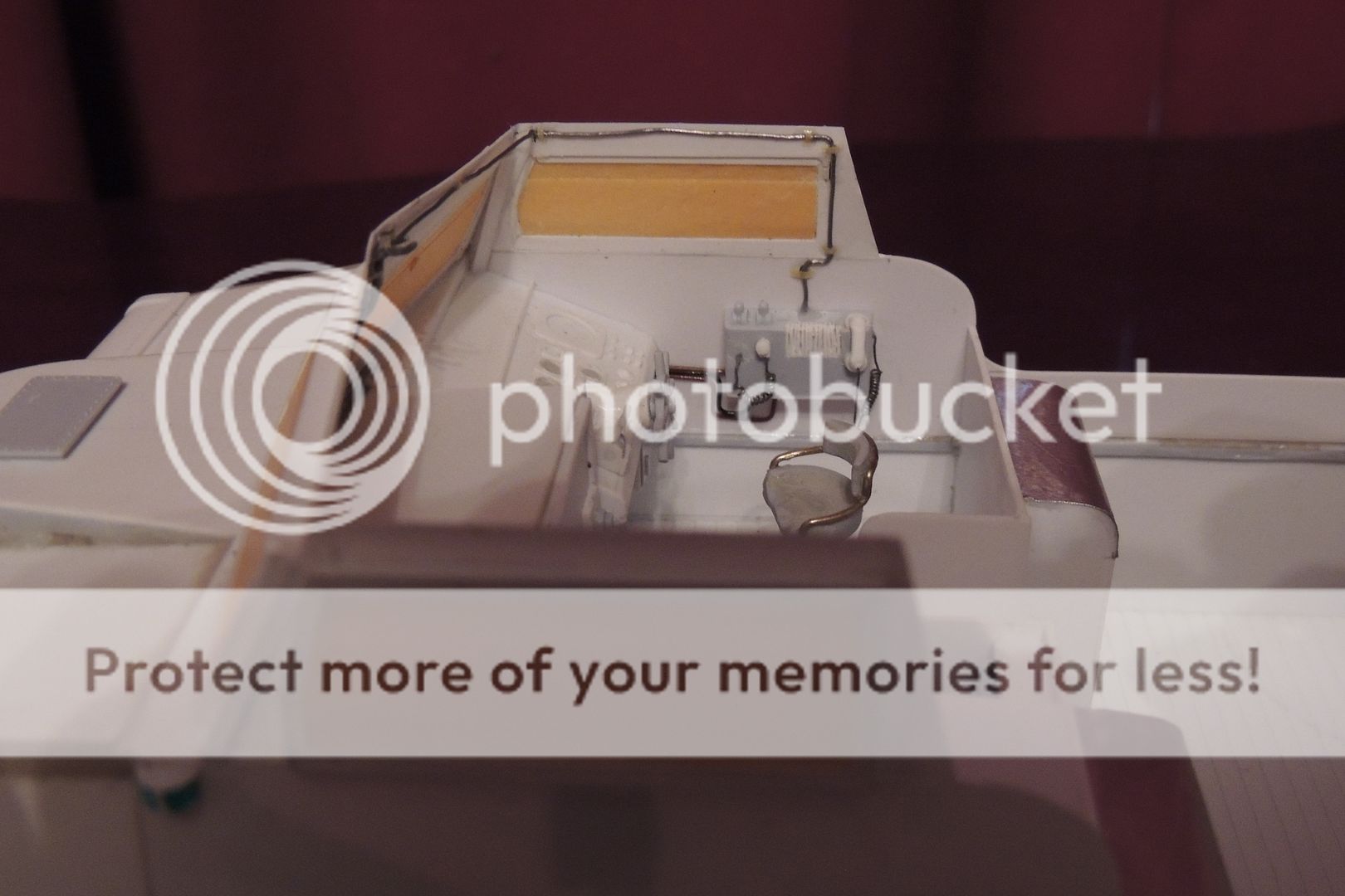

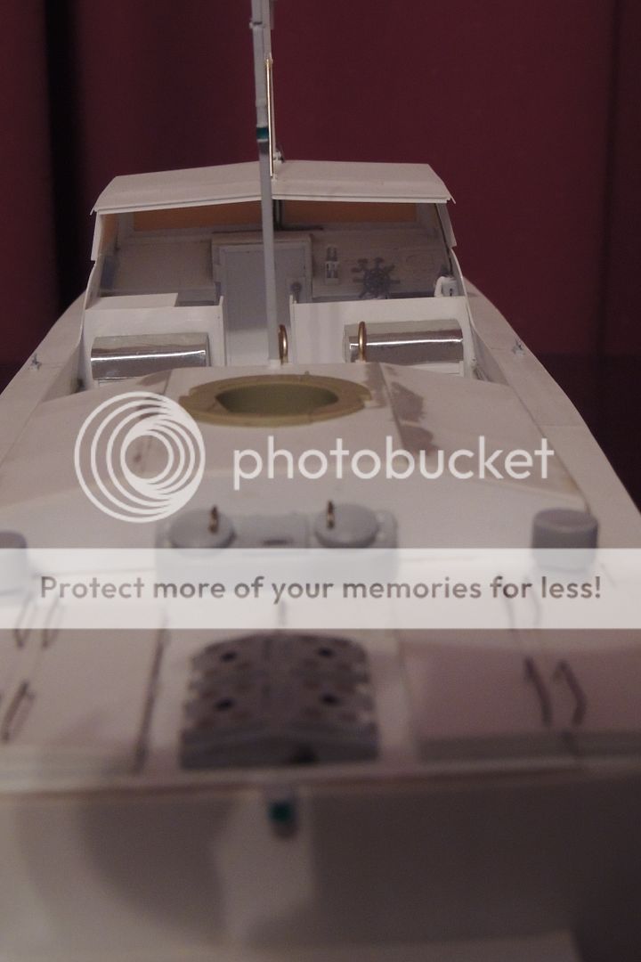

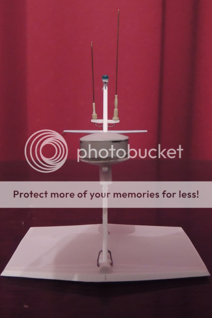

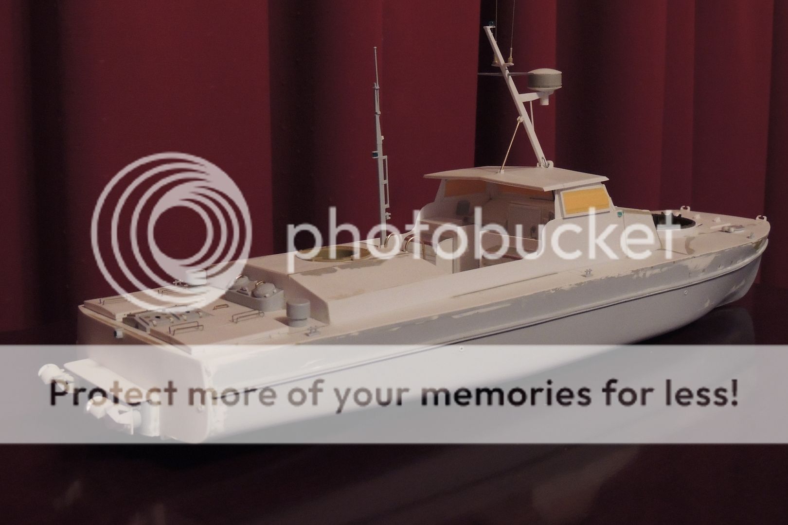

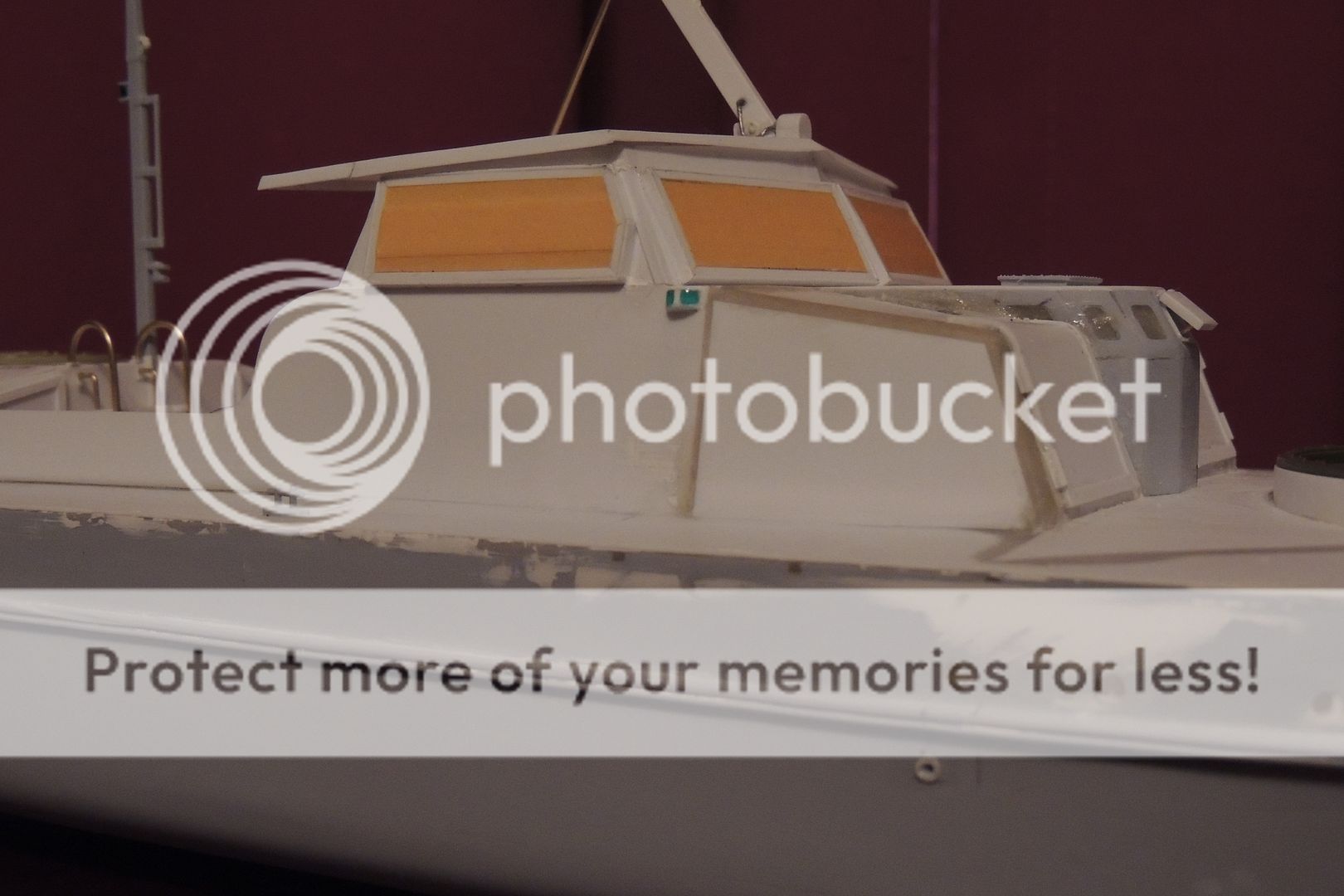

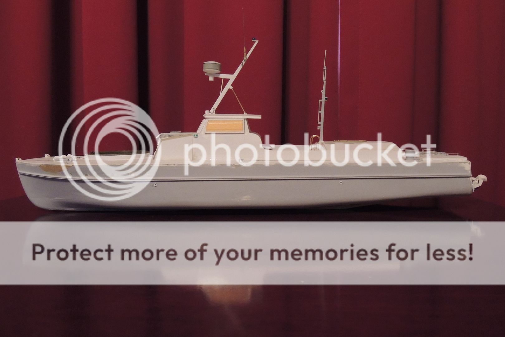

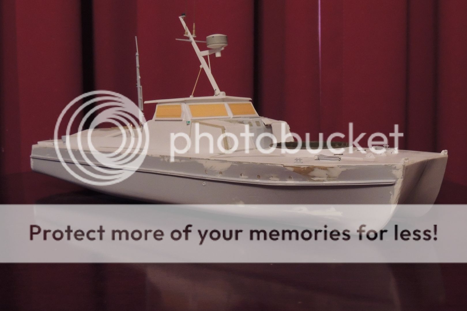

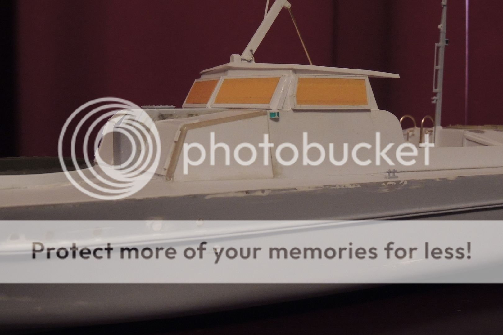

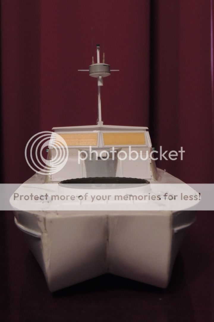

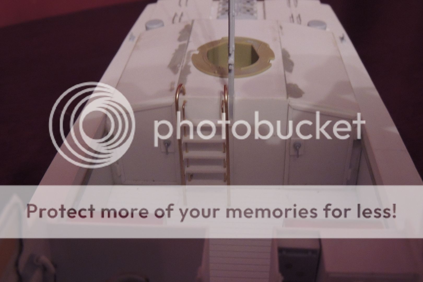

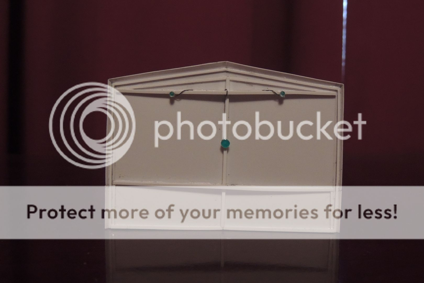

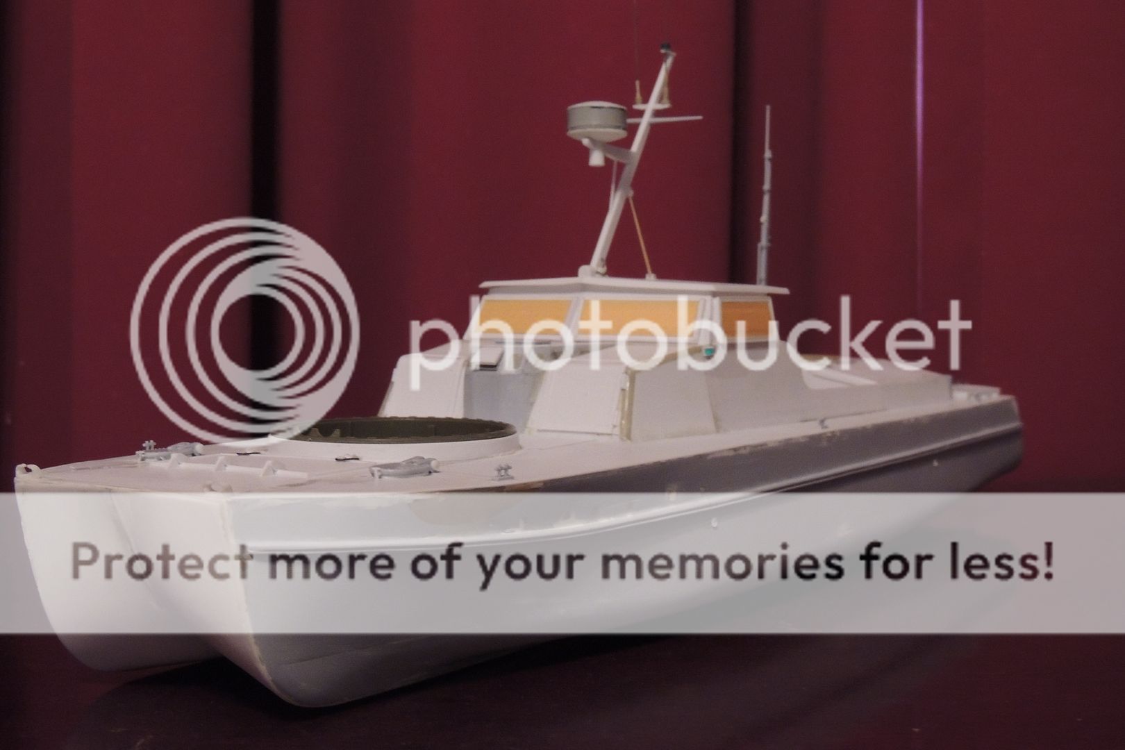

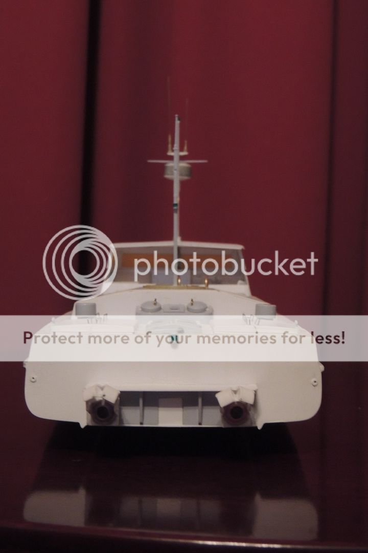

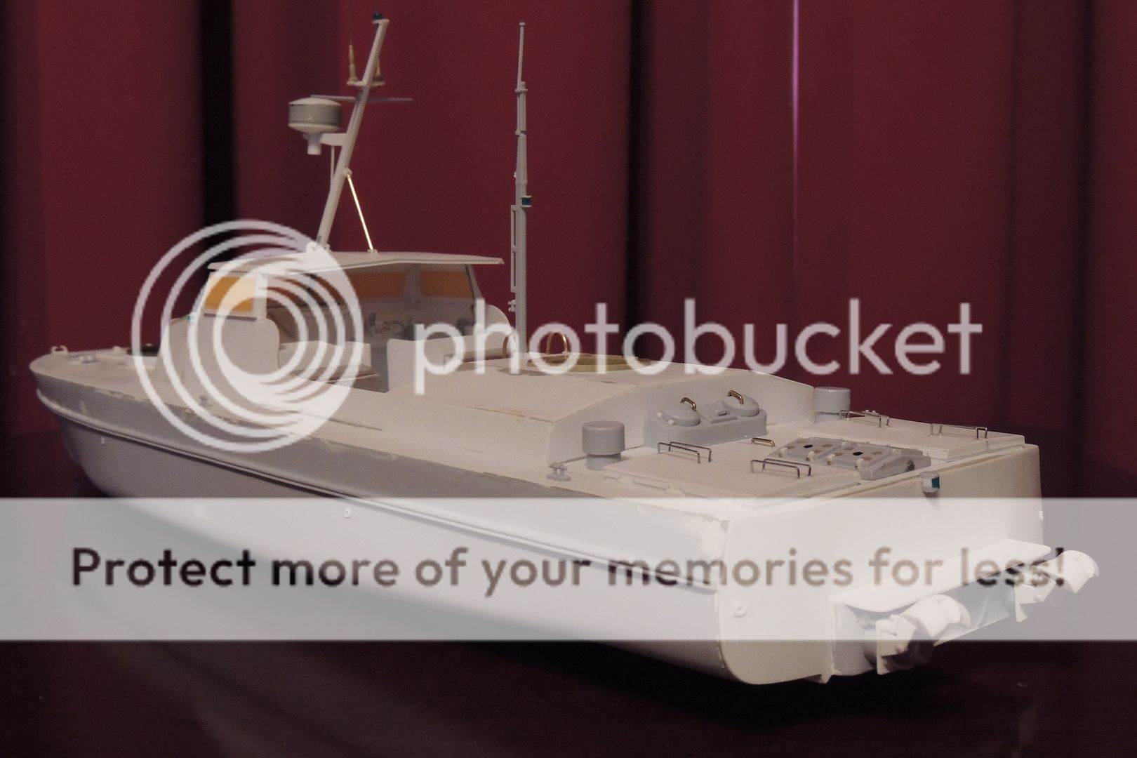

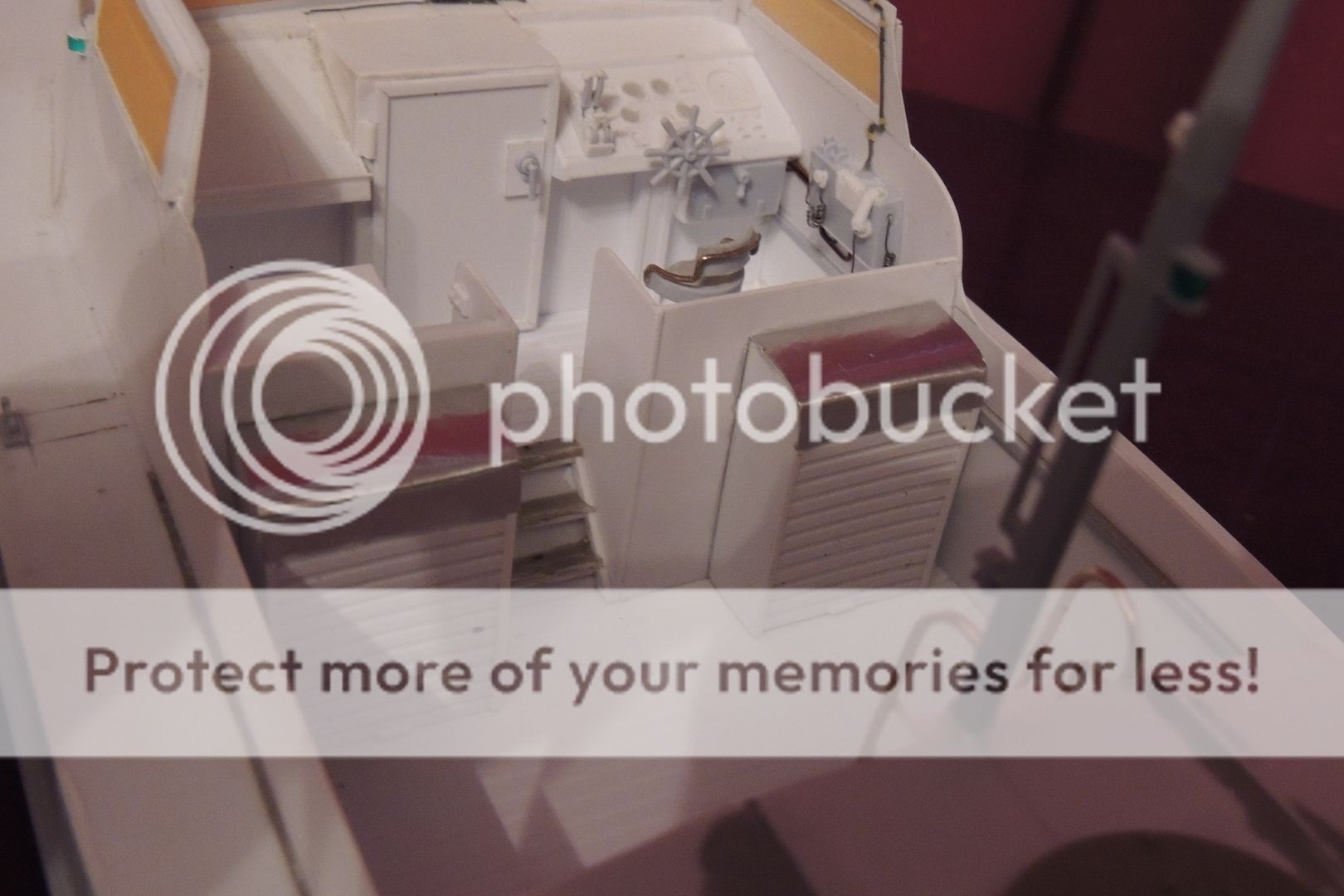

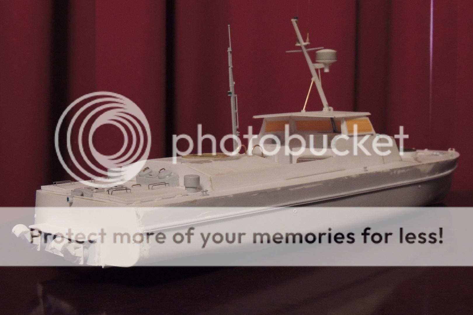

Well, the boat is finished ready to prime. Weapons are still to be built. Here are the pic's as of an hour ago.
The water-jets, canopy, ladder, pilot's seat & wheel are all loose-fitted for the photo's & will be painted & detailed seperately.
The greenish spots are liquid mask over clear parts (mostly handcrafted from clear sprue).
The cabinets behind the cockpit are .50-cal ammunition lockers, each sized to fit 16 x 200-rnd boxes. Microphone & R/T handset are handcrafted from styrene. Copper & various grades of lead wire used for the wiring.
Still have to make the anchors & fit the life-rings, extinguishers (after painting) ... plus the weapons.
Not sure if I should put exhaust outlets at the stern for the 2 x Ford 351 Windsor marine V8's or if they should exhaust through the water-jets. Suggestions?

Didn't PT boats exhaust into the water for quiet low speed ops? A lot of pleasure boat exhaust into the water.

PS: I went with a petrol engine because I couldn't find a suitable diesel from the late-60's early-70's time frame in my research, as I didn't think the 180 hp Detroit Diesel 6V53N engines of the PBR 31 were powerful enough for this beast. If any of you know of a suitable light marine diesel in about the 250 hp+ range I'd be happy to change.
Quote from: kerick on April 25, 2015, 09:16:04 PM
I've decided on the exhaust venting into the water-jet flow, between the props & the nozzle, so they're quiet & don't interfere with the functioning of the water jet, with ball-valves to stop any back flow.
