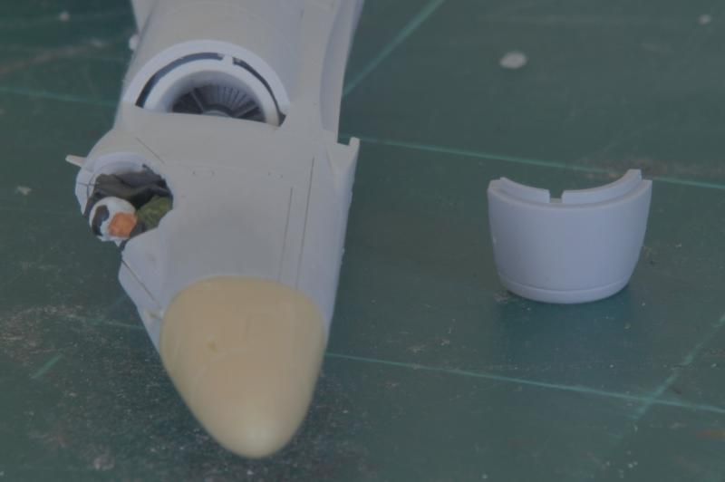

Okay, nose on:
That was surprisingly troublesome.
Firstly, when you cut the original nose off, you lose the front edge of the nosegear bay, which means there's very little to positively set the width of the fuselage, i.e. it can very easily crush in.
Secondly, I couldn't get the Freightdog nose to fit on straight. I carved off various bits of plastic and resin until I eventually sussed the problem. The nose gear well/cockpit floor project slightly beyond the panel line where you vut the original nose off. To accomodate this, the Freightdog nose has a recess in it's rear face, but unfortunately, the walls of this recess are way too thick and irregular, so they force the nose off-centre. The eventual solution was to carve the recess deeper and wider with a Dremmel until the walls were the same thickness as the kit fuselage. Even then it needed a bit of sanding, which was helped no end by the presence of the moulded-in hockey-stick aerial just in front of the windscreen.
The crack in the cockpit coaming keeps springing open no matter what I glue it with, so I'm going to wait unti the wing is glued in (which fixes the fuselage spacing) and then fill it. I also had to fill the panel line right at the tip of the A-4C nose which defines the smaller dielectric area seen on most of them. The line is perfectly correct, but I wanted the earlier, larger radome, because I'm going for the fibreglass-nose-on-white-fuse look of the Buccaneer S.1. I filled it with superglue (cheers Jon) and it sanded smooth very nicely.
With hindsight, the world's ONLY exact science, would it have been a better move to install the wings first to fix the fuselage spacing and then do the basal work?

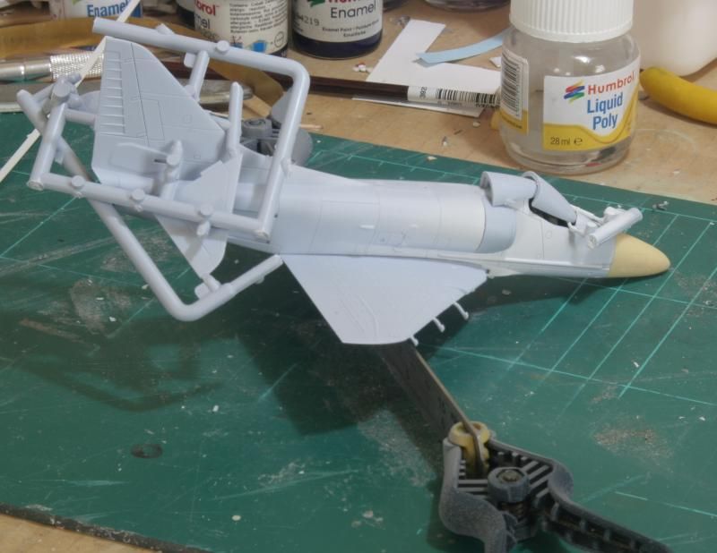

The intakes:
First off, these are numbered wrongly on the instructions, with left and right numbers exchanged. Next, there is no way the intake location lips would fit between the fuselage and the trunking without carving a whole lot of material off both. Lastly, the joint line between the intake and the fuselage comes out too big because the two faces are not at the same angle - more fettling.

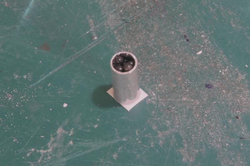

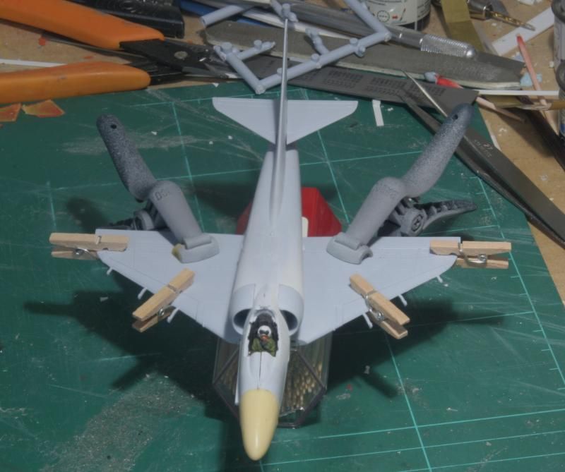

I wanted to find out if it needed extra weight before fitting the wing, since the lower wing covers the only place to add it (behind the cockpit, since the new nose is solid. This required the use of my super-high tech computerized laser balancing as follows:
Inclining trials on an aeroplane eh? Well it is a Navy aeroplane.....  ;)
As a result of the inclining trials, I decided that it needed a little more weight behind the cockpit, but not as far as filling the whole compartment, and I was also worried about PVA seeping through the gaps at the corners of the cockpit bulkhead, so I made a ballast bucket and stuck it in place with a load of sprue:

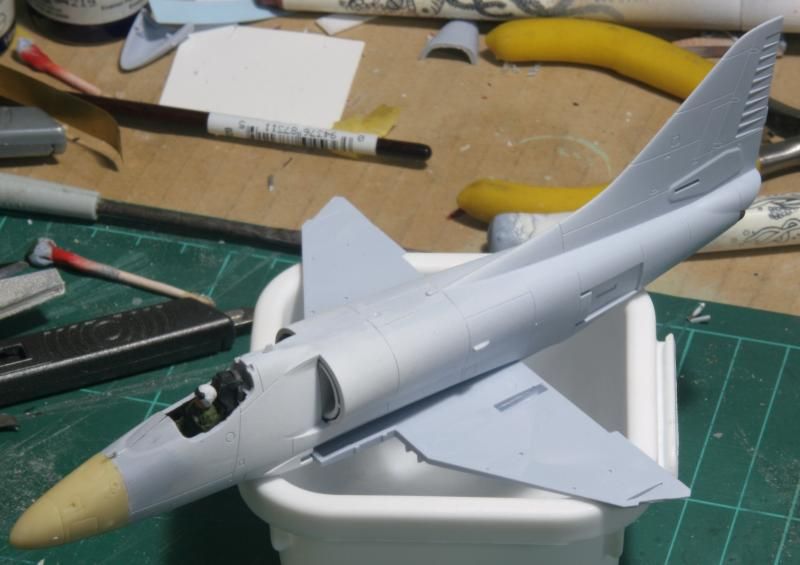

Wings and tailplanes are now on:
Looking good. Sorry to hear about the troubles, but that's half of the fun eh ? Looks like she took a hard landing in the pic  :thumbsup:
Coming along nicely that cockpit coaming is a common problem as the cockpit is a little tight on tolerance to say the least. I reacall filling mine once it was assembled as it just wouldn't stay together.
