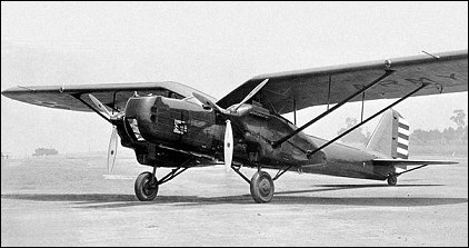

Can't find a "Boeing B-7 Valkyrie II" when I do a Google search.  Are you sure you didn't mean the Douglas B-7?
