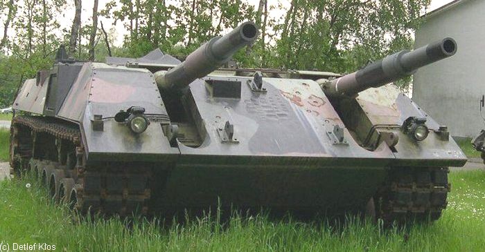

In battle, the amount of dust and other crap that is thrown up at the end of the barrel is quite large and that has to clear before you can acquire or reacquire your target.   The Germans in the 1980s experimented with several leopard based hulls which carried twin 105mm or 120mm guns which were fixed in a casement structure.  They placed them on the outer edges of their vehicle to try and provide some way of minimising the obscuration which occurred on firing.  This was known as the "Leopard 3" but was primarily a defensive weapon (being fixed) and considered sub-optimum for the advance.  Something NATO had realised when it experimented with the Strv-103 back in the early 1970s.   As NATO was committed to defend and retake German territory in case of a Soviet attack, doctrinally they were opposed to the adoption of such a vehicle.   However the Cold War ended before a decision had to be reached on whether to adopt it or not.
