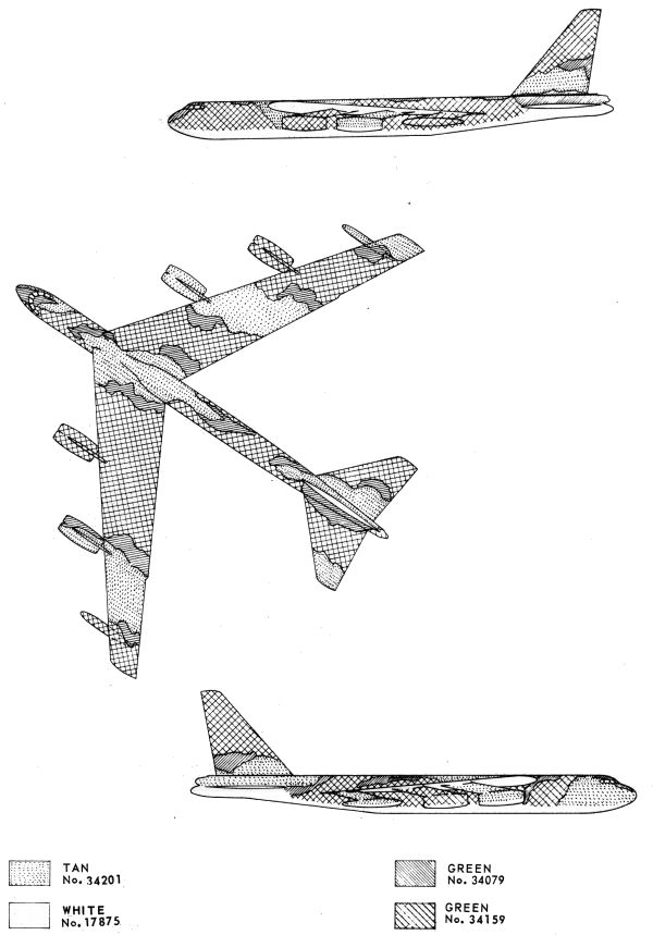

I Goggled "desert pink" and got this.
Which probably isn't much help.
