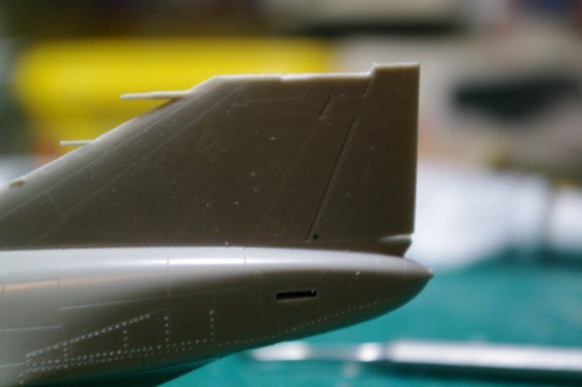

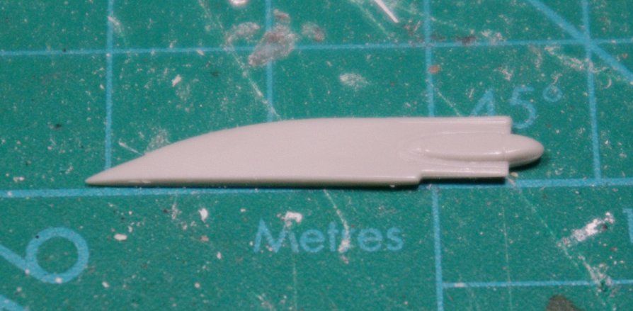

Started a bit of work on the F-4L. Removed the forward RWR from a spare Hasegawa fin top so that I can replace what is fitted to the kit. I have also removed the appropriate amount of plastic from my previous F-4M. Various parts of plastic have also been removed which had been applied where the attempt to join an RF-4 nose/cockpit area had found a large gap, the original nose and cockpit are being reattached so the additional plastic is no longer required. It's not a huge amount of work but it is a start. Next will be painting the instrement panels which are a bit of a mess at the moment then I can get the cockpit shut and I can look at adding the RWR to the intake trunking.
The construction and destruction has begun in earnest.
First the modified fin cap
Then the modified fin
And then a modified under fuselage area  :banghead:
