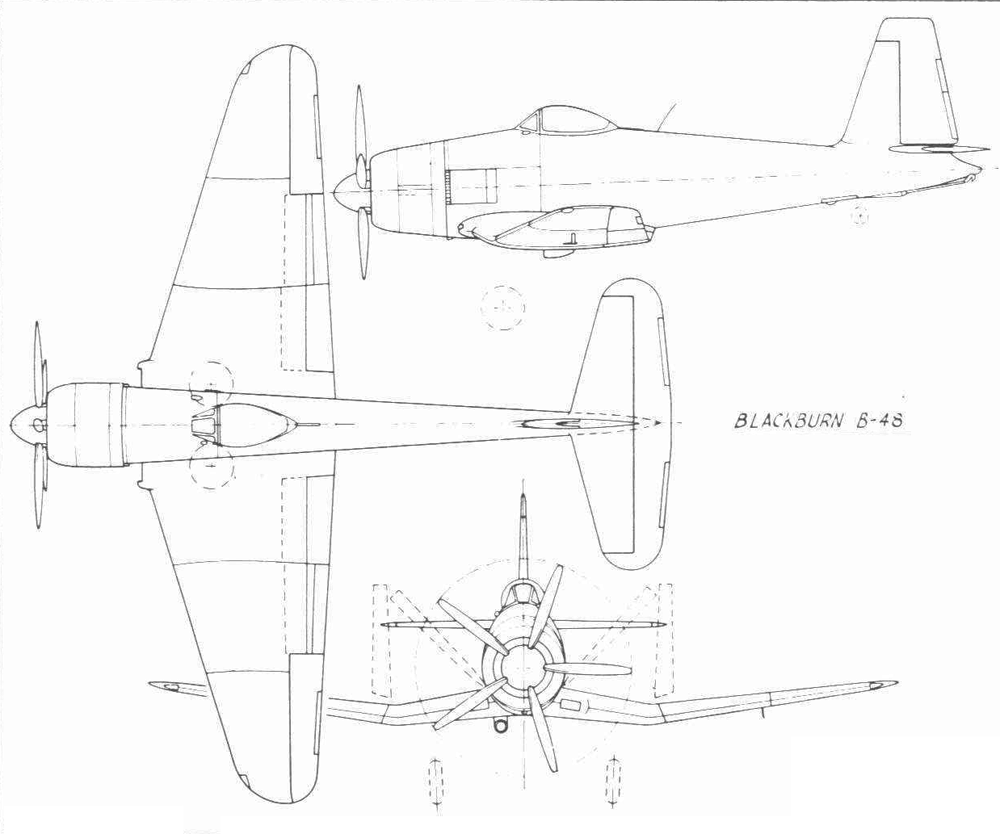

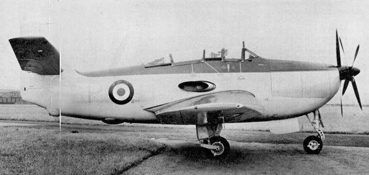

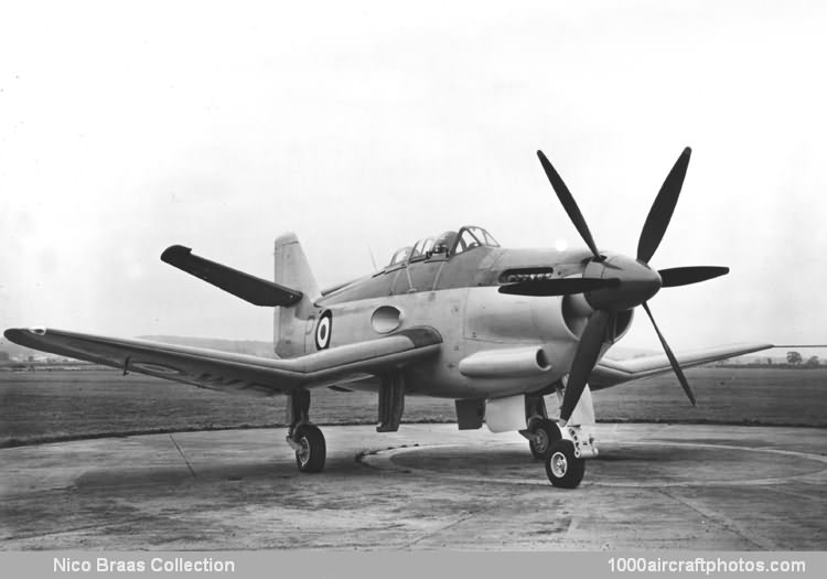

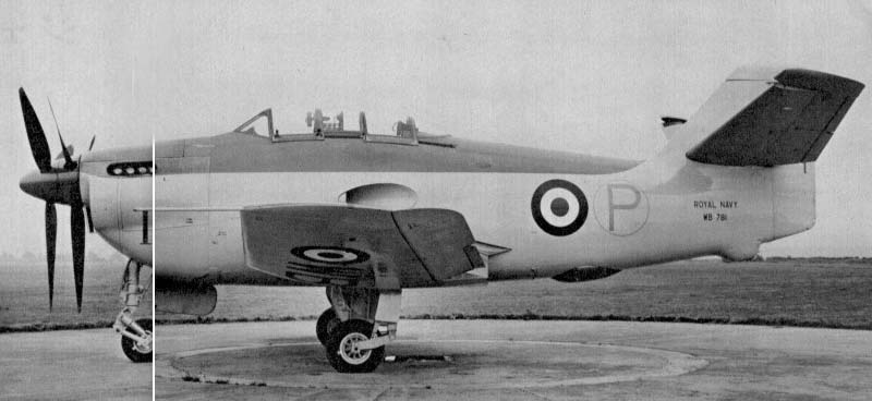

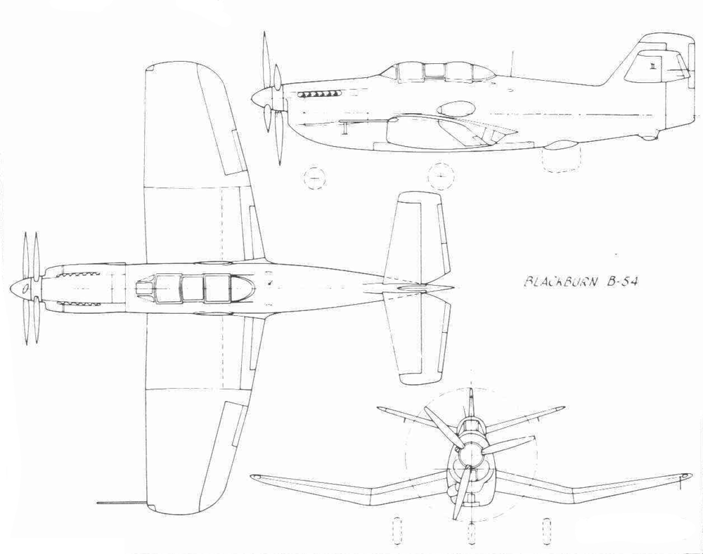

Also, the Gannet pilot sat on top of the two slim turbine engines, whereas a big radial would have to go all in front of him. Big changes to not only nose contours but also CofG.
However the Gannet evolved from late-WWII strike-fighter designs that had two Merlin/Griffon engines: one underneath the pilot driving the gearbox directly and one behind him driving it via a shaft. You could possibly "de-evolve" a Gannet kit to that kind of configuration.
The Gannet's competitor was the Blackburn B-54.
The two prototypes were Griffon 56 powered, another was to be powered by a twinned Napier Naiad
powerplant, this didn't work out so it was built with Double Mamba as the B-88.
Griffon 56
Double Mamba
http://www.airwar.ru/enc/sea/b88.html

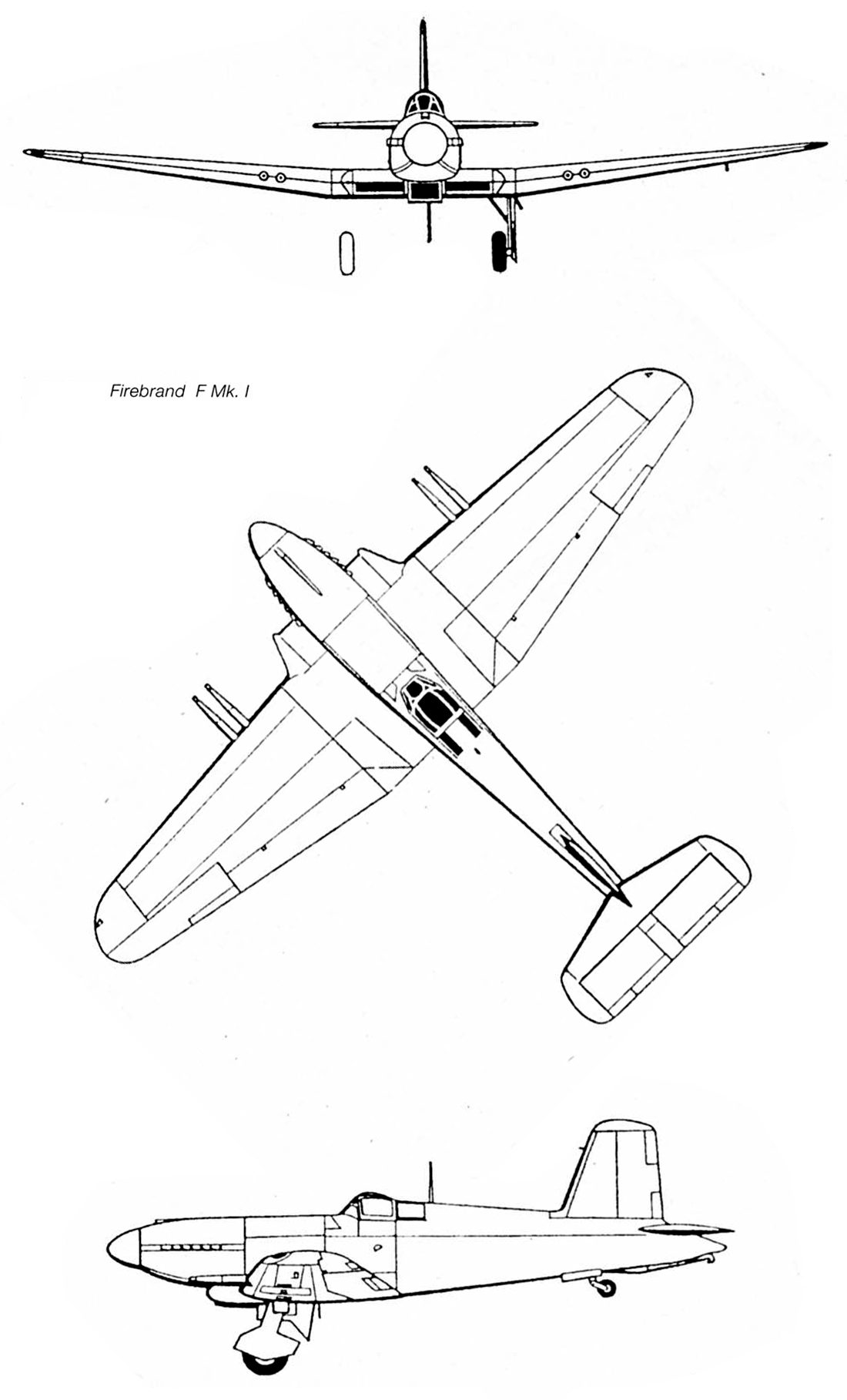

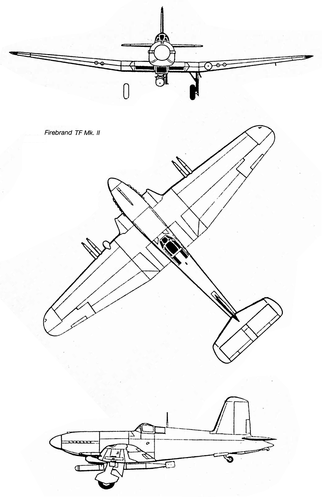

The Blackburn B-48 Firecrest was largely based on the preceding B-37/B-45/B-46 Firebrand, and
was a downsize of the basic concept. Studies for turbo-prop conversions of the B-48 led into the B-54/B-88
development. The Firebrand itself under went a change of Griffon to Centaurus.
http://www.airwar.ru/enc/fighter/fbrand.html
http://www.airwar.ru/enc/fighter/fcrest.html
