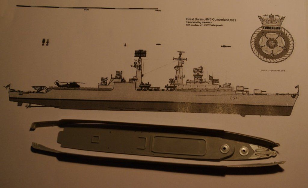

Pity that my favourite disc blade for my mini drill has become bent since I last used it, however that does mean that the medium sized disc is nice and sharp so cutting the lower hull away was no problem at all.
More to come though no idea how fast or how often.
Thanks for the tip.....I need to fix my dremmel and saw off some hulls myself !

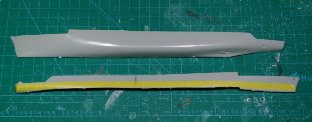

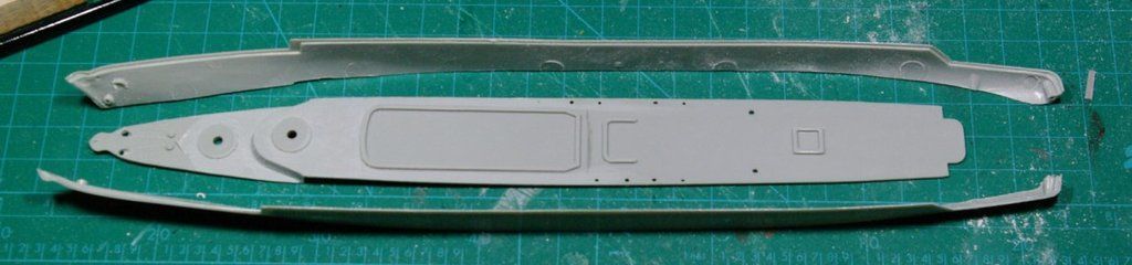

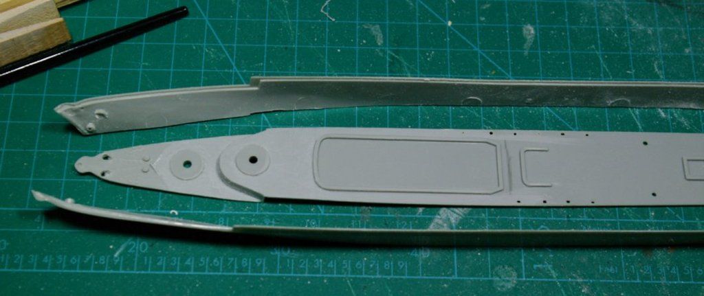

The three main parts have now been brought to a basic stage where more detailed and delicate work car be carried out.
The lower edge of the hulls are now smooth and almost level, I need to repair where the old disc saw took too big a bite out of the hull but I will worry about that later.
One of the hardest things to do will to make sure that the waterline part of the ship stays exactly where I want it, perhaps a couple of sheets of plastic card as a base for the hull to sit on when I have finished her?
In the meantime more surgery to stretch the hull at the stern and midships.
Not sure how to actually achieve the addition to the hull width. Do I add a strip of 0.02" plastic card to the outside of both sides of the deck or to the inside of the each hull side? At the moment I am favouring the latter as midships the hull sides are vertical so I can use L shaped plastic rod to provide a lip for the deck though this method will not be possible nearer the bow or stern so perhaps a combination of the two?  :blink: :banghead:

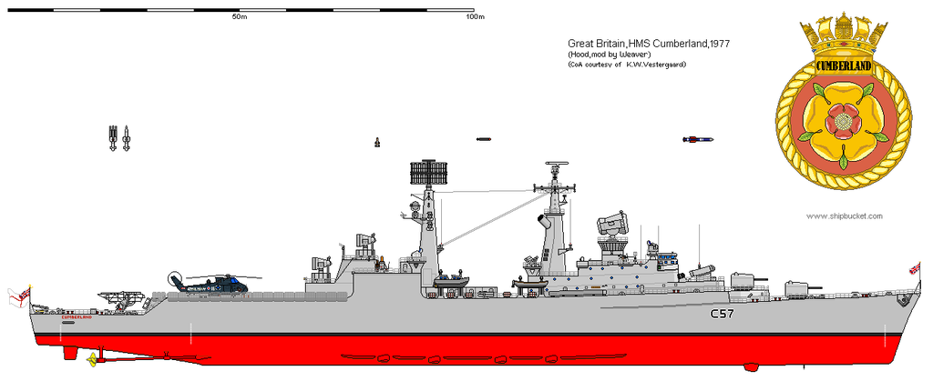

Here is a picture of where the model is at the moment, next to a set of drawings that has been scaled to the correct size, at least I think it's close enough.

Gondor, as a member of the forum that the original drawing came from the scale that we use is 2 pixels = 1 ft, that should help you scale correctly :)
Quote from: nighthunter on January 22, 2016, 09:28:10 AM
That's no help at all as its difficult to know how big the pixels are when the drawing is printed out. I am simply using good old fashioned maths and a ruler to scale everything.
