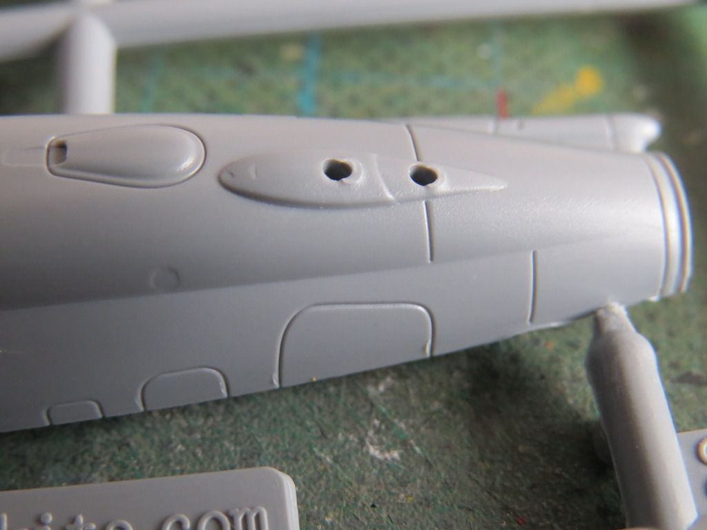

The tail feathers. With a small amount of modification both to the F1's fuselage and the Trainer's tailplanes they can fit very nicely.
A little bit of trimming to the F1's fuselage top and with the trainer's fin just cut off, a straight butt joint is possible.
The fuselage before trimming.
...and after trimming.
Now the tailplanes. The modified one is on the left.
...and the tail feathers in place.

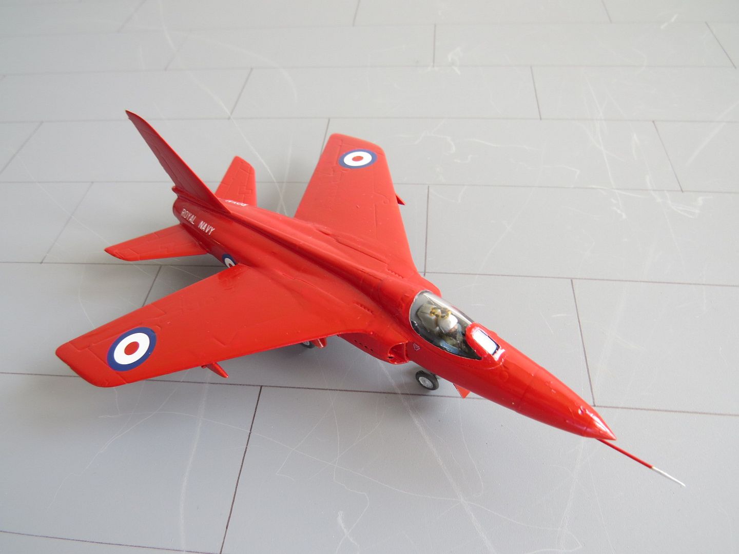

Folland Sea Gnat FB3
In the 1950's The Royal Navy Fleet Air Arm selected the Folland Sea Gnat as it's standard day fighter. The F1 was the initial production version, the F2 was an improved version both these versions being pure fighters. The next step in the evolution of the design was to introduce a ground attack capability and so the FB3 was born and it became the first version in widespread use with the Fleet Air Arm and also achieved considerable export success.
In the late 1950's the Fleet Air Arm's 738 (Training) Squadron, equipped with FB3s, decided to form an aerobatic team, flying a formation of 7 aircraft. To make them even more spectacular the aircraft were painted overall red.
The team only remained in existence for one season but in that year they did perform at the Farnborough Air Show.
While no records survive as to the individual airframe identities study of photographs suggest that one aircraft may have been WM999.
