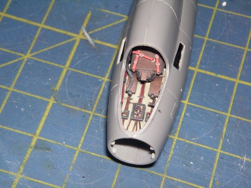

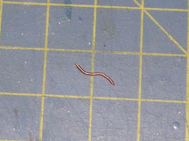

Just before buttoning up the fuse I realized I'd forgotten an O2 hose so I made one from fine copper wire wound around a thicker gauge wire.
Well, there!

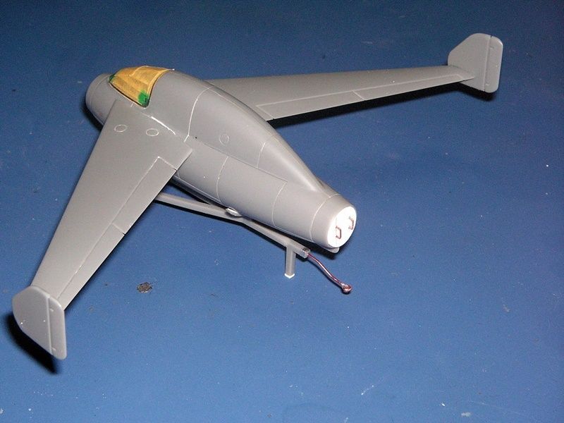

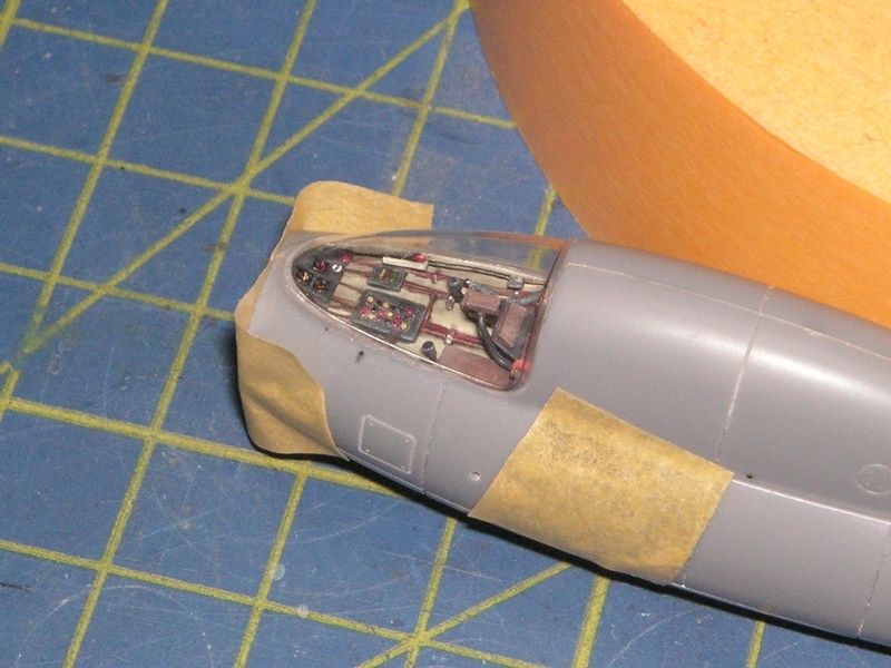

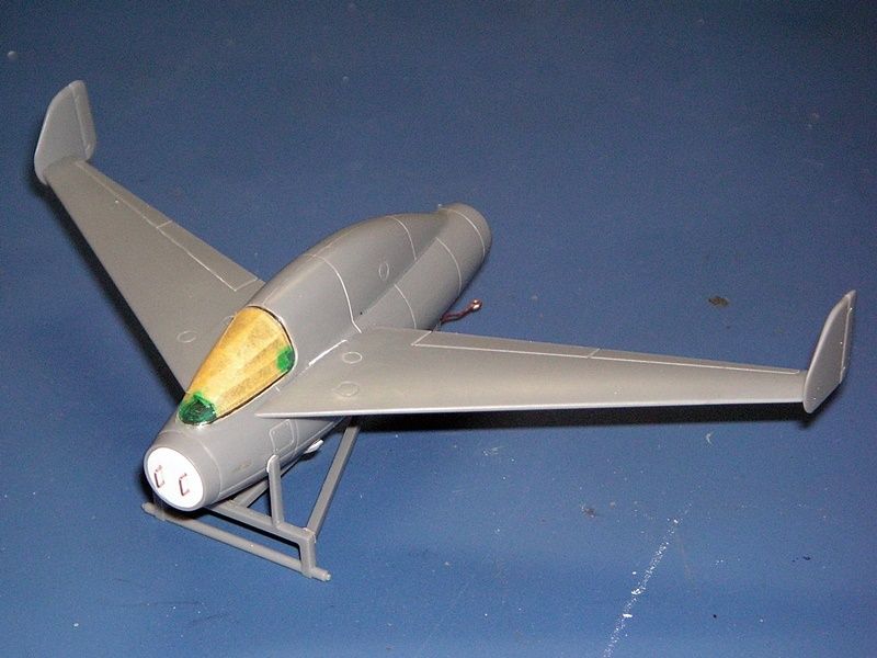

The canpoy was attached with liquid cement, a good, airtight joint. You can see on the pic how well you can see the cockpit detail.

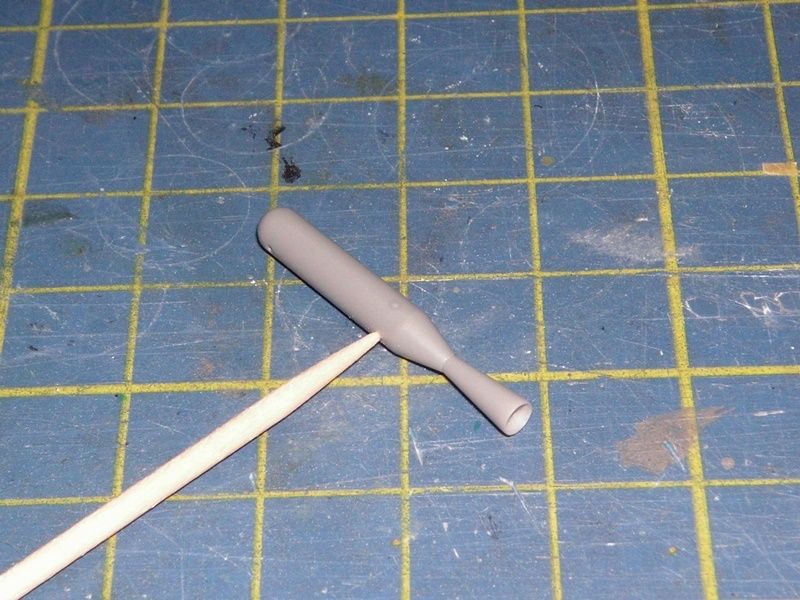

Now it was time to turn to the exterior details and stuff, starting with the rocket boosters.

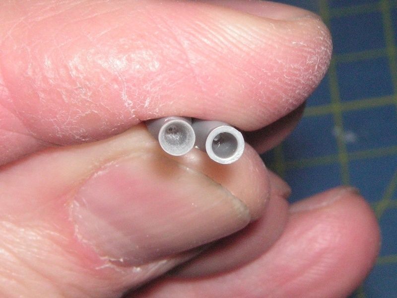

The exhaust lips were thinned to scale and we're good to go!
BTW, the Japanese RATOGs weren't very reliable. They had plenty of trouble fine-tuning them. One can only imagine what would have happened if the placement was slightly off-axis or if there was a lag in ignition time...

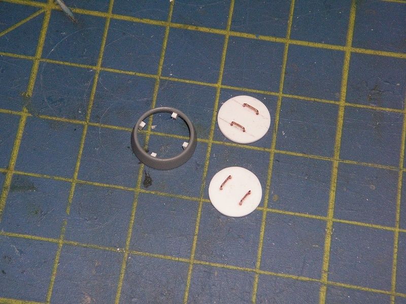

Next the FOD covers: simple styrene discs with copper wire grab handles. I glued some supports on the inside of the intake and exhaust so that when the covers are put in place at the end of the build they don't fall into the fuse with no way of retrieving them...

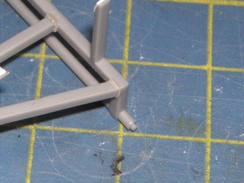

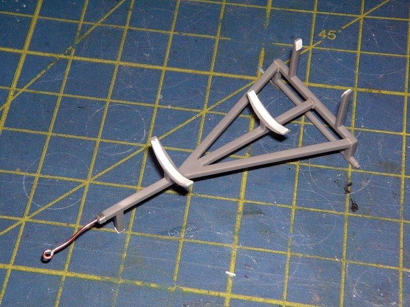

The trolley was detailed somewhat with rubber cushions, a lunette ring and weld seams (made from stretched sprue softened with liquid cement and shaped with a sharp blade) where there were unsightly gaps.

I'm just about to make a couple of FOD covers myself, although they are an elliptical shape. I was wondering about the handles, was going to use staples, might now get some copper wire to at least attempt it.
Thanks NARSES2.
Staples, hmmm... Never thought of that. That may work if you want flat section grab handles and if the staple is the exact shape you want the handles to be. Otherwise flattening them and rebending them might be a problem as you might not be able to easily get the kinks out. Round section wire on the other hand is easy to straighten out by rolling it between two flat shapes. Bending is easy too, like you bend PE. And if you get it wrong just straighten it out again and try again. Copper is very soft and nice to work with.
