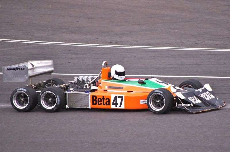

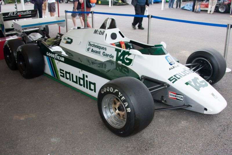

But in Tyrell's case they didn't have to drive the dual wheels as well. March and Williams did, but then theirs didn't have to steer too.
I think Max's idea is unique (but I have no doubt that someone will be searching the net to prove me wrong........ )
March 2-4-0 F1 car (pic by David Merrett)
Williams FW08B F1 car (pic from Ultimatecars site)
