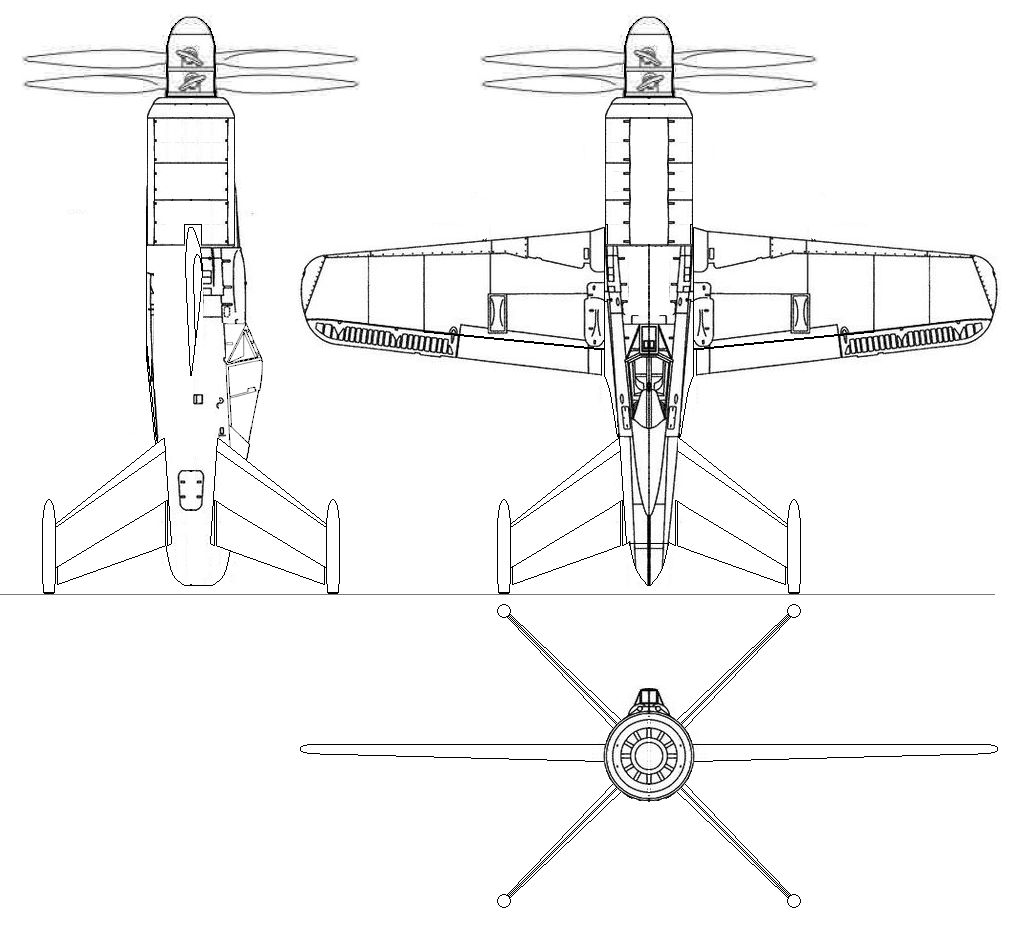

Well, several days ago I stumbled across this artwork:
More here: http://www.whatifmodelers.com/index.php/topic,39500.255.html
Fascinating, to say the least.  :wub: And since I just finished the converted Étendard IVS for the In The NAvy GB and wait for decals for another project, I use the time to take this concept to the hardware stage.
Basis is a Hobby Boss Fw 190 D-9, because I found one in the pile, it's massive and the tail extension offers some more material to work with.
Tail surfaces will come from two MiG-21 kits, extended cowling (in my world with a BMW 803 inside) will be bashed/sculpted, the contraprop will come from a vintage 1:100 Tu-20/95 bomber from VEB Plasticart.
Wonder if I can add small wheels to the four fin tip pods? And I am not certain what and where to put ordnance - I might end wing tip pods, either with guns or pack with unguided R4M rockets. The latter appears more suitable.
Stay tuned.
Quote from: Dizzyfugu on June 08, 2016, 06:37:29 AM
Lockheed did exactly that with the landing gear, some 5-10 years later, but they had 2 x 20 mm cannon in their wingtip pods, or at least they intended to anyway.
Yup, I am aware of that - and it's IMHO the only option. But this Fw 190 thing will be much more compact than the Lockheed XFV - I like the small size and the purposeful look of the drawing a lot!  :wacko:
Do both ... sort of. ;)
Scrap the cowl guns (too difficult to synchronise through contraprops), put in wing cannon just outboard of the prop arc & rocket pods on the wingtips. :thumbsup:
Re: the landing gear; wheels are the best option (though they'd need brakes to stop her rolling away on landing/take-off) but pads are almost as good. :-\
Be fun watching this come together! ;D
Quote from: Old Wombat on June 08, 2016, 07:41:39 AM
This has already been done, together with the bulges and barrels of the wing root guns. I just have to check the relative new wing gun position to the new and bigger propeller arc. They could end up very far outboard, so I might avoid internal guns completely and move everything to wing tip pods as on the XFV. Underwing gun fairings are another option, though, I have a pair of twin-MG 151/20 pods from an Academy Fw 190 A/F as options.  ;D
Wheels will have to be improvised/scratched, and due to their little size this could become challenging... But pads appear too simple - how would you move this thing around on the ground?
Another option (has to be checked when the fuselage is ready to take the fins) is a single, large wheel in the tail section, plus four "outrigger" wheels? Would certainly make sense concerning weight distribution and the rigidity of the fins?
Anyway, this is so sick and Luft '46 as it can get, I enjoy the challenge of building it!
Quote from: Dizzyfugu on June 08, 2016, 07:50:46 AM
The KP (Kaypro) Convair Pogo has a set of such small wheels and the kit is lot easier to come by than the Valom Lockheed XFV-1.
The single centre wheel plus four outriggers was one alternative suggested for the Northrop N63 but they decided on a collapsible rear fuselage instead........  :unsure:
Quote from: PR19_Kit on June 08, 2016, 08:48:53 AM
I have both in the stash, but do not dare transplantations.  ;)
The single centre wheel plus four outriggers would fit because the cut-off fuselage end looks a little strange?
