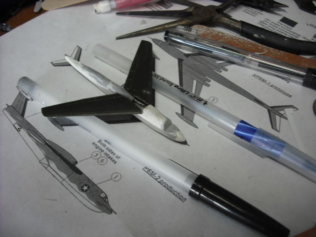

On to the air wing.  Will scratch 2 more SeaMasters up. The gray SeaMaster was from a previous USS Currituck/SeaMaster tender build.   Use a 1/350 S-3 Viking for the cockpit and nose, and F/A-18E rear fuselages for the wing mounted engine nacelles.
From my earlier assembly line
