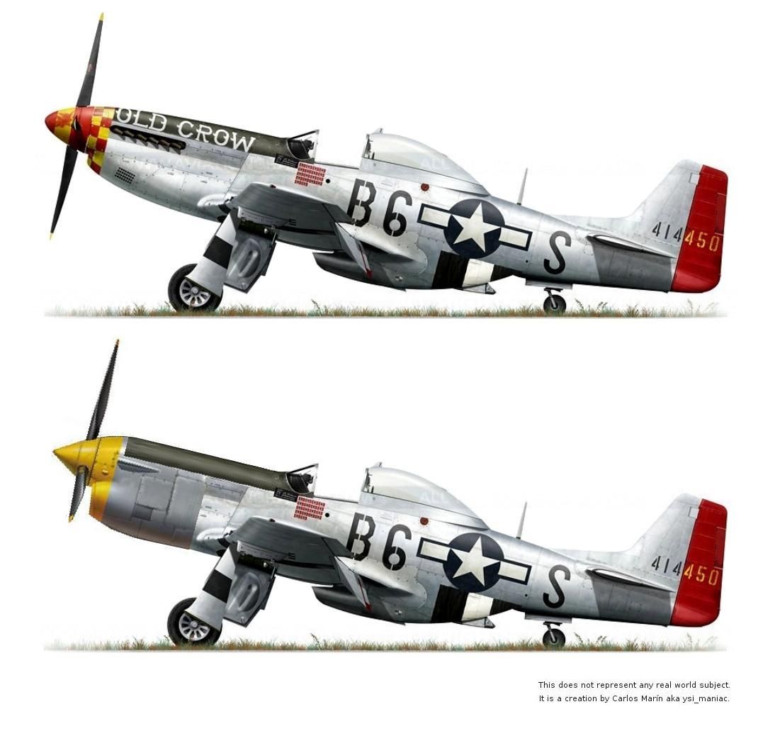

Reengining Mustang with turbocharged Allison, taken from P-38J.
Air21
The P-80 nose was actually a P-38 nose.  Lockheed used the same jigs and tooling to save development time.
In case that's useful for sourcing parts, it looks like the P-38 nacelle isn't as long in the back however.
Yeah, OK Carlos, but where is the turbosupercharger?
Sorry dude, a turboed P-51 would not use the oil-cooler/intercooler
assembly of the P-38J nacelle.
Why not? Can you explain your proposal.
Quote from: ysi_maniac on October 12, 2018, 10:05:00 PM
Because the intercooler on the V1650 Merlin used in the Mustang is located at
the rear of the engine, ditto the Allison used on the F-82. The big question is:
where do you put the turbosupercharger? There is limited room in the airframe
and you have the issue of the exhaust ducting to the turbine side of the
turbosupercharger. The run of the duct should be as straight as possible,
with any required bends as low a radius as possible. Go research
turbosuperchargers and installations and you'll see the issues involved.
