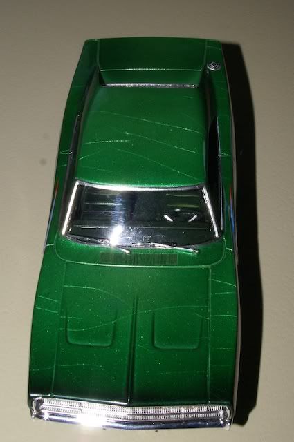

This looked great for a few weeks and then...
The problem was automotive lacquer clear over enamels.  The enamel continued to gas out under the clear cracking it.
That's nutty right there! Yes, I agree, I'd MUCH rather notice the problem as it happens... that sucks, that looks like a sharp auto.  Charger?
