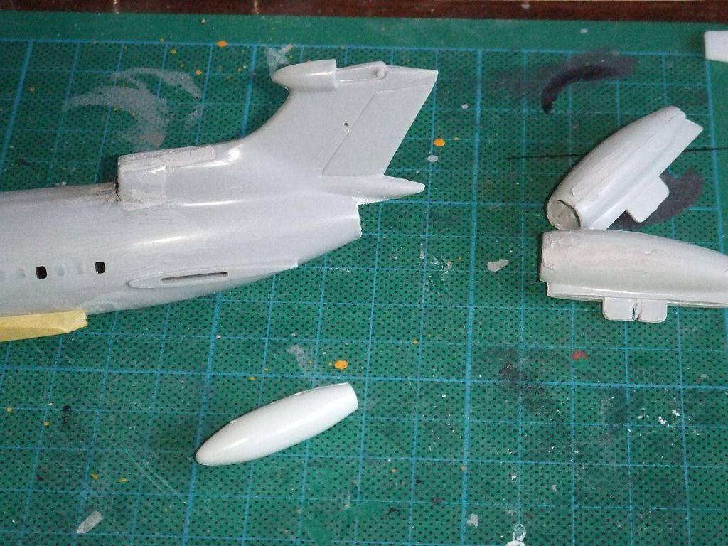

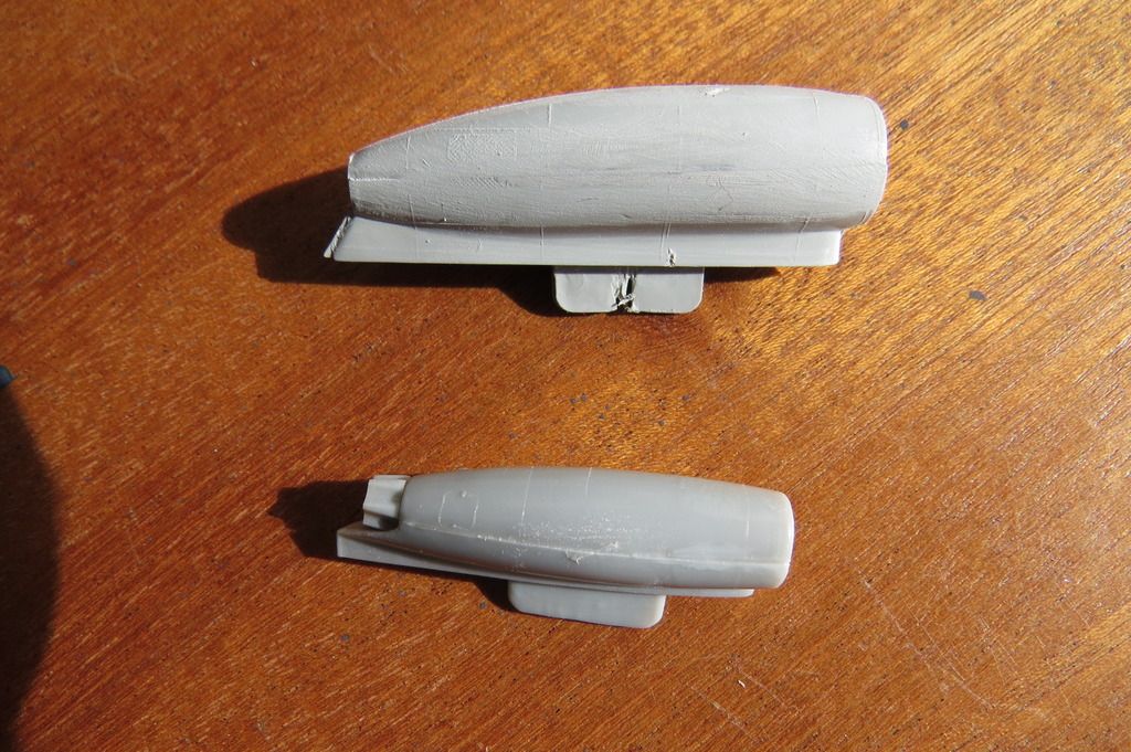

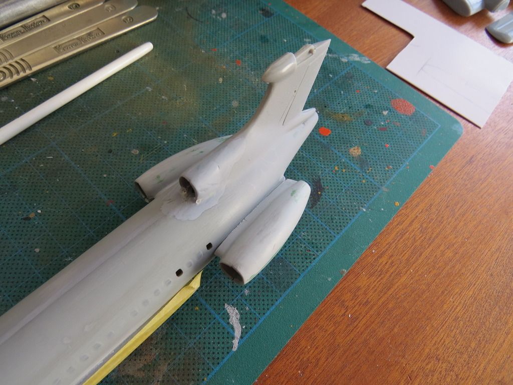

The first move was to up-engine it. For this I used the Conway pods from the VC-10 AEW5. The inner engines and the outer ones being cut along the middle, then the two halves being joined together to give single Conways. Then the task of PSR which I confess has delayed this model for a LONG time. I just could not face it.

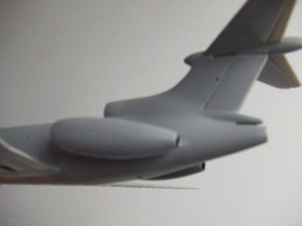

That shot really shows the difference in size between the Spey and the Conway.

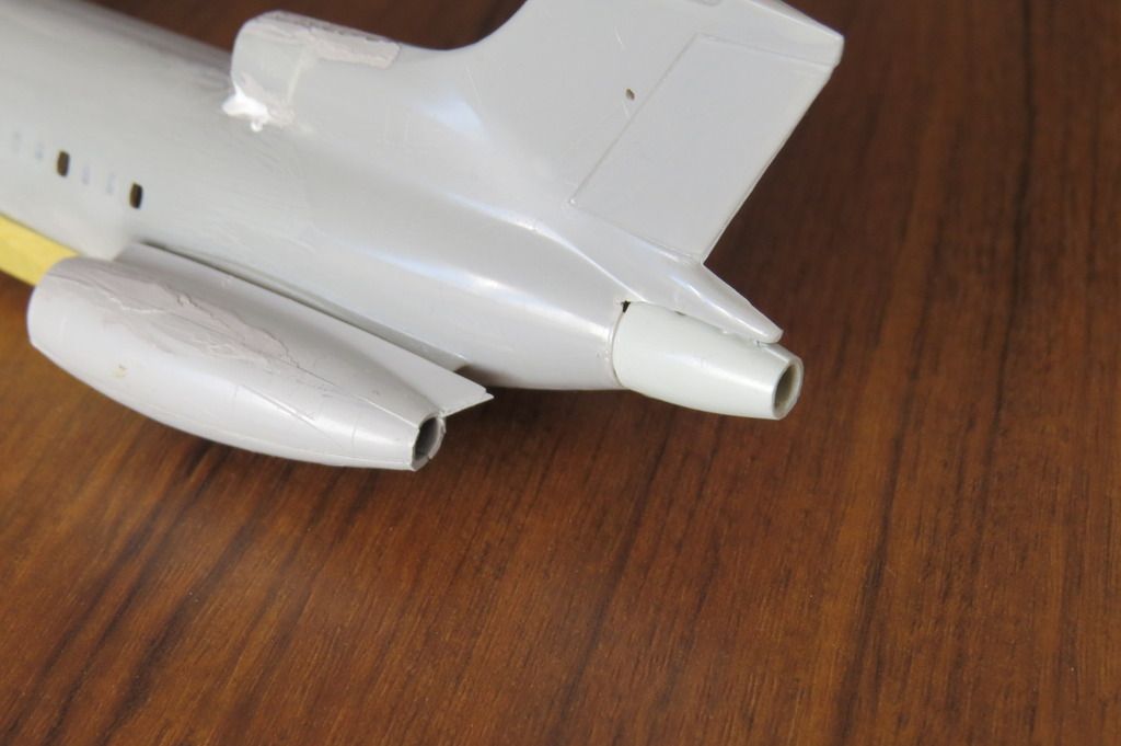

The tail pipe for the No.2 Conway was enlarged with a bit of a drop-tank, of indeterminate origin from the spares box.
I do not have any shots of how I enlarged the intake for the No.2 engine but it was done by cutting and splitting laterally, then PSR.

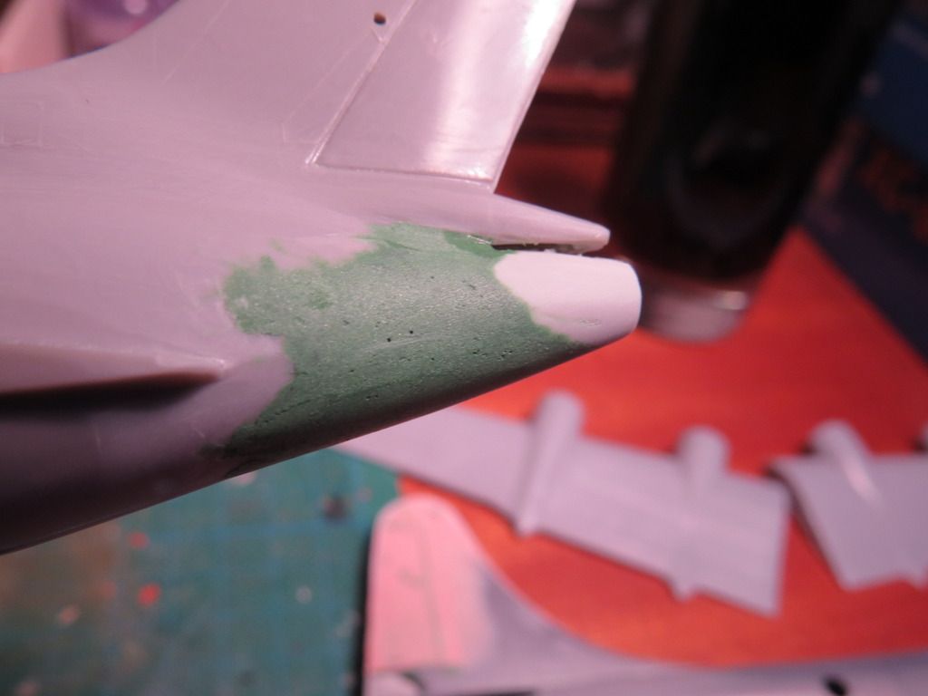

Eventually I got round to the PSR for the rear fuselage.

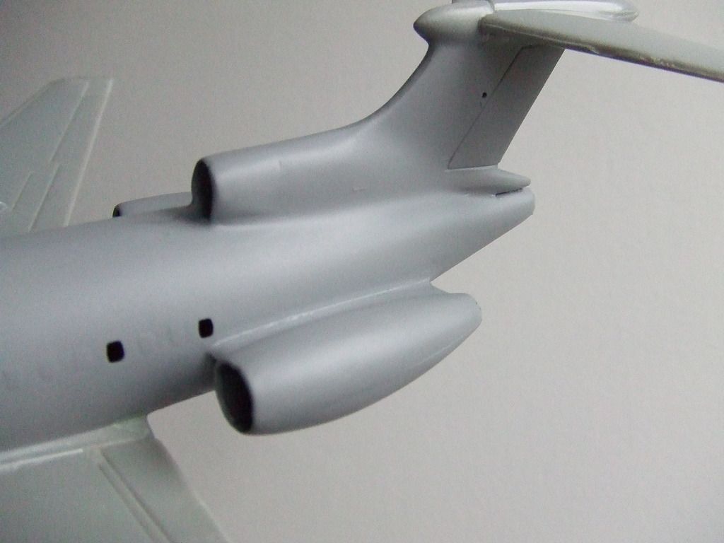

And this is how it looks now. My thoughts are that it has just a bit of a look of a Tu-134 about it.

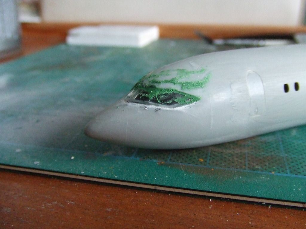

The cockpit transparencies in thes early Airfix Skyking kits has never been one of their best points, certainly not the fit. However this one was not too difficult to put into place. Yeh, it still did not fit well.
However I kept going and after a couple of days of trying to mask the windows I gave up. Have a look at photos of a Trident's cockpit windows, talk about straight lines. Forget it.
There is only one solution, which I personally do not like, but that is to fill it in and use a transfer for the windows. (Note to the less well educated : Transfer is the correct term for decals.)
Here is the nose with filer applied.

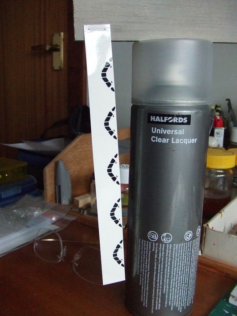

This is the home made transfers for the cockpit windows, waiting for the coat of varnish to dry.
