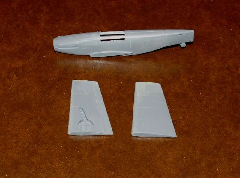

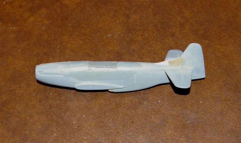

Making good progress on this, both wings are assembled and 'modified'  ;D and PSR'd too. I've joined the fuselage but left out the cockpit as you won't be able to see it with this version.  ;D
I didn't RTFM and left off the tailwheel, so then I had to UNdo the fuselage and insert it.  :banghead:
That tailwheel doesn't have any positive positioning and even after a few hours it doesn't want to stay down, so I dribbled a few drops of thin superglue into the tailwheel aperture. THAT fixed it.  :thumbsup:
The fuselage needed much more radical surgery than I anticipated so here's the required pics, along with the wings.
Yes, they're SHORTER!  ;D ;)

Attempt #2, all the Presto putty and the planked styrene strips were cut away and the open bay smoothed off (again....) and then I inserted the chunk of the sacrificial FROG Hunter's underside.
I'll wait till it's really hard and then try the Presto again.
Oh yes, you'll note the addition of a dorsal fin too, a common addition on Reno racers.
I'm feeling much better about this now as the PSR on the cockpit blank worked a treat. The Presto putty set hard and I've sanded it down to the shape I want now.  :thumbsup:

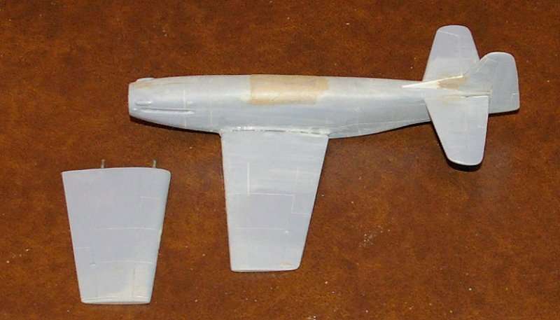

Because I don't trust those butt jointed wings I added two piano wire min-spars to each wing and drilled matching (sort of...) holes in the respective wing root as well. The port wing's now superglued in position and the starboard one is ready to glue. I used gel type glue with a hardener spray to fix the spars into the wing and then a touch of gel on the spars and liquid superglue for the joint itself. It'll need some serious PSR later on but it's very strong.
The wings do a look a bit short for one of my models, don't they? I must avoid this becoming a habit......  ;D
