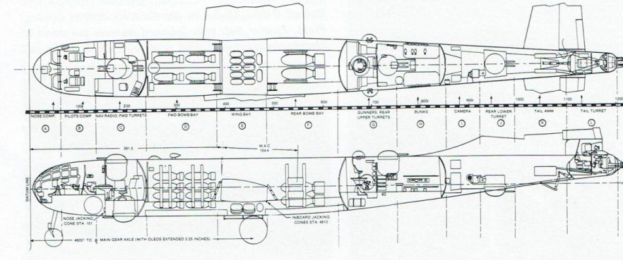

Yes you need nose weight. Its difficult to get enough into the airframe forward enough due to the glass nose. Start with adding weight around the nose wheel bay and behind the engines. Not much space where you really need it other than the bomb bays which you are having open so that's a no-go area weight as well.
Don't forget that the front upper turret needs to have some semblance of the workings hanging down inside the cabin. Doing so also gives somewhere to hide more weight.
I hope the above picture helps show you what I mean. Lots of people forget about the large "dustbin" like workings of the upper turrets which hang down into the crew spaces which for the forward one is a pity with all that glazing there.
