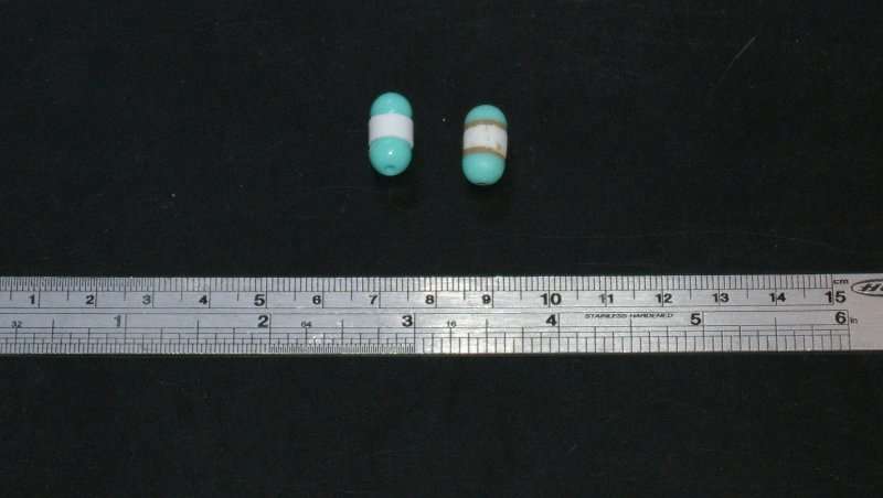

Having to do PSR on one of these tiny things is pure purgatory I can tell you, and the prototype will need at least three sessions I'm sure!  :banghead: Once I've applied a layer of putty I can't lay it down anywhere, so I have to do it each end at a time, so it's pretty time consuming. The 'construction phase' on the other hand takes only seconds, file the ends of the tube flat and at the right length, scrape a small taper in each end, apply superglue and jam the bead in the end. Job done.  :thumbsup:
Here's the first two, one PSR'd and one not, complete with a rule to show how small they are.

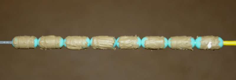

A mammoth session of sawing off little 5 mm lengths of styrene tube, threading them onto an aluminium rod interspersed with pairs of beads and then then first PSR session has produced eight more of the airbags for the trolley.
The 'air bag kebab' idea came from Brian Rickshaw on here, and it's an idea of pure genius. It made aligning the beads and tubes a doddle and makes the whole thing easier to handle. I'll have to hand sand each of them though as the rod isn't really stiff enough to chuck in a drill and use it like a lathe.
