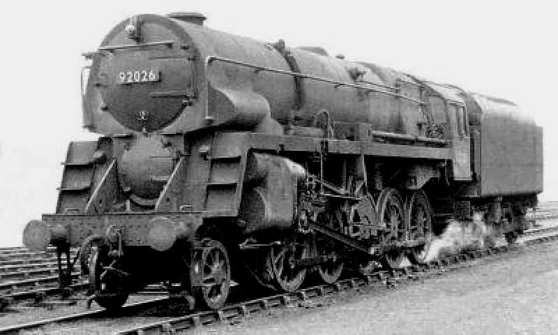

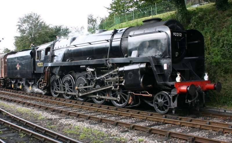

A standard 9F with normal chimney and smoke deflectors

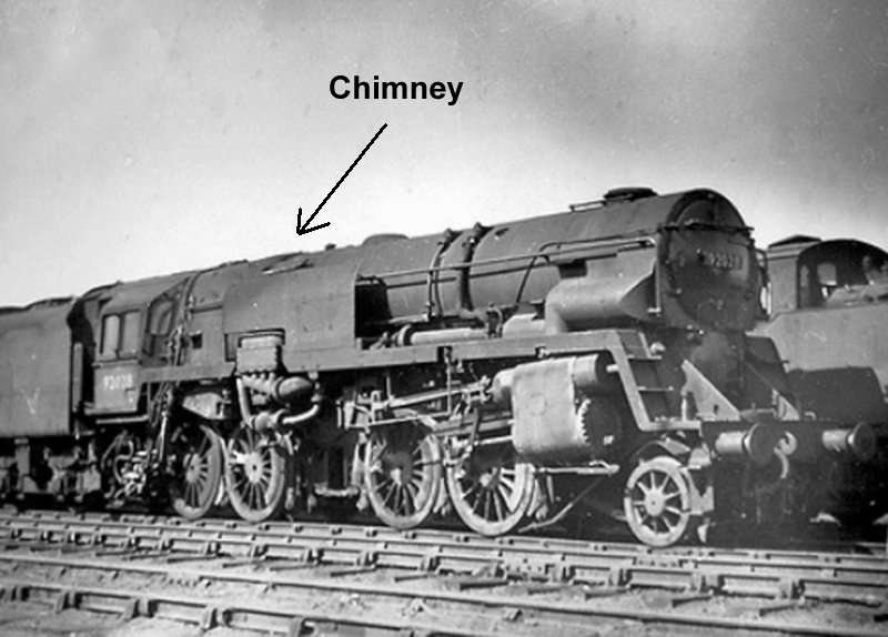

A later Crosti 9F, main chimney on the side and lighting up chimney in the normal place. No, I don't know why one driving wheel is missing......
The other side of a Crosti, showing the smoke box for the second boiler

Quote from: PR19_Kit on November 16, 2017, 03:00:11 PM
Looks like a fascinating build.  And drivetrain is missing on that side, so the drive wheel's probably off for maintenance/replacement.

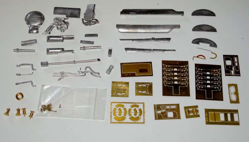

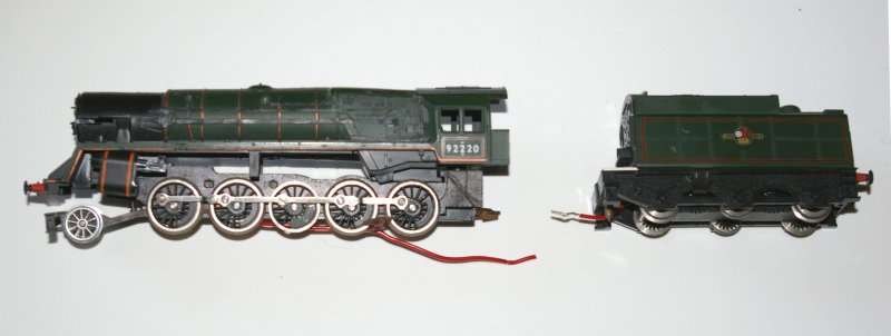

Here's some 'before' pics, and I'm already getting that 'bitten off more than I can chew' feeling.........  :o
I must have bought an extra detailing kit for a 9F too as there's LOTS more parts than are mentioned in the instructions. Good thing it's going to be a Whiff......

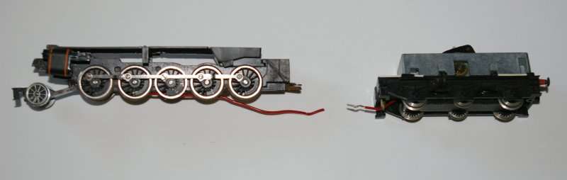

I'd already stripped off some of the detail parts, as well as the motion, but the boiler will look about the same eventually. The tender will become the later high capacity version as the bits are in the conversion kit anyway.
It's a tender drive loco as you can see, that was much easier in those days as the motors were larger, plus a 9F needs to show daylight under the boiler to look right.
All the bits and pieces, Crownline didn't skimp on their kits one bit. Most of the etch stuff is from the detailing kit, and the small plastic bag contains a zillion hand rail knobs!
