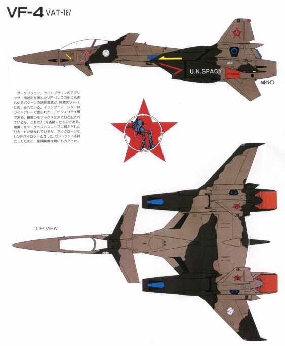

The original inspiration struck me with a VF-4 profile in the source book "This is animation special: Macross PLUS" from 1994, which accidently fell into my hands in a local Japanese book store. Among others, a side and top view profile of an aggressor VF-4 in an all-brown, Soviet-style paint scheme was featured:
At that time I found the idea and the scheme pretty cool, so much that I even built a modified 1:100 VF-1 as a ground attack aircraft in this paint scheme.  ;D

Thank you. I considered exteral ordnance, but I saw the VF-4's profile while mounted on its steel rod display - and it is utterly beautiful, at least from certain angles. It would be a shame to hang boxy stuff onto it, but, since you can build the kit in orbital flight mode, where extra missilles do not matter much, it's a potential option. And the Hasegawa weapon set for the VF-1 offers lots of authentic parts.  :lol:
As mentioned above, the livery is based on an official source book profile which I deem authentic and canonical. My aircraft depicts a different machine from VFT-127, though, since I could not 100% replicate the profile's machine, "13 Red". Especially the squadron's emblem on the fin would create massive problems.
For the two-tone wrap-around scheme I used Humbrol 72 (Khaki Drill) and 98 (Chocolate Brown), based on the printed colors in the source book where I found the scheme. The pattern is kept close to the benchmark profile, and, lacking an underside view, I just mirrored the upper scheme. The starboard side pattern was guesstimated. In order to add some color to the overall brown aircraft I decided to paint the missiles all around the hull in white with tan tips – in the profile, the appear to be integrated into the camouflage, what I found dubious.
