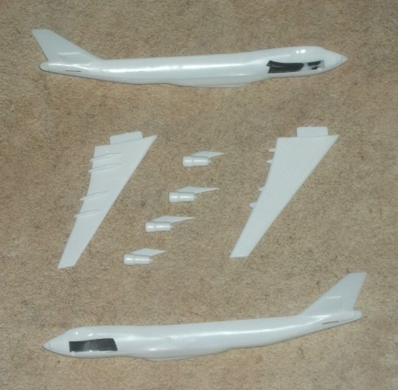

Well not a lot done, but we have forward movement. Wing halves glued together, engines halves glued together and front faces hollowed out (more work needed there.) Lead placed in fuselage halves and wings glued to fuselage halves
Will hopefully close the fuselage today, tidy up the join, add the tail-planes and SPRAYYYYYYYYYYY! (and pray as well!)  ;D

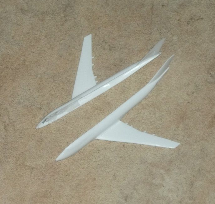

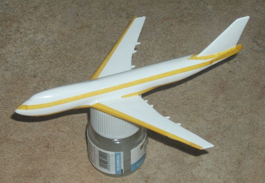

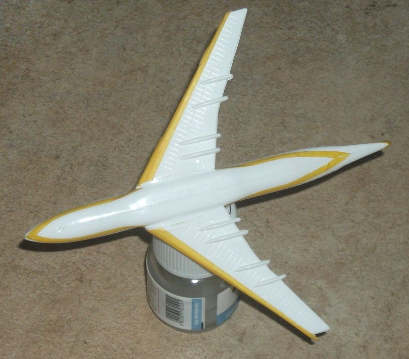

So I sprayed the fuselage and wings yesterday - probably too heavy handedly, but we'll see  :unsure:
Masking today, and a fairly good job by my standards I think ....but the bar is set pretty low there!  ;D
So if I follow what Weaver said here http://www.whatifmodellers.com/index.php/topic,45472.0.html I should now spray again with white, to seal and prevent and leaks with the red that I'm going to apply?
Anyway, with that quandary awaiting me - here's the work in progress pics. I didn't ake any pics pre-masking, I thought pictures of a white model spray plainted white was too boring, even for this threa ;Dd!
Oh to be whiffing again :-(
Quote from: Knightflyer on July 19, 2018, 05:43:36 AM
Yes. :thumbsup:
But make sure you've sealed down the tape as well as you possibly can first. ;)

I prefer to seal the edges of the tape with a light coating of a clear varnish applied with a brush, I use Tamiya Acrylic
Clear, it seals the tape and levels off/cures to an almost invisible seal. I use it under water-thinned acrylics, enamels,
and lacquers and it works equally well under all of them with no ill effects.

Hi Jon - thanks for the tip. I've already gone with Weaver's one this time, but I shall give yours a try next time. Main thing seems to be to ensure the edge of the masking tape is sealed in some way, before applying the final colour.

That's one of my favorite tricks and I can second the technique. I always just used the the same paint I had just got done using, though. Haven't tried using clear but I don't see any reason why it wouldn't work, I've just always wondered if it could somehow change the finish of the paint on top. I'd feel obligated to at least cover all of the exposed areas in case it did whereas with paint I can "cheat" sometimes I just get by painting along the tape edges instead of an entire coat.

Yup. I use this method at times as well. The key words are "light coating". Guess how I know ?  :rolleyes:

Unfortunately for me the terms "heavy-handed" and "applied by Knightflyer" tend to be  synonymous - Guess how I know!  :rolleyes: :banghead:

So, apply varnish along the tape?  Or actually bridging the edge of the tape and the exposed surface?
