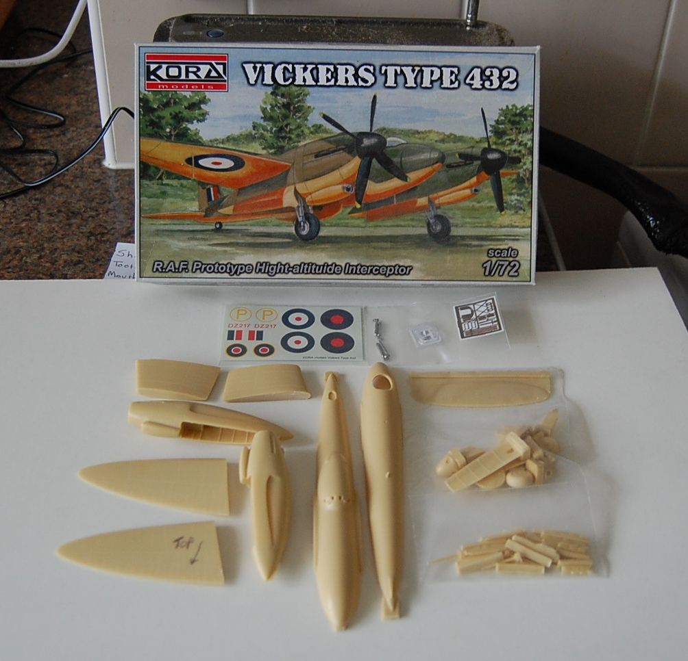

Whilst waiting for putty to dry on the Whirlwind I started to clean up the resin on this. Not much to do at all the mouldings are very clean out of the box. Just a little bit of work for my smallest razor saw and some sanding pads. Some parts are a bit heavy though and I may have to pin the wing fuselage joints, which given my inability to measure anything correctly and then transfer even vaguely similar measurements to another surface should be fun  :-\ Goes with my inability to cut anything like a straight/vertical line.

Do you find Araldite better to glue all-resin kits than superglue Chris?

I only use Araldite (the 5 minute epoxy) where I've got some large or heavy, or both, parts Kit. Otherwise it's good old £ Store super glue.
With this the two halves of the wings attach either side of what are rather heavy engine nacelles and then that assembly is glued to the fuselage. So both wings are a tad heavy. I think that's the way I'll tackle them anyway.
The fuselage is split horizontally for some reason and is quite thin and the upper half is very slightly bowed. So I'm going try warm water and/or a hair dryer on cool and then epoxy it in the middle where the two parts meet for probably 3/4 of its length and then tackle either end after that's set. Must remember to install the tail plane before gluing the fuselage as it nestles between the two halves.

Started work on this by tackling the interior. Kora's instructions are at best a very basic sketch showing part number 28 goes roughly here sort of thing, but they'll do as an aide-memoir.
Very little will be seen of the cockpit given the types small bubble canopy but I've used the rear bulkhead, floor and seat as supplied by Kora. Both the control column and instrument panel are on the included etch sheet (doesn't have something useful like seat belts though) so they have been replaced with styrene parts from the spares box, but I have used the etch peddles.
painting it latter and then gluing can commence.

Anyway work continues and the cockpit is just about done, needs some tape belts and that will be it. While taping the fuselage halves together to check it would still close over the cockpit I realised that the bowing of it meant that I could insert the tailplane after gluing the mid section, taking advantage of the bow, might be easier. I also noticed that the shape reminded me of one of the dolphin/false killer whales, but can't remember which one.
