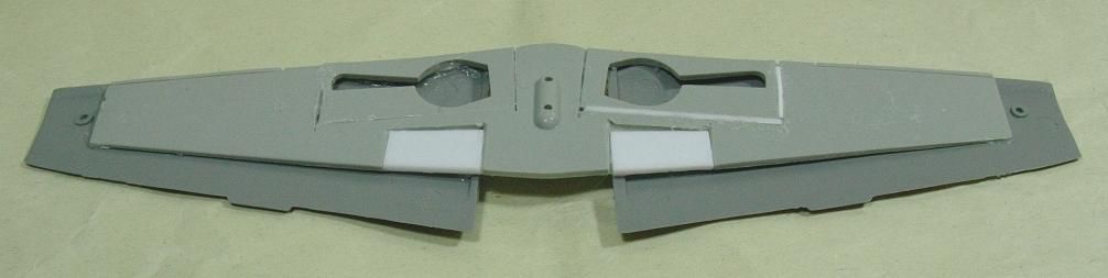

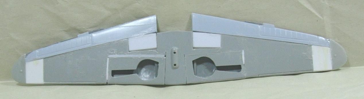

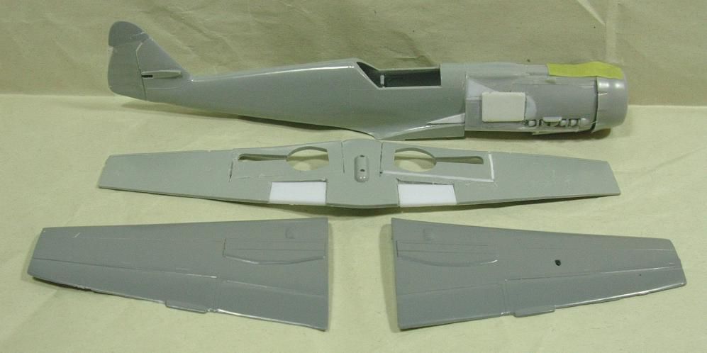

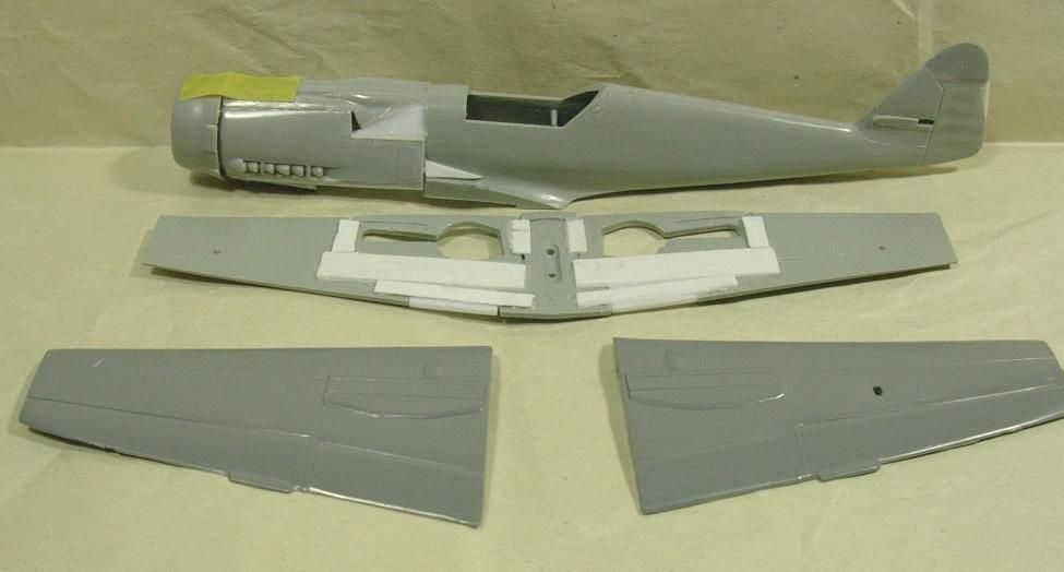

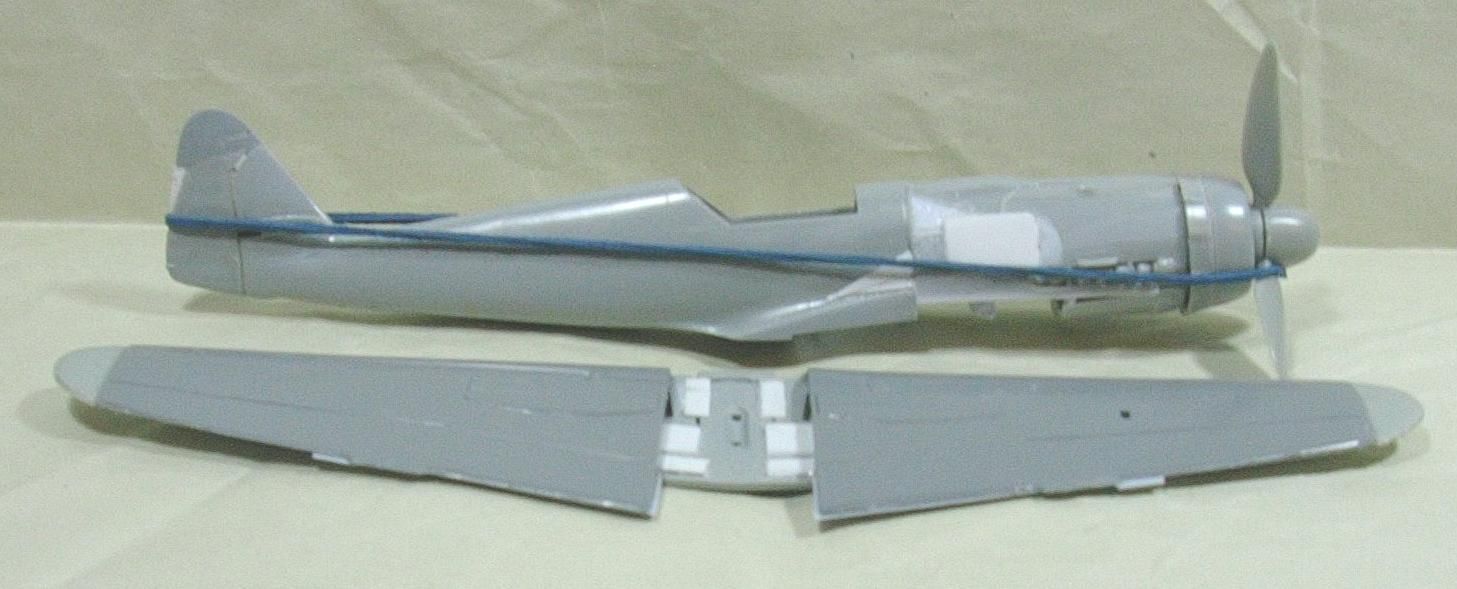

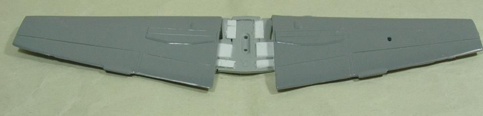

Inspired in Me-209 v5, this will be an intensive "junk" model
Aft fuselage and cockpit from Frog Bf-109F
Nose from Airfix Fw190D
Tail fin tip from Frog DH Hornet
Center and leading edge of lower half of wings from Frog Bf-109F. Trailing edge of lower half of wings will come from Airfix Yak-9D
Wheels wells has been swapped, respecting leading edge.
