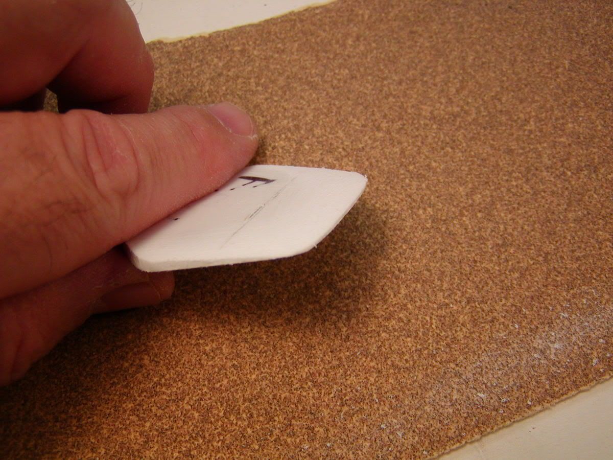

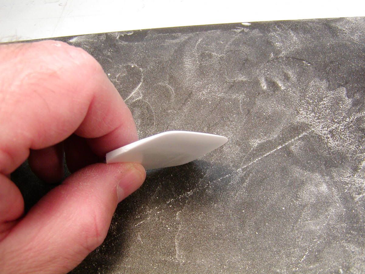

Hey, I moved onto WINGTIPS: so exciting (not!).  But had to be done.

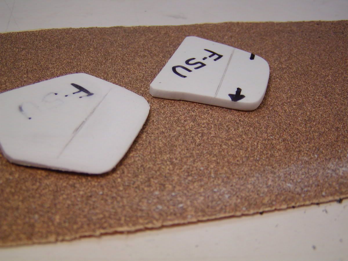

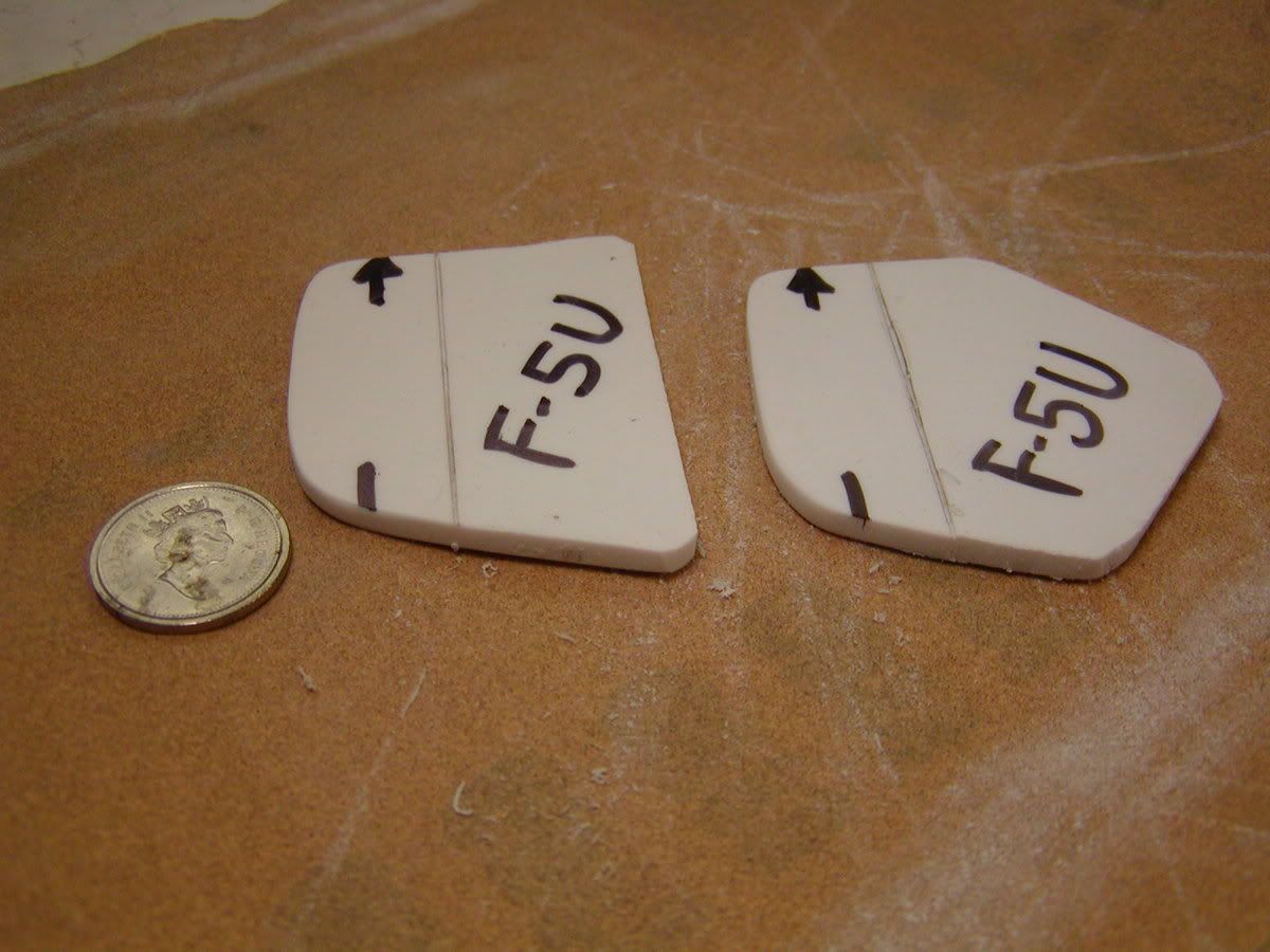

Check out how thick the initial slab was.  Was going to do it with two, thinner sheets sandwiched together but the glued edge always gets messed up once you sand down to the final knife-edge, even if you let the sheets dry for two weeks.
So, giant slab it is (to match the thickness of the cut wing edges on the kit.  I have a dime there for scale reference:
You can see just how coarse the first sandpaper is.  Only took about 20 minutes to reduce the slab to the first semblance of an airfoil shape.  Look at it compared with the initial chunk of plastic:

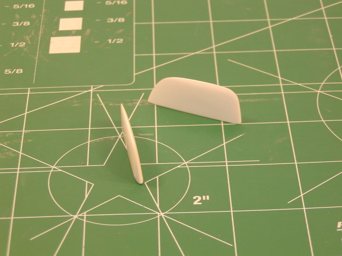

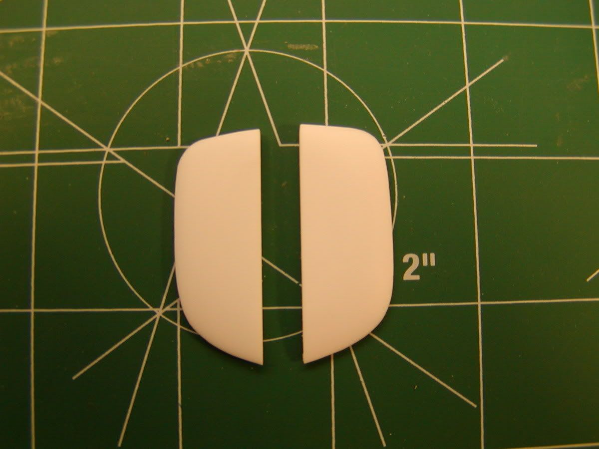

Here, the additional sheet material that I had used as a hand-hold has been removed and the pieces are cleaned up and wet-polished, ready to be attached to the open gaps on the model's cut-off wings:

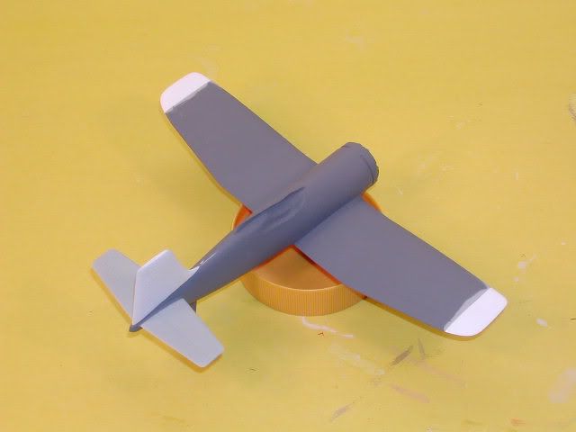

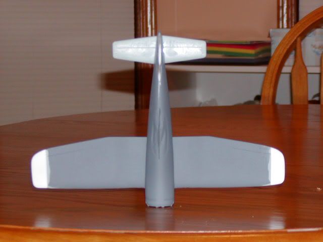

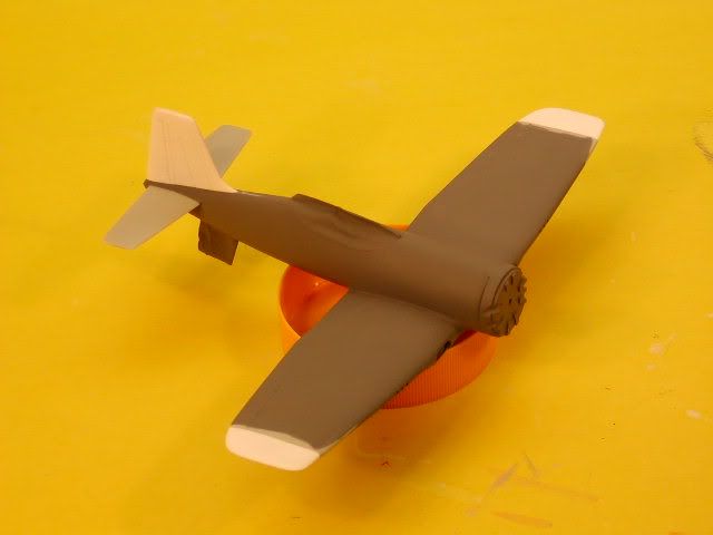

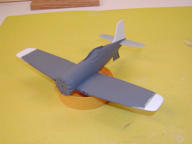

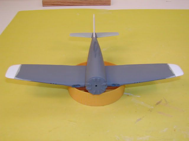

Got some real good progress today:
Scratchbuilt wingtips/tailfin and the horizontal stabilizers (modified from the kit's) are all in place tonight.
And, for once (very rare), I can honestly say the actual model looks BETTER than these photos!
