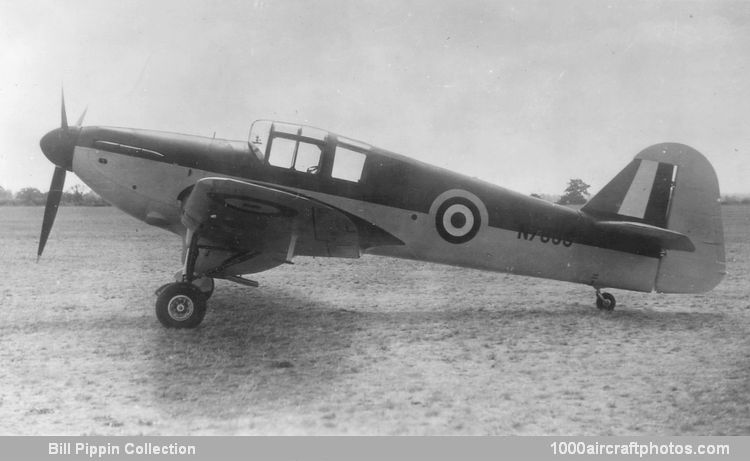

I know they came up with the M.20, but I had in mind something based on the Master, but with a single seat, 4-6 Brownings and perhaps a Taurus engine? (Not everyone's favourite, but not much bigger than the Mercury, although an extra 300 pounds) Maybe something like this...
There was the Kestrel powered M.24 Master Fighter.
http://www.airwar.ru/enc/other2/m24.html
Emergency single-seat fighter converted from M.9A Master Mk.I. Part of the rear cockpit
glazing and the rear seat were removed. Six 0.303 in (7.7 mm) machine guns were mounted
in the wings and a gunsight was installed. This conversion was applied to 23 aircraft, however
none were operationally used.

That "photo" has a dash of Corsair in it to my mind - nice one  :thumbsup:
With a different looking cockpit that M.24 would look very neat. Can see it in FAA service
A Firefly cockpit/canopy might be the go;
