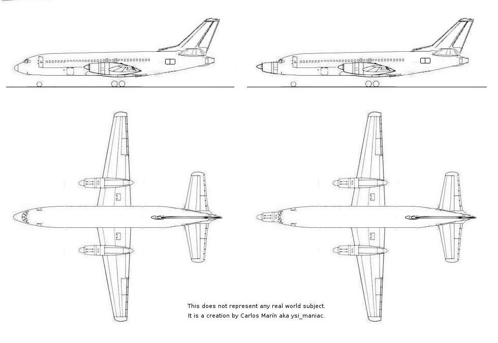

I was really stumped about what to make for this GB when I stumbled upon the Antonov An-50. It was meant to be a jet derivative of the An-24 with four Al-25 engines replacing the two turboprops.
I'll be using Amodels An-24 as the base and 3D printing new engines and pylons.
Hopefully it will look something like this when its done.
1:72 Antonov An-50 by Jason Alles, on Flickr
